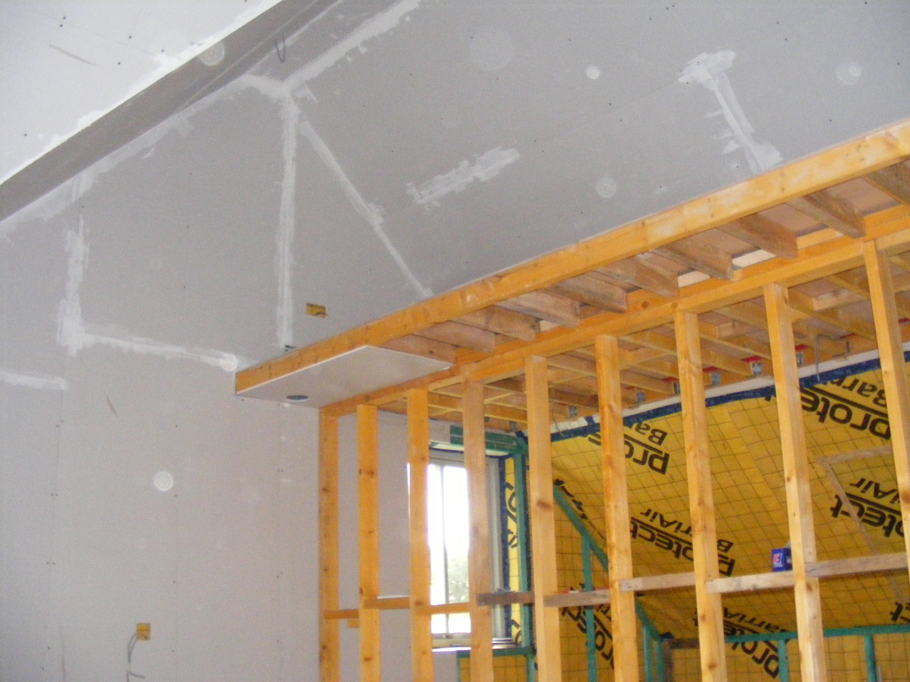

ProDave Posted August 18, 2017 Share Posted August 18, 2017 Go and have a look at my blog, link at the bottom of the post. Some of the early entries are not there as I had to move the blog and haven't got round to reloading the early entries, but there are plenty of photos. Once you have a warm roof supported by a ridge beam, you can do what you like with the roof space. The largest bedroom (for our daughter) has the ceiling left open right to the ridge and the mezanine. The landing and bathrooms have a normal 2.4 metre ceiling and a loft space above them. The master bedroom gets a 3 metre ceiling and a smaller loft space above it. In our case it was a Kurto (sp?) bean used for the ridge which gives the same strength in a smaller size than say a GluLam beam. Steel can also be used. The MVHR ducting runs through the loft spaces. For the room with the vaulted ceiling, the mvhr ducts run around the edge of the mezanine where they will be boxed in. EDIT: Here's a picture of that room with the full height ceiling and mezanine. This one is not on the blog yet as it's still work in progress. Link to comment Share on other sites More sharing options...
Thedreamer Posted August 18, 2017 Author Share Posted August 18, 2017 Thanks JSHarris and Pro Dave, I'll have a good scroll through your blogs. I find the blogs to be a great way to see a breakdown of a self build. I hope to start a blog soon for my own build. Just seen the mezanine floor on your house Dave, looks good and I would imagine it will be a great place for kids to play. Cheers Kerry Link to comment Share on other sites More sharing options...
