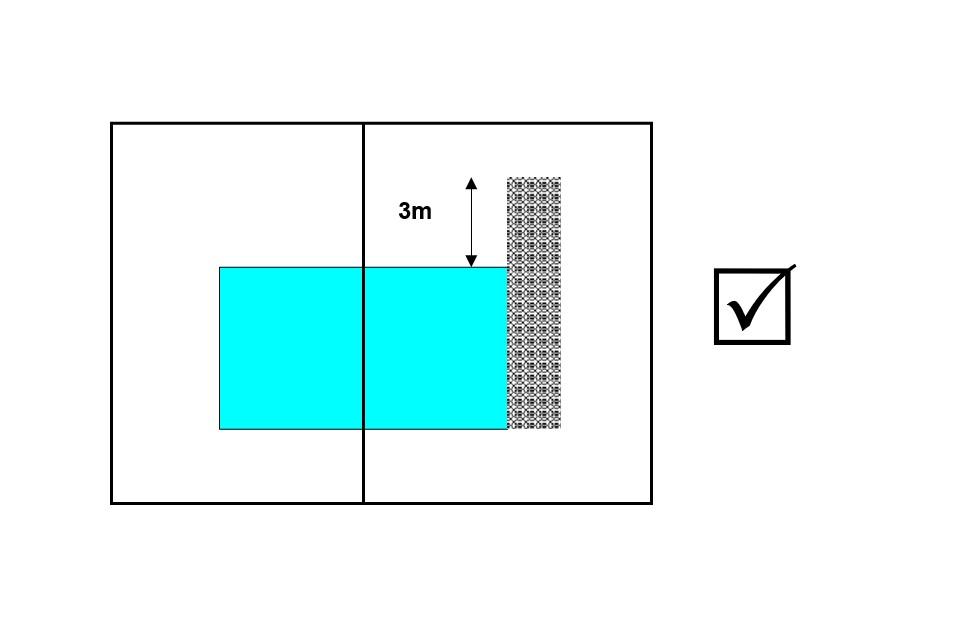

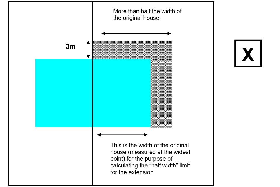

Temp Posted July 4, 2023 Posted July 4, 2023 (edited) This is permitted development in a Conservation area. Provided it meets the height rules and is more than 7m from rear boundary. On a wrap around I think it's PD provided it's not more than half the width of the original house. So you can't wrap it all the way around like this. A partial wrap is possible I believe. Edited July 4, 2023 by Temp
NCXo82ike Posted July 4, 2023 Author Posted July 4, 2023 Thanks @Temp that's clarified it. I had assumed it all came under rear extension given that it's within the existing with of the house. But interesting to note your first example- that does show that a 3m high 10m long wall could theoretically fall under permitted development. Can you share the source for those illustrations please?
Temp Posted July 4, 2023 Posted July 4, 2023 They are from the tech guide here.. https://www.gov.uk/government/publications/permitted-development-rights-for-householders-technical-guidance If you see references to "Article 2(3) land" that means conservation areas, national parks and AONB .
Temp Posted July 4, 2023 Posted July 4, 2023 9 minutes ago, NCXo82ike said: But interesting to note your first example- that does show that a 3m high 10m long wall could theoretically fall under permitted development. Yes 3m is OK.. Quote Where any part of a proposed extension to a house is within 2 metres of the boundary of its curtilage, then the maximum height of the eaves that is allowed for the proposal is 3 metres. Under paragraph (ja) if the proposed extension is within these limitations, but is being joined to a previous enlargement which exceeds these limitations, it will not be permitted development. Guidance on measurement of height of eaves is covered under paragraph (d) above.
