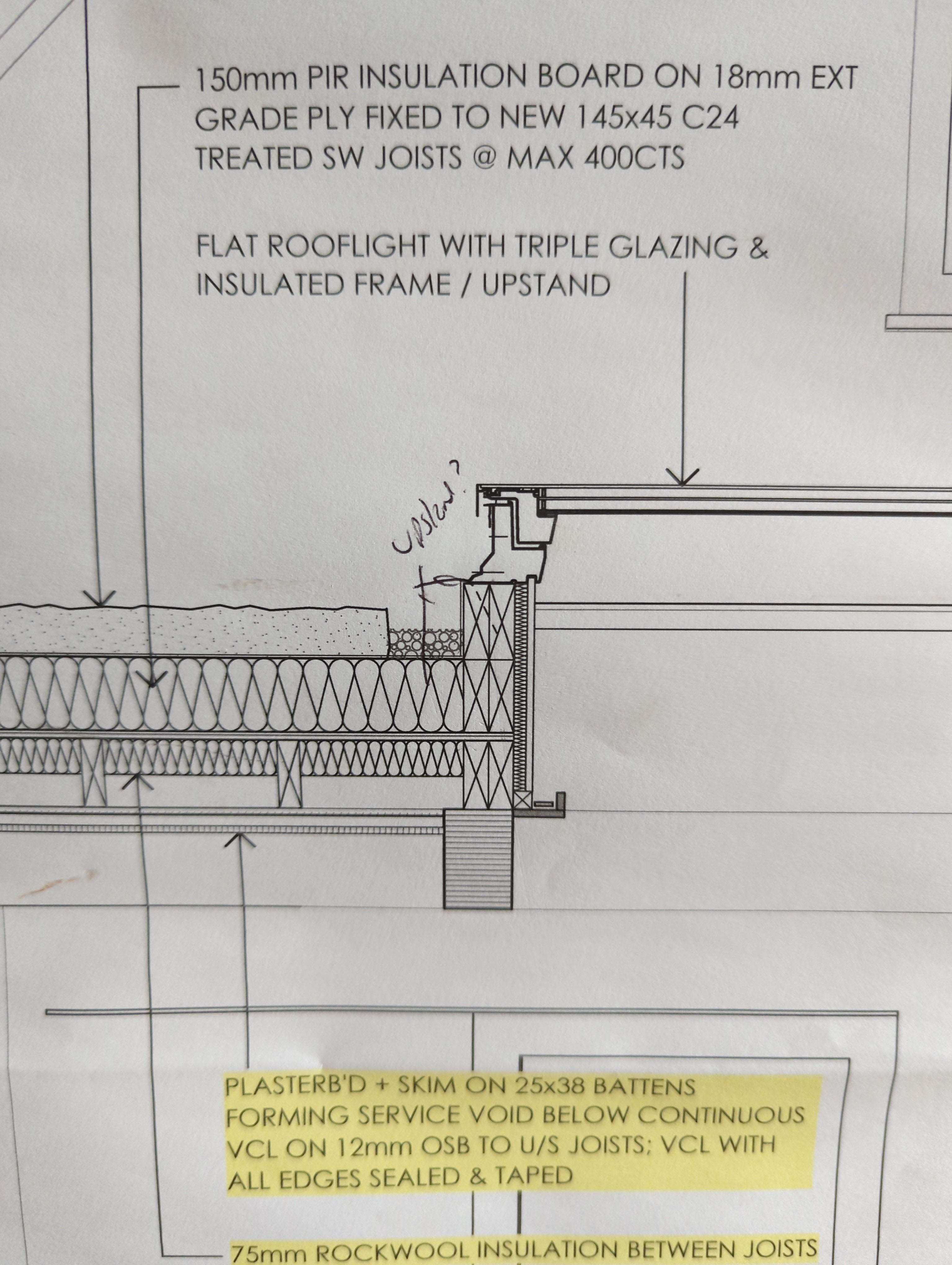

goodbyegti Posted August 1, 2023 Share Posted August 1, 2023 On 03/07/2023 at 21:10, bmj1 said: Or could I apply the VCL from underneath the joists? A bit more work, but feasible ?! That's actually what our architect has specified for our warm roof. On top of the OSB deck we have 150mm PIR, then a loose fill between the joists underneath with mineral wool. The joists are boarded over on the underside with 18mm OSB, then a VCL, then battens to form a service void, then plasterboard. Link to comment Share on other sites More sharing options...

bmj1 Posted August 1, 2023 Author Share Posted August 1, 2023 7 hours ago, goodbyegti said: And all the wiring and downlights is below the VCL? Link to comment Share on other sites More sharing options...
goodbyegti Posted August 10, 2023 Share Posted August 10, 2023 Correct, all wiring below VCL. Not much room. You can see the void in the diagram. Link to comment Share on other sites More sharing options...
saveasteading Posted August 10, 2023 Share Posted August 10, 2023 3 hours ago, goodbyegti said: You can see the void in the diagram. so if it gets damp there, it will show on the ceiling. the top surface of the roof is not labelled on your drawing. If that is an internal gutter I'd be more concerned about that. Link to comment Share on other sites More sharing options...
goodbyegti Posted September 25, 2023 Share Posted September 25, 2023 On 10/08/2023 at 23:13, saveasteading said: so if it gets damp there, it will show on the ceiling. Why would it get damp there? It's below the insulation and 'warm'. Link to comment Share on other sites More sharing options...
saveasteading Posted September 25, 2023 Share Posted September 25, 2023 On 10/08/2023 at 23:13, saveasteading said: If that is an internal gutter I'd be more concerned about that. On 03/07/2023 at 18:57, bmj1 said: Any thoughts on some kind of moisture meter I could install, These are my points. 1. Don't bother with a meter, a wet ceiling would show soon enough. 2. internal gutters and downpipes are high risk. Link to comment Share on other sites More sharing options...
