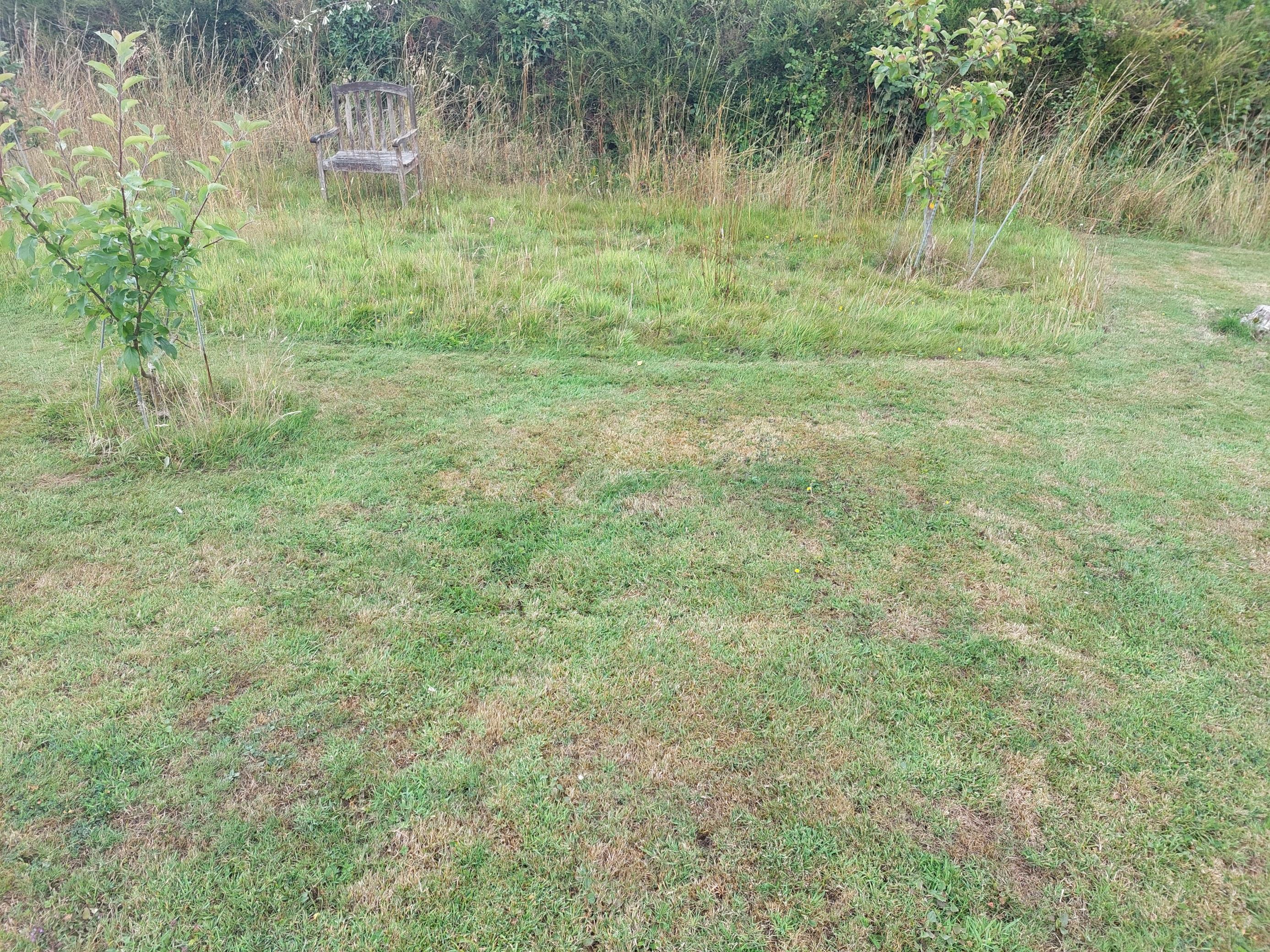

saveasteading Posted July 24, 2023 Posted July 24, 2023 23 minutes ago, puntloos said: For a kid, some grass would be nice The green bit gets mown, and the cuttings left where they fall, and is fine for kids. Doesn't need watering or weeding. In fact they prefer to see the daises, buttercups and clover, and the insects.
puntloos Posted July 24, 2023 Author Posted July 24, 2023 18 minutes ago, saveasteading said: The green bit gets mown, and the cuttings left where they fall, and is fine for kids. Doesn't need watering or weeding. In fact they prefer to see the daises, buttercups and clover, and the insects. Can you send us a picture on how this looks? - my wife has certain ideas on how 'elegant' a garden should look..

saveasteading Posted July 25, 2023 Posted July 25, 2023 On 24/07/2023 at 12:17, puntloos said: Can you send us a picture on how this looks? - my wife has certain ideas on how 'elegant' a garden should look.. A selective shot, not the best view but one that omits personalisation/ neighbours etc The grass was cut 2 days ago. The dips are from ancient drainage ( it dries out quickly) The wild bit is new. It was simply allowed to grow. The only planting was some yellow rattle seeds and the apple trees , so it is not established. I cut it once a year and rake the cuttings off.
