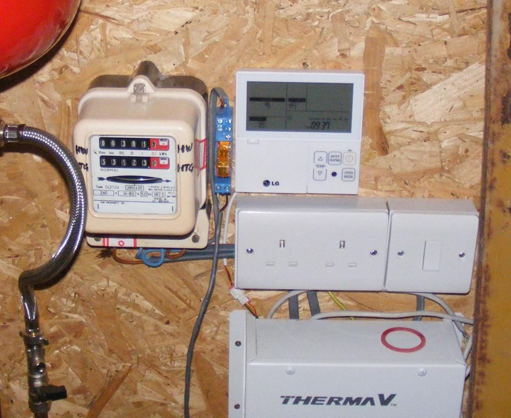

ProDave Posted July 2, 2023 Share Posted July 2, 2023 Do you have a grey metal box like the one partly shown in the bottom right of this picture? Sorry that's the only photo I have, Ignore everything except the metal box with Therma V on it, do you have anything like that? It might be near your water tank, it might be near the control panel, or in reality it could be just about anywhere else? If you have one of those then that is the box that allows the ASHP to control the immersion heater in the hot water tank when it needs to heat to a hotter temperature. If you have one, then listen to it carefully when it tries to demand very hot water, you should hear it go clonk quite loud as it energises the contactor, and then while on, it will hum probably quite quetly, you might need to put your ear to it to see if it is humming. Link to comment Share on other sites More sharing options...
Patrick C Posted July 10, 2023 Author Share Posted July 10, 2023 Hello, right ok. Sorry for slow reply, have had a lot on and not got back to this issue until now. Yes we have a box similar to that, and I'm familiar with the loud clonk and the buzzing. It's still doing clonks and buzzing when very hot water is called for, but the water is not heating up. This leads me to think the immersion rod has stopped working. This would seem a bit strange mind you, as the original one stopped working after a few years and we had it replaced last year, so it's still fairly new. I wonder if you know how I could get the system to heat the water using the heater in the heat pump, until we can get the immersion rod checked out/changed. Link to comment Share on other sites More sharing options...

ReedRichards Posted July 10, 2023 Share Posted July 10, 2023 (edited) 3 hours ago, Patrick C said: I wonder if you know how I could get the system to heat the water using the heater in the heat pump, until we can get the immersion rod checked out/changed. I have an LG Therma V with a newer (contemporary) controller but a box like the one in the picture. The box allows the heat pump to control the immersion heat but it is only used if I request the DHW to be hotter than 50 C. Since my target temperature is 50 C this only happens during the weekly Legionella cycle. My heat pump does not use an internal immersion-type heater, I'm not sure if it's not connected or not there. So when you ask about the heater in the heat pump I assume you want this to make the water in your tank hotter than 50 C, which the heat pump can achieve by itself without the need for supplementary heating. Edited July 10, 2023 by ReedRichards Link to comment Share on other sites More sharing options...
