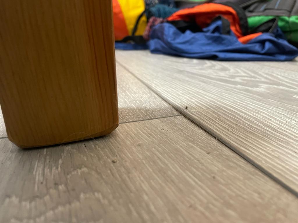

Issy Burke Posted June 28, 2023 Share Posted June 28, 2023 Hi all, I have installed underfloor heating in 3 rooms in my flat so far. I opted to use 5mm Sonic Gold Underlay, but am experiencing an issue and am curious to know whether anyone else has experienced this. In effect the underlay is so soft, that it is warping some of my laminate. The floor itself is effectively concrete, with noggins and a tongue and groove chipboard on-top (plenty of foam so lots of insulation in there which is a plus). However the lazy builders of the 90's did not bother to level the floor at all, and pinned it to noggins, resulting in a pretty uneven chipboard floor, we suspect the concrete beams are also not level and seem to sort of rise at either end of the building. Yes, in the ideal world you might rip it all out and start again - sure. However, I needed a heating solution and hoped that decent underlay would deal with this to some degree..... I opted for the 5mm sonic gold, in part because I had some to hand, but it also came pretty highly rated for UF heating/laminate etc. However, I have found that heavy furniture (wardrobe / bed) is causing the laminate to warp, i.e. sink. The positives of Sonic Gold that I can report, is that it is definitely soft underfoot, definitely very effective at insulating (it literally takes minutes to notice that the electric floor is on) and the room heats up very effectively and quickly. The downside is - that I think the softness of the underlay is unfortunately not brilliant unless your floor is 99.9% level and presumably your laminate is of german engineering quality and can withstand a degree unequal loading without any sink or split... I just wanted to know if anyone else has used this underlay, experienced similar issues - and before I do floor number 4 (the living room) - I would just like to check in and see whether I should be using a different underlay? Or if anyone has any recommendations I guess? In time I may look to re-do the floors, but its a pretty big job to rip it all out again as you can imagine. As I said, the Sonic Gold is definitely very soft, quiet and insulating - but equally its soft and doesn't seem to be brilliant when exposed to unequal loading - and yes, I hear you - this is because of my floor - but at the time screeing the whole floor was not on the cards!!! Thanks! p.s. sorry floor looks so dirty!! ha Link to comment Share on other sites More sharing options...
saveasteading Posted June 28, 2023 Share Posted June 28, 2023 The t and g of the laminate doesn't seem to be spreading the load far enough . Can you place furniture leg cups under the feet? As an immediate remedy, any piece of timber say 15cm x 10cm or more will possibly sort it. Especially if if sits on more than one floor plank. Link to comment Share on other sites More sharing options...
Issy Burke Posted June 28, 2023 Author Share Posted June 28, 2023 (edited) I agree, its a Wickes Laminate - in theory it should be better then this. This isn't even close to the worst of it.... In one area a wardrobe with quite a large supporting base I might add (not little feet) has split the tongue and groove about 20cm along its length - this section will need full remedial work. Interestingly the bathroom has a higher quality laminate in it (due to waterproofing requirement), same UF electric heating installed and despite the uneven floor issue - it doesn't seem to be reacting in the same way - it's just more stable. Me and my tradeperson friend/neighbour, did not anticipate that the floor was unlevel enough in this case to cause this problem. I think other people must experience the same issue using soft underlays.... hence me thinking I might use a harder foam underlay for the living room, due to the amount of heavy furniture that you tend to have. There isn't really alot of info out there on installation of UFH with laminate, neither problem solving - even though I have to say, it really works amazingly well and efficiently. Totally recommend it, albiet with a slightly denser underlay... I have had it installed for 2 years so far. Edited June 28, 2023 by Issy Burke Link to comment Share on other sites More sharing options...

ProDave Posted June 29, 2023 Share Posted June 29, 2023 I think the issue in not the use of a particular underlay, but the use of a particularly thing particularly weak laminate flooring. I am not a fan of laminate flooring, preferring proper engineered wood flooring, but I have used a good laminate in our sun room without such issues. the tongue and groove joint in yours appears too weak to be fit for purpose. 1 Link to comment Share on other sites More sharing options...
