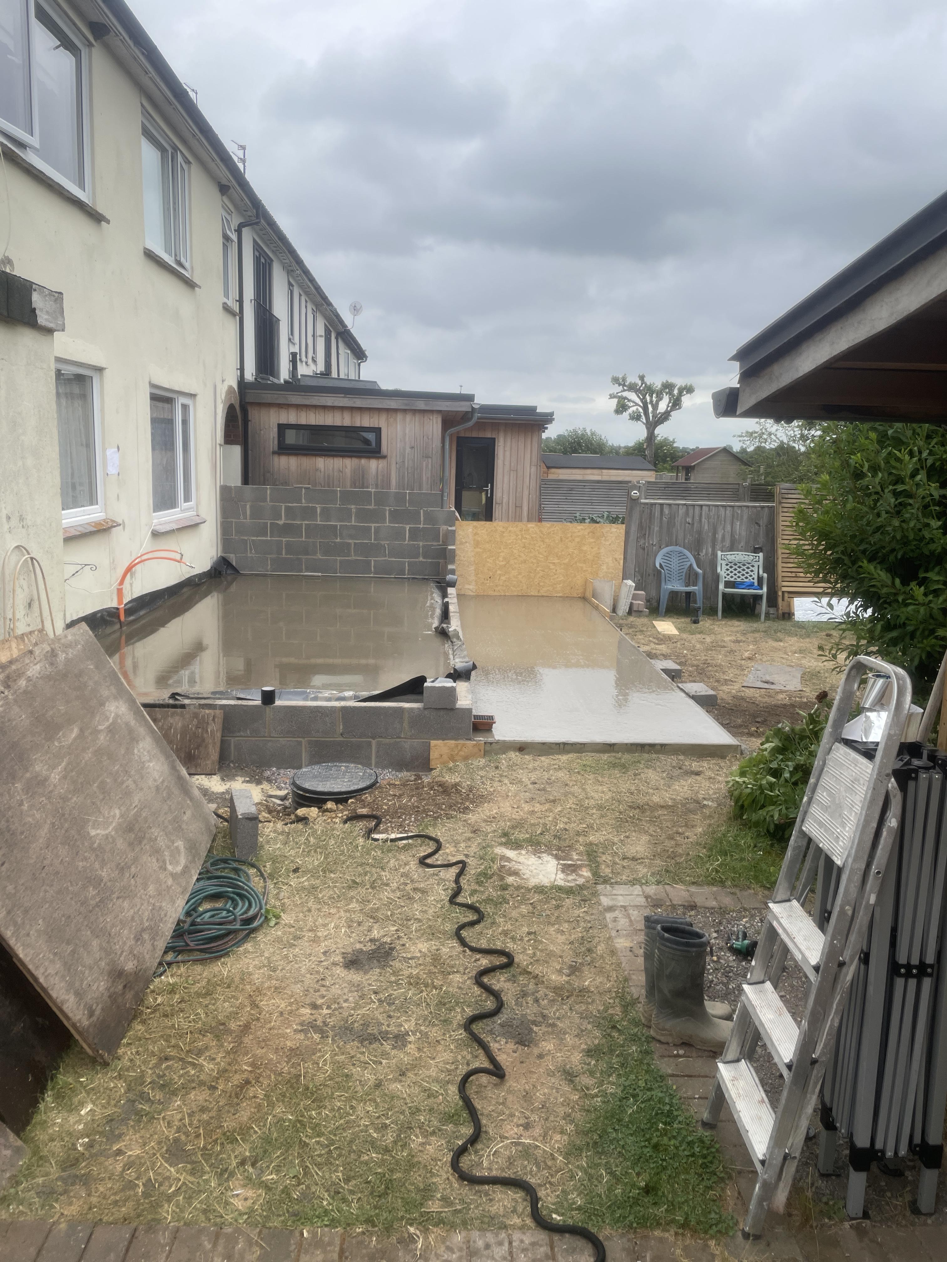

HughF Posted August 29, 2023 Posted August 29, 2023 55 minutes ago, Dave Jones said: only issue will be it wont be flat enough to put a floor on no matter how much you float it. Screed is. Nothing a bit of self leveller won't fix... To be honest, this is flatter than the kitchen slab and that's got vinyl on it just fine. 1

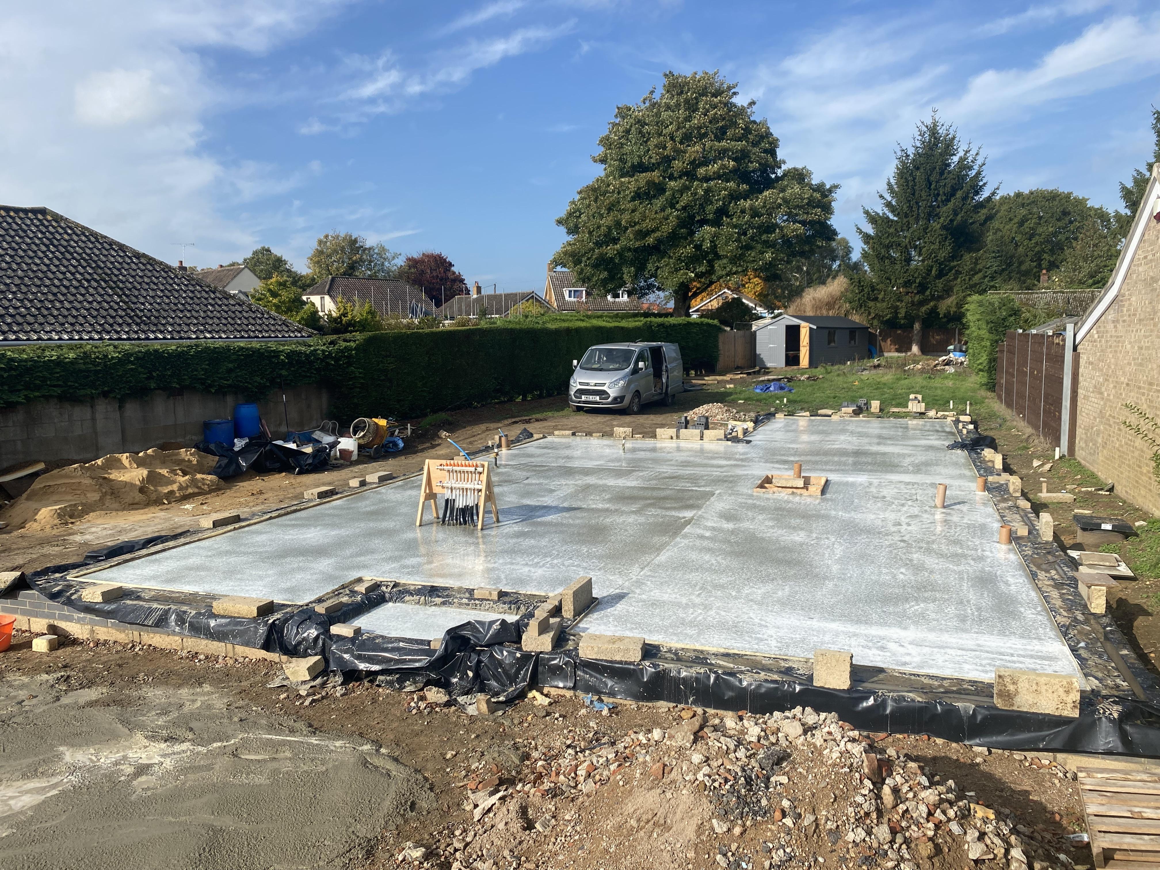

HughF Posted September 3, 2023 Posted September 3, 2023 10 hours ago, LiamJones said: What did you use? Concrete, straight off the readymix truck. I think it was 10mm down rather than the 20mm down we used for footings
HughF Posted September 3, 2023 Posted September 3, 2023 Best photo I have, but you can see it went down nice and flat.
