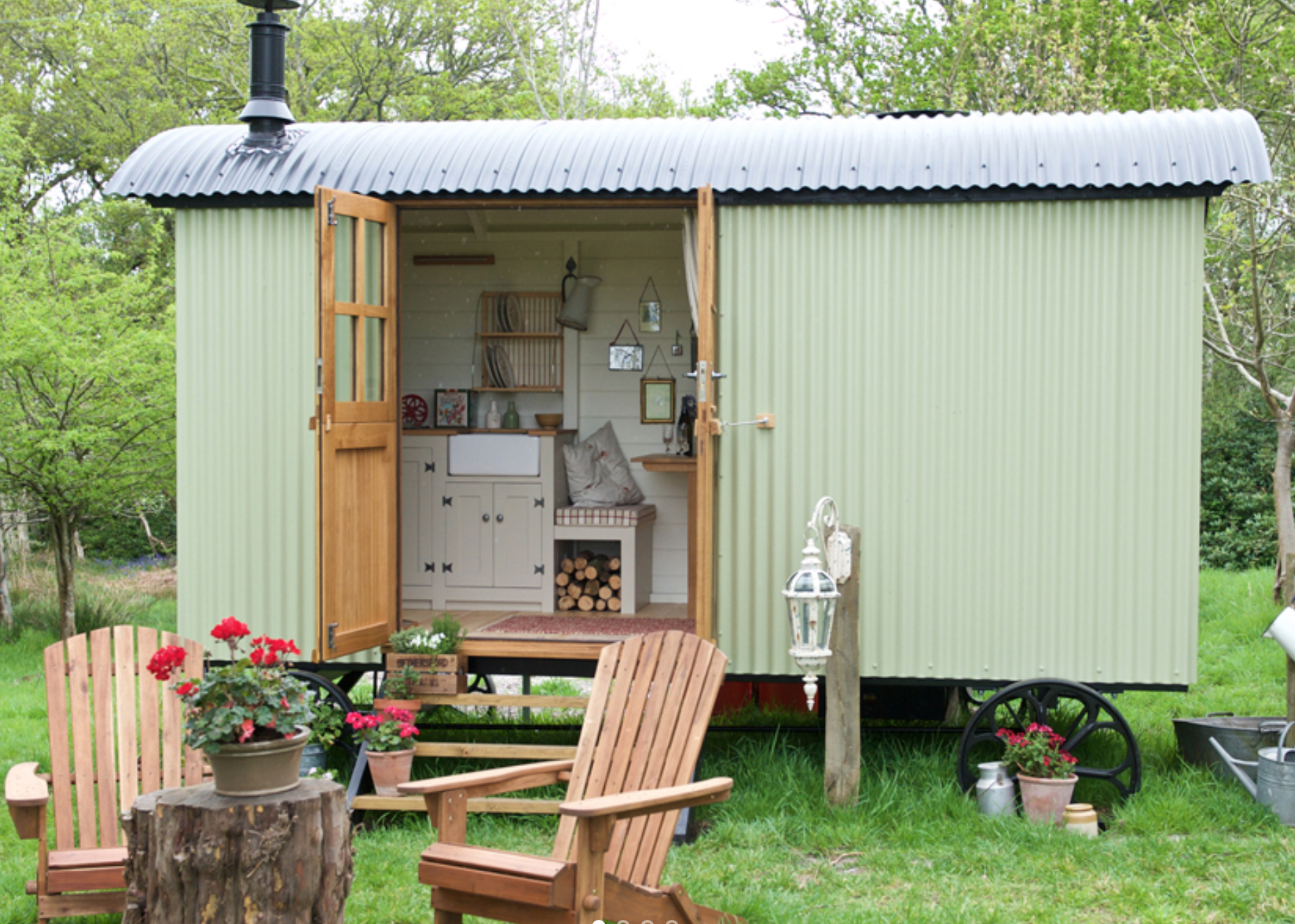

Grian Posted June 19, 2023 Share Posted June 19, 2023 Advice please! It seems tin is pretty hard to handle? I need to cut it, and bend it around corners to clad a shepherd's hut (don't want to use right-angled profile pieces, going for a heritage appearance). We cut some with a grinder at the weekend and the edge was hairy and spiky and hazardous, not encouraging. Then watched some YouTubes and saw someone using a Miquita nibbler, this looked a lot better. Quite an expensive bit of kit for our relatively small job, but if it makes life easier then so be it. I also need a non-standard colour of tin and it seems that painting it myself is the most feasible route as I can't find anywhere to get it powder coated in Scotland, or near where we are buying other hut materials in Yorkshire. Any tips? I think plain galvanised, degrease it, then paint - but someone told me that the shiny grey reverse of a standard colour coated tin sheet works as an undercoat, I have my doubts, can anyone confirm? Alternatively we could use timber, but it seems a lot more costly. I'll ask a separate question on that matter. Hopefully stop going round in circles!! Link to comment Share on other sites More sharing options...
Iceverge Posted June 19, 2023 Share Posted June 19, 2023 You can cut a start with a snibs or similar. Just a few cm. Then if you're feeling burly literally rip the metal in half. Didn't believe it could be done until I tried it. It won't leave a nice edge however. A nibbler is the way forward. Angle grinders work but the sparks leave lots of rust spots on the metal and the edge is jagged. For the shear pleasure of work I would opt for timber as flashing nicely around corners etc with metal is very time consuming. Another option might be Onduline but it will be weaker than metal. 1 Link to comment Share on other sites More sharing options...
Grian Posted June 19, 2023 Author Share Posted June 19, 2023 Thank you. Even feeling really burly I suspect my lady-arms would fail to rip metal, obviously I am going to try though!! Exactly my concern, re corners and the like. Everything is pointing toward timber - though the price may not. Onduline, interesting, might get samples... Link to comment Share on other sites More sharing options...
