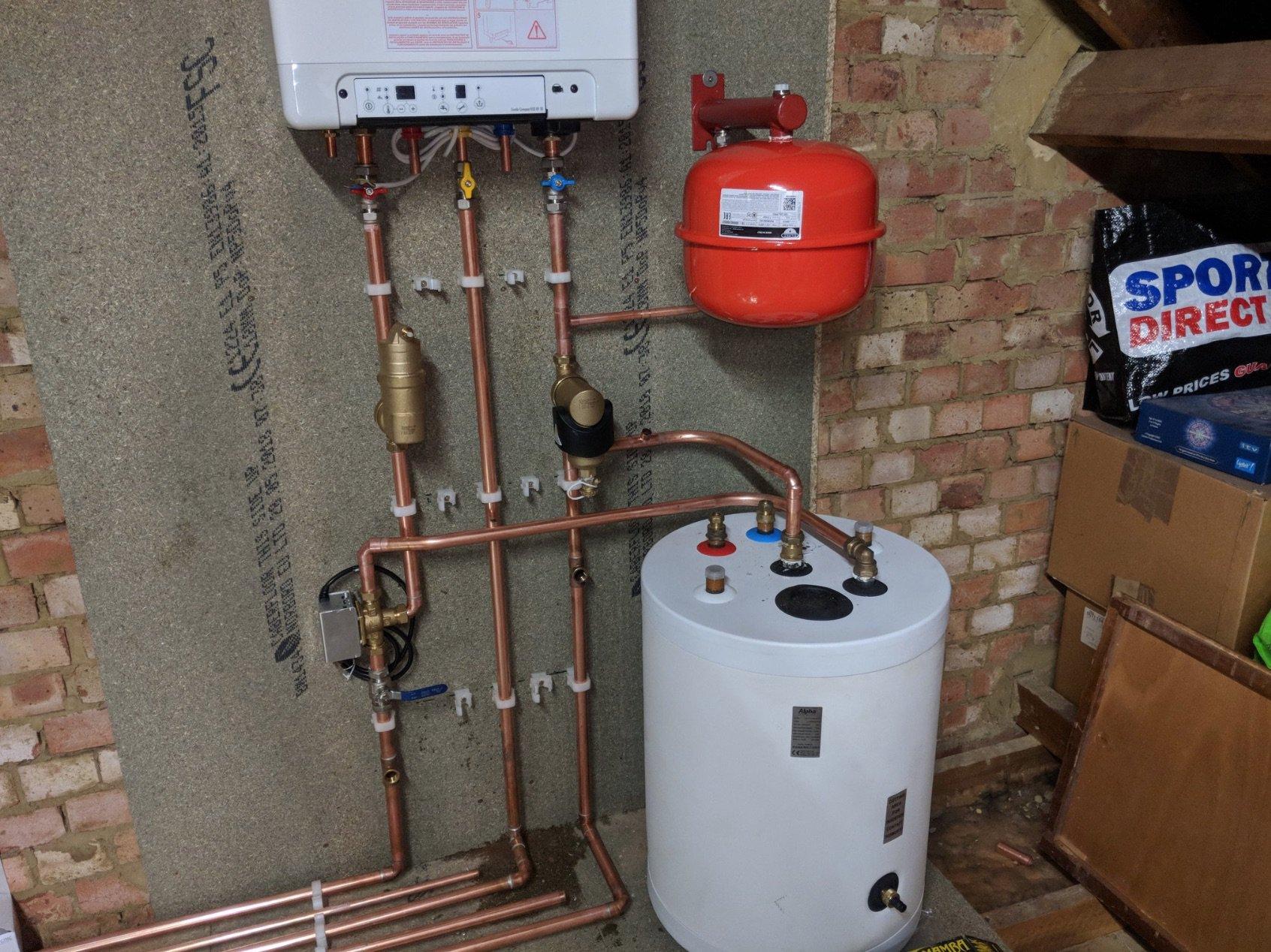

JohnMo Posted June 12, 2023 Share Posted June 12, 2023 2.5kW of PV will not heat a big cylinder much, so you may be better going small say 50L. Alpha boilers do a cylinder set up out the box for this. An Alpha Superflow 50 and 25. You just need to add a 230v 1-1/4" immersion and your diverter. Some bedtime reading and images Combi-SuperFlow-White-Paper-v1-2-4.pdfCanetis-SuperFlow-Product-Sheet-WE-050318.pdf FlowSmart Inst & Serv Inst 17-6-08.pdf Link to comment Share on other sites More sharing options...

dave1967 Posted June 13, 2023 Author Share Posted June 13, 2023 Viessmann say preheating pre boiler is a no so need a new plan. I am not sure of the benefits of having an unvented tank after the boiler. Link to comment Share on other sites More sharing options...
JohnMo Posted June 13, 2023 Share Posted June 13, 2023 Have you read the alpha boilers document? They only allow water at 30 degs to go to the boiler via a mixer valve. Now think about a hot summers day, water at well over 20 can enter the boiler with no ill effects. Your heating system water does the same. Just use a mixer valve to control the temp to sensible limit. So you save and also get an uplift in DHW performance all year round. Link to comment Share on other sites More sharing options...
Nickfromwales Posted June 13, 2023 Share Posted June 13, 2023 31 minutes ago, dave1967 said: Viessmann say preheating pre boiler is a no so need a new plan. I am not sure of the benefits of having an unvented tank after the boiler. OK. You can turn the existing combi into a system boiler by adding 2-port zone valves to the CH output of the boiler. One goes to space heating (CH) and the other would heat an UVC. The DHW output of the combi would just get redirected to the least / shortest run outlet in the house, cloakroom WC for eg, and then the rest of the house comes off the UVC. Then you'll have much better showers, and somewhere to dump your solar excess. Probably a 150L to 180L cylinder would suffice, as gas re-heats an UVC PDQ Link to comment Share on other sites More sharing options...
Nickfromwales Posted June 13, 2023 Share Posted June 13, 2023 3 minutes ago, JohnMo said: Have you read the alpha boilers document? They only allow water at 30 degs to go to the boiler via a mixer valve. Now think about a hot summers day, water at well over 20 can enter the boiler with no ill effects. Your heating system water does the same. Just use a mixer valve to control the temp to sensible limit. So you save and also get an uplift in DHW performance all year round. If the combi was a retro fit then there may be a 22mm hot pipe there to tag the UVC on, and do as I just suggested above. The Caleffi valve does what you state, but it's a few hundred pounds. I used to fit them to the Sunamps / Therminos so they could pre-heat any combi. Some manufacturers capped incoming temp at 25oC, others 30oC, and some just stated chuck in what you like! The downside to tempering at that low a temp is that you get very little reward from what will be a 4-figure upheaval. Going to a system boiler config and taking the water from the UVC > outlets will give the highest rewards for the lowest outlay. You can get most sizes with dual immersion, but the smaller you go the more likelihood there could only be 1x installed due to space limitations inside the vessel. At 210 - 250L I think dual immersion will be fine. Ask Trevor at cylinders2go and mention my username and the forum and he will look after you with a good price on the cylinder. Link to comment Share on other sites More sharing options...
