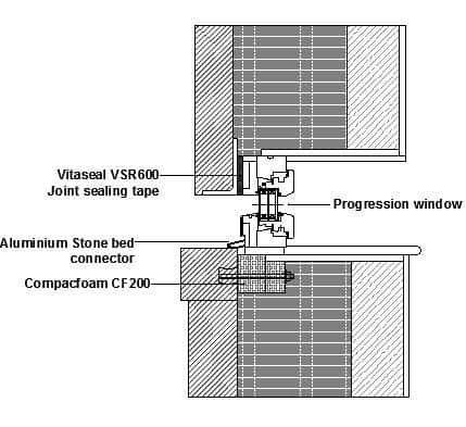

Iceverge Posted June 10, 2023 Share Posted June 10, 2023 8 hours ago, JackofAll said: Re. metal bracket, that's why I was suggesting a plastic one, nylon could also do but would the condensation still be an issue? Should work fine if the nylon is strong enough. Green building store used compacfoam. https://www.greenbuildingstore.co.uk/kirkburton-passivhaus-strategy-for-windows-overheating/ What kind of windows are you using? The worst heat loss in our house is through the window frames. I would have liked to have overinsulated the frames if I could have easily done so. Link to comment Share on other sites More sharing options...
JackofAll Posted June 11, 2023 Author Share Posted June 11, 2023 12 hours ago, JackofAll said: @SteamyTea is this what you mean? Link to comment Share on other sites More sharing options...
JackofAll Posted June 11, 2023 Author Share Posted June 11, 2023 7 hours ago, Iceverge said: Should work fine if the nylon is strong enough. Green building store used compacfoam. https://www.greenbuildingstore.co.uk/kirkburton-passivhaus-strategy-for-windows-overheating/ What kind of windows are you using? The worst heat loss in our house is through the window frames. I would have liked to have overinsulated the frames if I could have easily done so. Thanks @ Iceverge obviously never thought of compacfoam. Will check out price difference between nylon/compacfoam.Using internorm KF410 upvc aluclad. Link to comment Share on other sites More sharing options...
JackofAll Posted June 12, 2023 Author Share Posted June 12, 2023 On 11/06/2023 at 00:56, Iceverge said: Should work fine if the nylon is strong enough. Green building store used compacfoam. https://www.greenbuildingstore.co.uk/kirkburton-passivhaus-strategy-for-windows-overheating/ What kind of windows are you using? The worst heat loss in our house is through the window frames. I would have liked to have overinsulated the frames if I could have easily done so. @Iceverge just noticed the ply box header does not span the full distance of the cavity,cavider why? Also am I correct in saying that there's a gap between the stone bed connector and the face of the window? Unsure why the didn't use joint sealing tape in same gap. Link to comment Share on other sites More sharing options...
Iceverge Posted June 12, 2023 Share Posted June 12, 2023 48 minutes ago, JackofAll said: just noticed the ply box header does not span the full distance of the cavity,cavider why? Defo not. The outside leaf will be cold and possibly wet for much of the year. Any ply here wouldn't last the battle. I'm not sure about the gap there. 1 Link to comment Share on other sites More sharing options...
