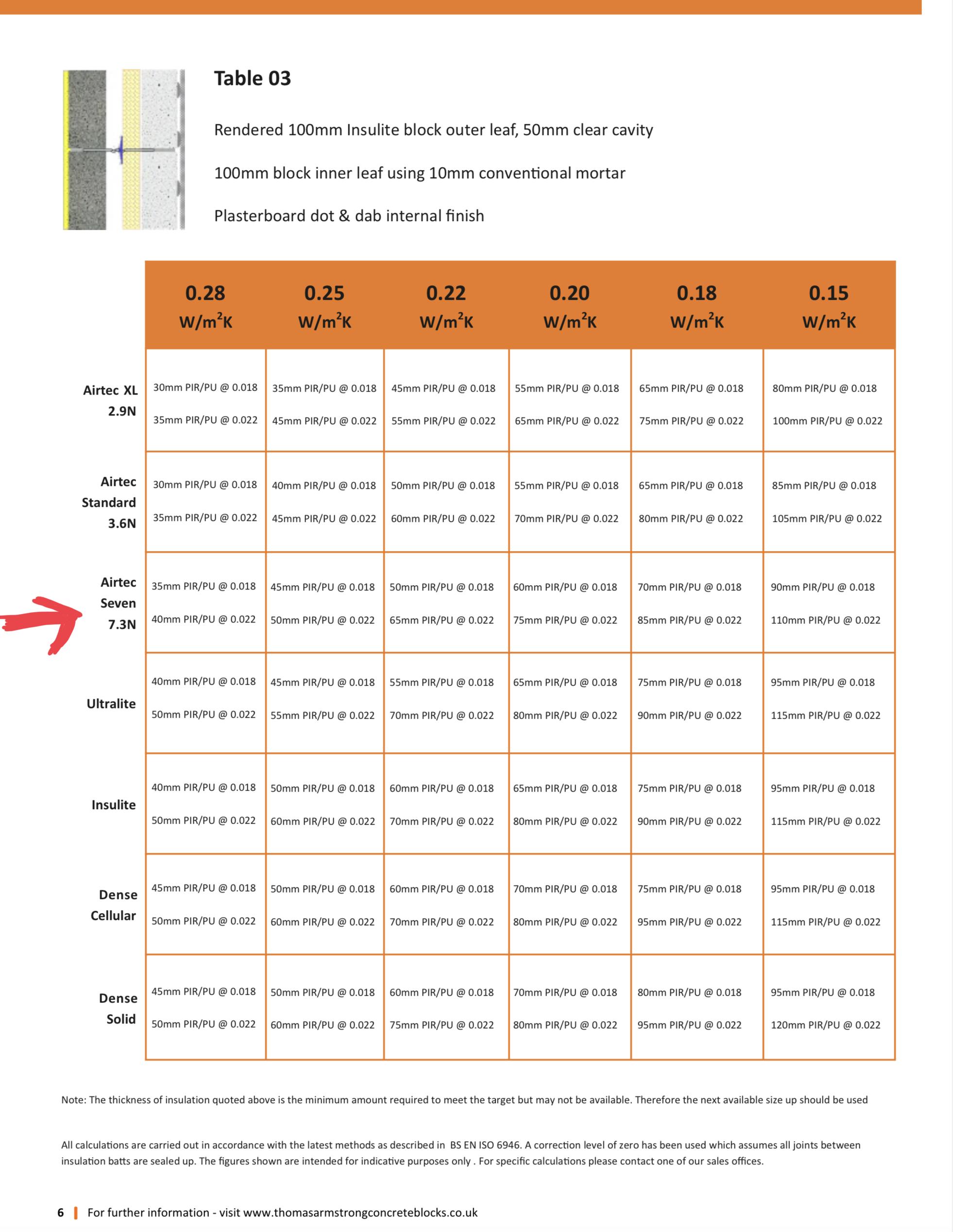

Carrerahill Posted June 8, 2023 Share Posted June 8, 2023 (edited) The makeup will be 0.18 - the block on its own is not as good as that. If you can, use thermalite blocks on the inner, that will help too. 100mm con block, 50mm cavity, 50mm PIR, 100mm thermalite block gave us the requirement on a recent build (signed off last month) and we are in Scotland with more onerous targets to hit. I realise the whole thing is in connection with the floor and ceiling, but nothing we had was too bad to comply. Edited June 8, 2023 by Carrerahill Link to comment Share on other sites More sharing options...
Sophiae Posted June 8, 2023 Author Share Posted June 8, 2023 34 minutes ago, Carrerahill said: The makeup will be 0.18 - the block on its own is not as good as that. If you can, use thermalite blocks on the inner, that will help too. 100mm con block, 50mm cavity, 50mm PIR, 100mm thermalite block gave us the requirement on a recent build (signed off last month) and we are in Scotland with more onerous targets to hit. I realise the whole thing is in connection with the floor and ceiling, but nothing we had was too bad to comply. Thank you for your response and suggestions. my floor and roof will have 150mm PIR. The builders suggested the 100mm PIR for the walls as they knew I wanted to get below the target 18 for the walls over all. Link to comment Share on other sites More sharing options...

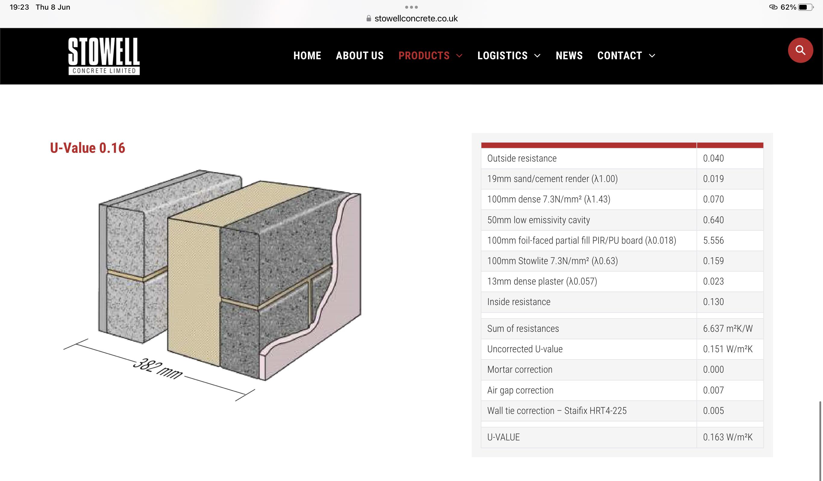

Sophiae Posted June 8, 2023 Author Share Posted June 8, 2023 This is what I am looking at, so if there is any other option as most require about 100mm PIR insulation boards to get below the 0.18. Link to comment Share on other sites More sharing options...

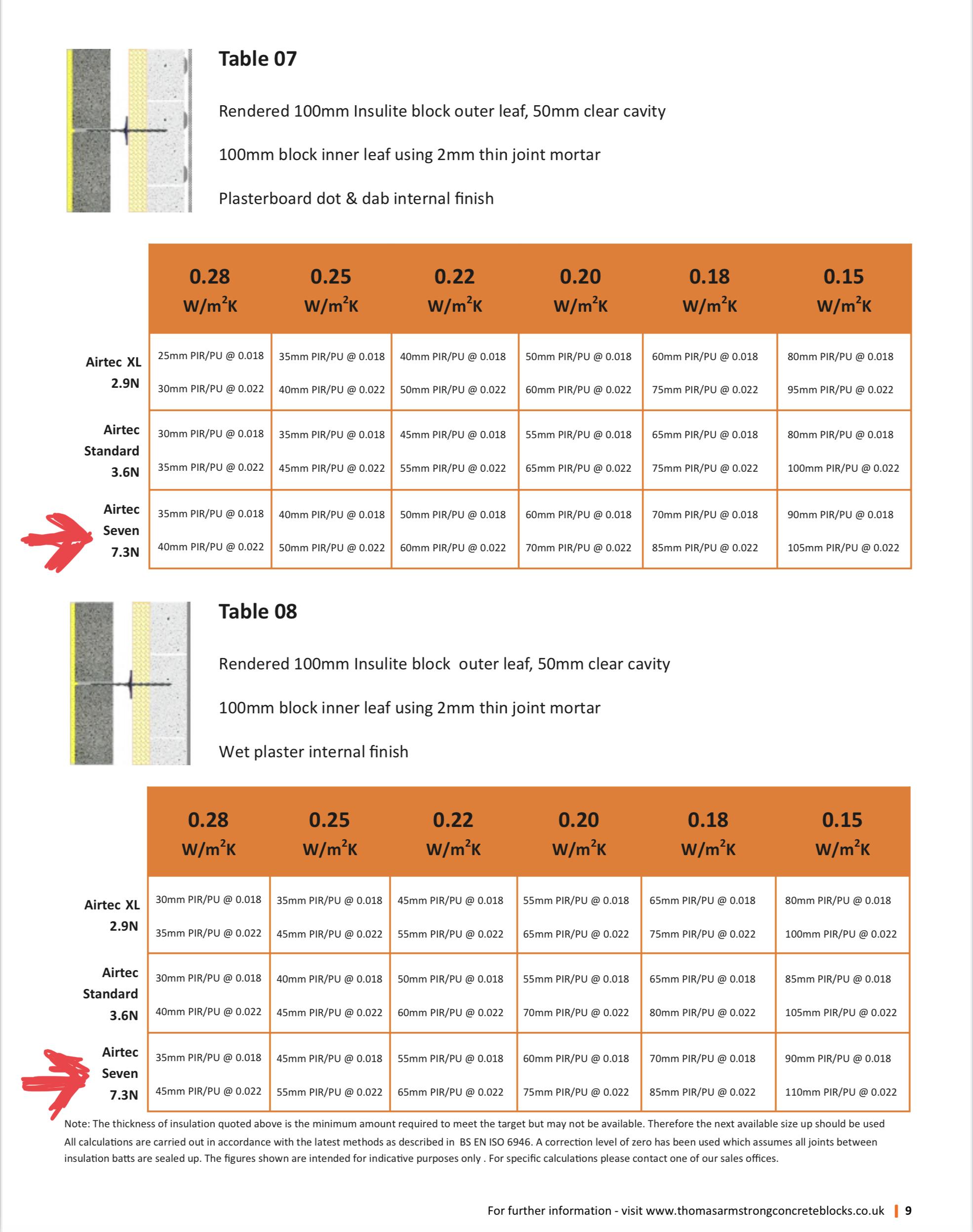

Sophiae Posted June 8, 2023 Author Share Posted June 8, 2023 Here is another one Link to comment Share on other sites More sharing options...

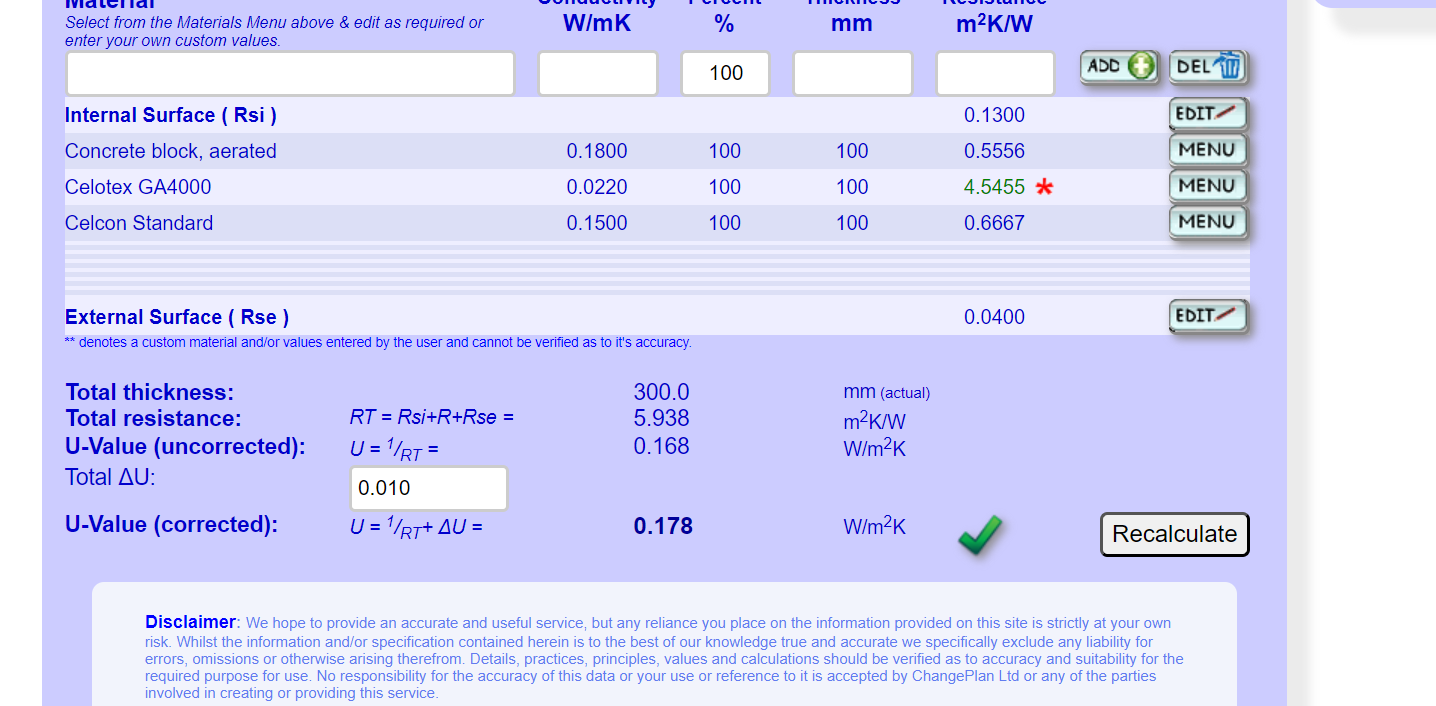

Dave Jones Posted June 8, 2023 Share Posted June 8, 2023 Use the cheap 3.6n lightweight aerated concrete blocks on the inside skin, that will give you a pass with 100mm celotex Link to comment Share on other sites More sharing options...
Sophiae Posted June 9, 2023 Author Share Posted June 9, 2023 Am I ok to use the 3.6N on the inside leaf with a bean sitting on top? I’ll have a look again at the SE’s design. Link to comment Share on other sites More sharing options...
Caversham Passivhaus Posted October 13, 2023 Share Posted October 13, 2023 Also doing a single storey, SE recommended 7.9N/mm2 "a standard strength" - but as we are looking at a single storey section of wall we can reduce, looking at Part A: Structure pg. 24, 2.9N/mm2 blocks are allowed with the best thermal u-values. Link to comment Share on other sites More sharing options...
