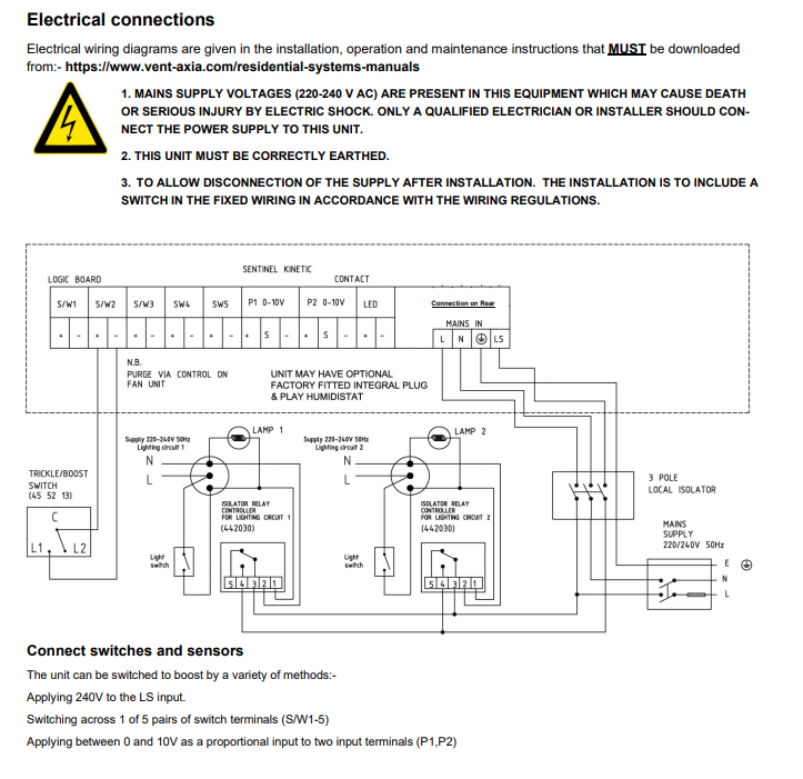

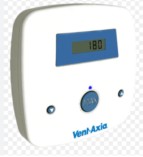

Andehh Posted June 6, 2023 Posted June 6, 2023 We have a Vent Axia MVHR installed, and we have 3 x boost switches for the bathrooms to manually boost if (after your poo!). The MVHR was installed several months ago, and will be commissioned in a few weeks time. The MVHR installer is shrugging off the boost switch connections as he only ever installs the master one which comes with a Rj11 type connector & claims he isn't an electrician. Pisses me off this, but he won't budge. As a result my electrician needs to pick up the slack. However, my electrician is scratching his head a bit on the wiring for it, with the attached diagrams being all that is offered in the manual. Each boost switch needs 4 core cable, which is routed back to the MVHR. However, on the MVHR unit there is only 2 terminals per switch. Can anyone shed any light on this please? Boost switch: https://www.tradesparky.com/ecommerce/downloadasset?productAssetId=571966 Vent Axia Manual: https://www.vent-axia.com/sites/default/files/439817_ad.pdf Thanks!
dpmiller Posted June 6, 2023 Posted June 6, 2023 why do you think you need 4-core to a boost switch? It only needs to be a momentary contact closure.
Andehh Posted June 6, 2023 Author Posted June 6, 2023 (edited) Our installer said we could have one of the main controllers (with digital readouts) per room as long as we wired 4 core. He supplied the controller's, we installed the 4 core.... Now 6 months later vent axia confirmed it can't be done!! And a rocker switch off 2 core (as you've suggested) is all we can have. Why can't professional expert installers just do their job right first time. Grrr Edited June 6, 2023 by Andehh

JohnMo Posted June 7, 2023 Posted June 7, 2023 If you have a momentary switch as suggested above, super simple cheap as chips. Switches couple of pound, two core cable of any size will do. We have them on all wet rooms, first months we used them, now almost never. And that's with the MVHR turned down considerably from initial commissioning settings.

anthonypherbert Posted October 30, 2024 Posted October 30, 2024 I installed a relay box (4 relays) and took feeds from the lights in Bathrooms, WC and cooker hood to activate the boost function. This has worked really well for us.

beddows_s Posted November 1, 2024 Posted November 1, 2024 This might be for a slightly different unit (Plus B) however the below should help your sparky. Available here: https://asset.eezybridge.com/nc/ba7b9546-29dd-40c4-87a7-885627281b87/479841.pdf https://www.vent-axia.com/range/lo-carbon-sentinel-kinetic-plus-b#downloads
