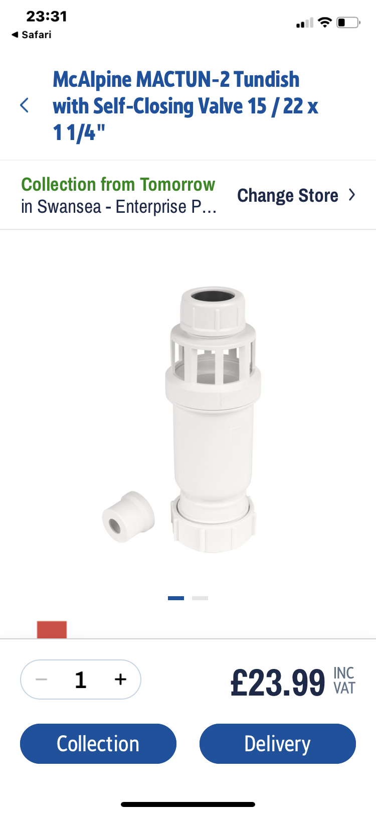

jayc89 Posted June 4, 2023 Share Posted June 4, 2023 When I had our boiler moved a few months ago, the wally who did it decided to not re-fit the drain tap. Right now I can manage by draining from a downstairs radiator, but I'll soon replace that with UFH, so I need to install a drain tap somewhere. The best place would be in the understair cupboard, just before the UFH pump, but to actual drain I'd need to run a hose pipe through the house. At the otherside of the understair cupboard wall will be the basin in our downstairs W/C. The waste pipe for that is to be boxed in, could I fit some sort of permanent pipe from the drain tape into my 40mm basin waste? Perhaps using 21.5mm condensate pipe or similar? Link to comment Share on other sites More sharing options...

jayc89 Posted June 4, 2023 Author Share Posted June 4, 2023 Something like that would work, but I want to drain straight into a waste pipe, not run anything else externally. Could I use a 22mm compression fitting to join the existing 22mm copper going to my UFH to a 21.5mm condensate pipe and then connect that to the 40mm waste? Link to comment Share on other sites More sharing options...
jayc89 Posted June 23, 2023 Author Share Posted June 23, 2023 Trying to figure this out again as I'd like to get it sorted over the weekend ready to finish off this part of the house next week. I think I need something like this; But I'm not sure how to connect the Lever Valve to the 40mm (solvent weld) waste. I can get a 40mm to 21.5mm reducer typically for condensate pipes etc, can I somehow join a length of 21.5mm solvent weld pipe to the other end of a 22mm lever valve? Any ideas @Nickfromwales? Link to comment Share on other sites More sharing options...

Nickfromwales Posted June 24, 2023 Share Posted June 24, 2023 On 23/06/2023 at 21:20, jayc89 said: Trying to figure this out again as I'd like to get it sorted over the weekend ready to finish off this part of the house next week. I think I need something like this; But I'm not sure how to connect the Lever Valve to the 40mm (solvent weld) waste. I can get a 40mm to 21.5mm reducer typically for condensate pipes etc, can I somehow join a length of 21.5mm solvent weld pipe to the other end of a 22mm lever valve? Any ideas @Nickfromwales? For a drain point you can accept a compromise here. 21.5mm o/f pipe will actually seat quite nicely into a 22mm push fit connector. So 22mm pipe into one side, and 21.5mm into the other will work. Tbh, you could even use a 22mm compression coupler, with a 3/4” olive in the 21.5mm side. None of this would be anywhere near the chat if this was either a potable or a heating circuit, but it’s to save you using a hosepipe so we can allow a pinch of “it’ll be fine”. Go with a push fit coupler is my advice, but when draining just go easy vs tap wide open at max wallop. For belt and braces you should go into a 22mm x 22mm tundish, and then into a suitable waterless trap (eg so you can see when it’s finished draining off). 1 1 Link to comment Share on other sites More sharing options...
Nickfromwales Posted June 24, 2023 Share Posted June 24, 2023 Happy days. Just read it back and it’ll take 22mm pipework. Thank me with beer. 👍 Link to comment Share on other sites More sharing options...
jayc89 Posted June 25, 2023 Author Share Posted June 25, 2023 9 hours ago, Nickfromwales said: Happy days. Just read it back and it’ll take 22mm pipework. Thank me with beer. 👍 Brilliant, thanks. These beers are adding up! 1 Link to comment Share on other sites More sharing options...
