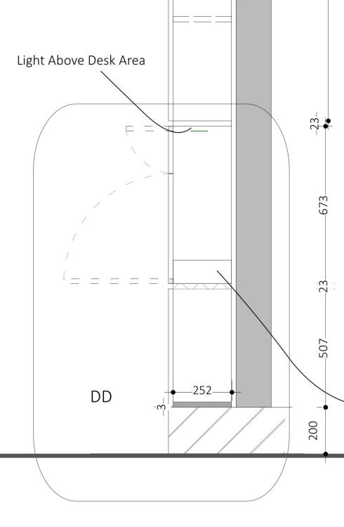

I am having a cabinet/drop down desk being built which is about 67cm wide. The cabinet door drops down and forms a desk, and within the cabinet is our home PC. It would be useful to have an LED strip fixed into a  routered out channel of the top of the cabinet carcass, which is 27mm thick.
Can anybody recommend an LED strip that comes in warm white (I prefer 2800K but anything between 2800K and 3000k is fine) and that can be switched on by the cabinet being opened and switched off by the cabinet being closed? It would need to be around 60cm or 65cm wide.

Sure there could be a block of wood on the inside of the door that hits the micro switch
I found when I did mine 20 years ago it was best to have the parts to let the joiner see what was involved, how much travel the microswitch has etc
im sure there are options in the Hafele catalogue but don’t know that one so well compared to the TLC one

Indeed. This is all proving quite complicated. Here is a cross section to show the design of the unit:
we want the light to project forward slightly, so it illuminates the drop down desk, so I probably need a fairly low beam angle.
Link to comment
Share on other sites
Dispersion is pretty much unmanageable with LED strips.
Would you not be better off installing the strip near to the inside edge of the upper opening ‘door’?
You can then have a stubby timber pelmet which stops the light from shining ‘inwards’.

Possibly, although surely a timber pelmet could act as a diffuser along the top just as easily. Alternatively, should I be looking at a GU10 bulb light fitting, with a bulb that has a 12 or 24 degree beam angle, and get one of those light fittings that allows you to angle the bulb slightly? Or a miniaturised version of that:
