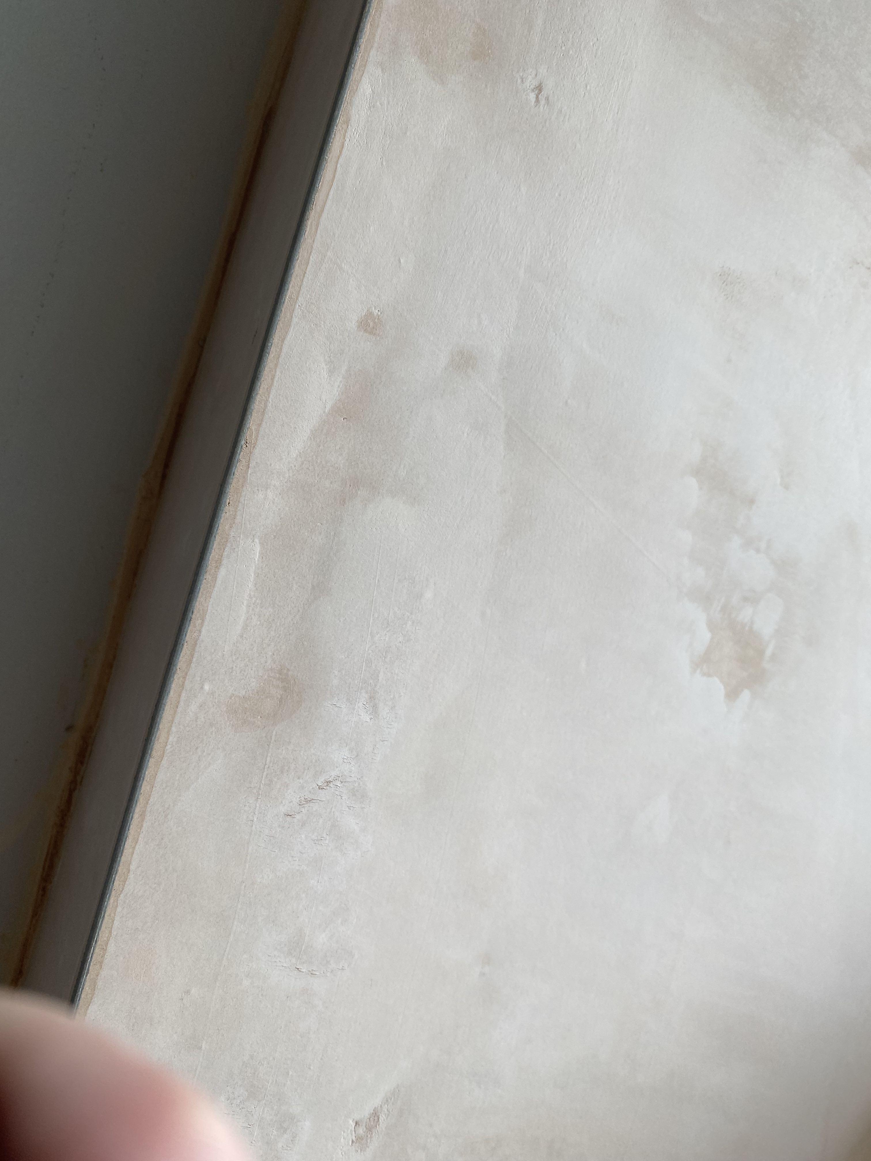

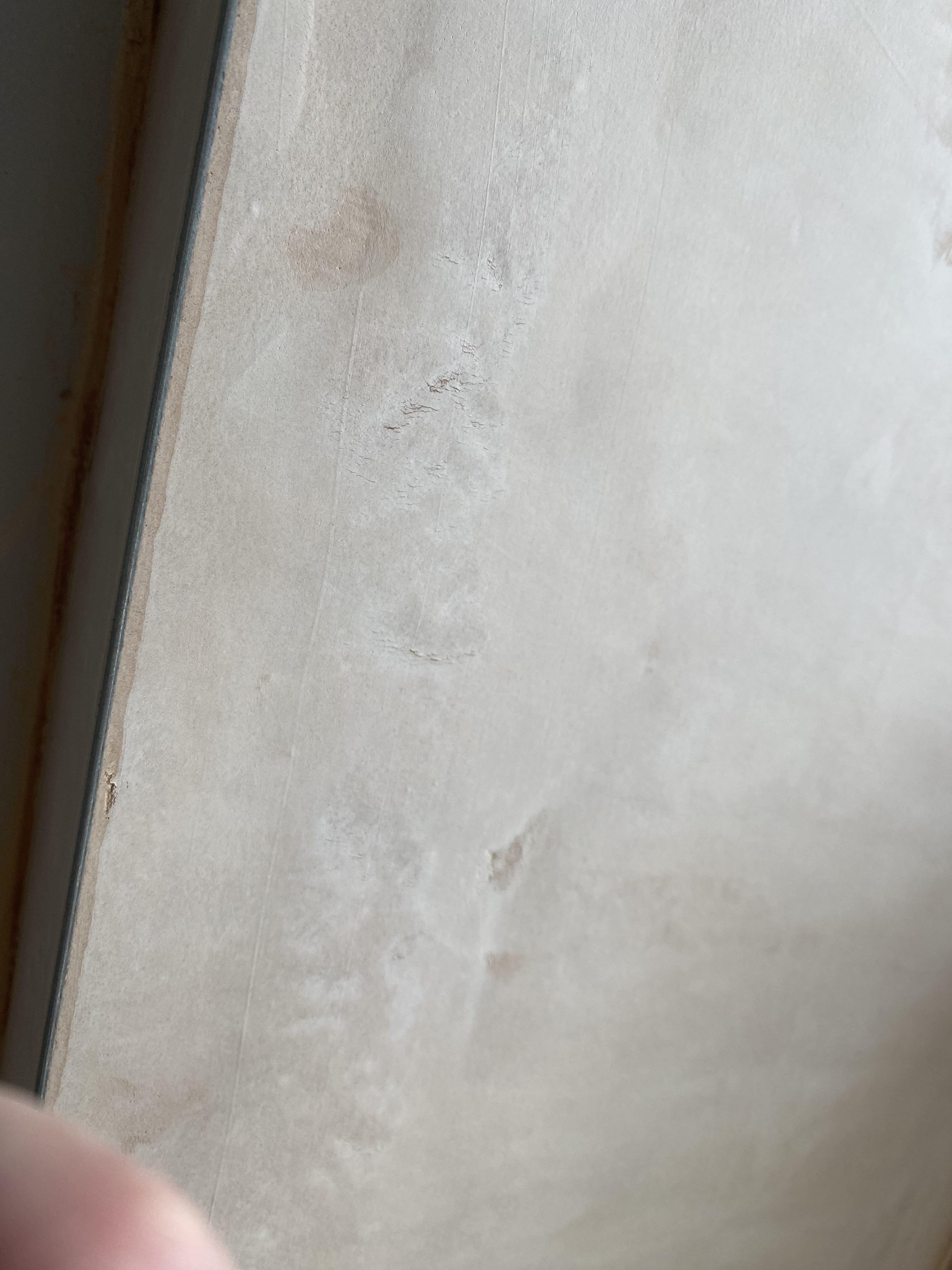

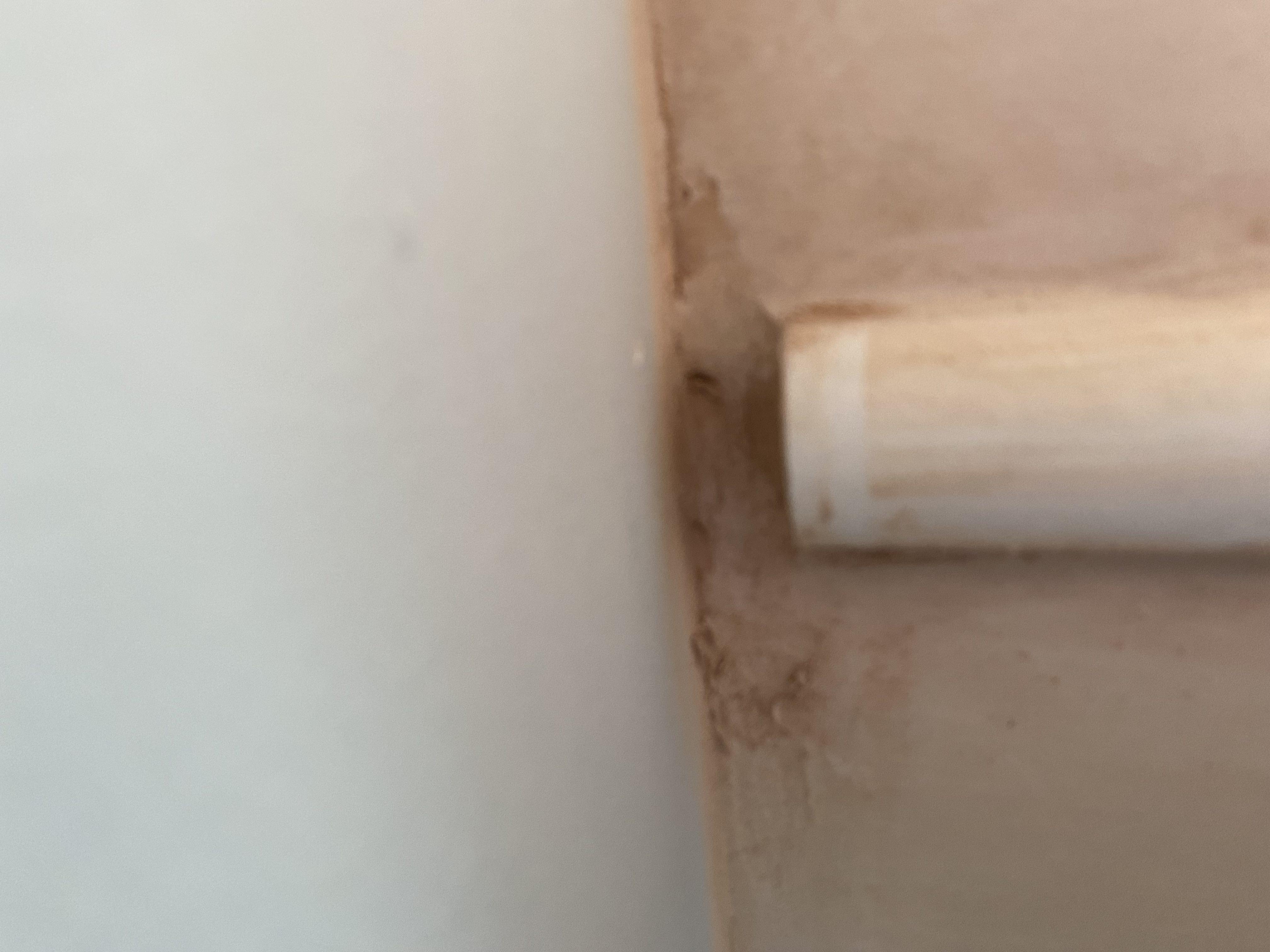

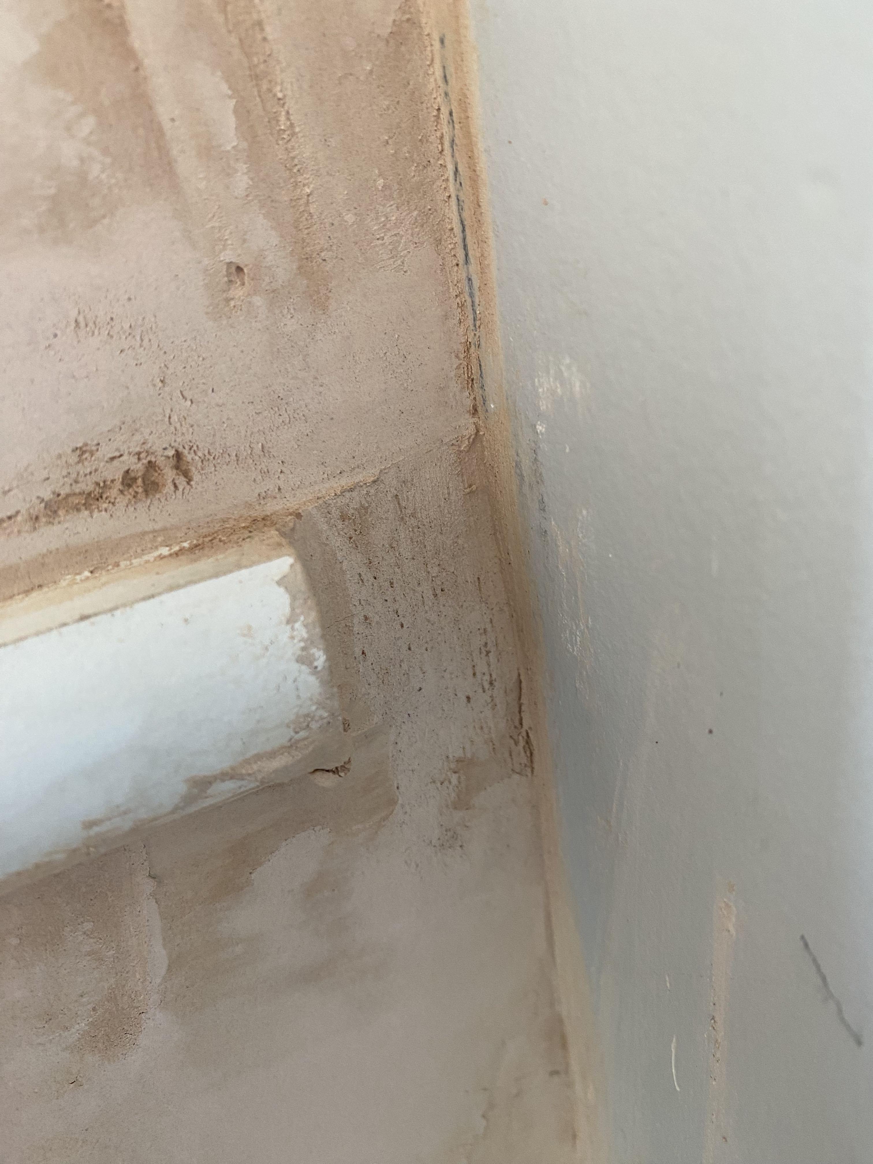

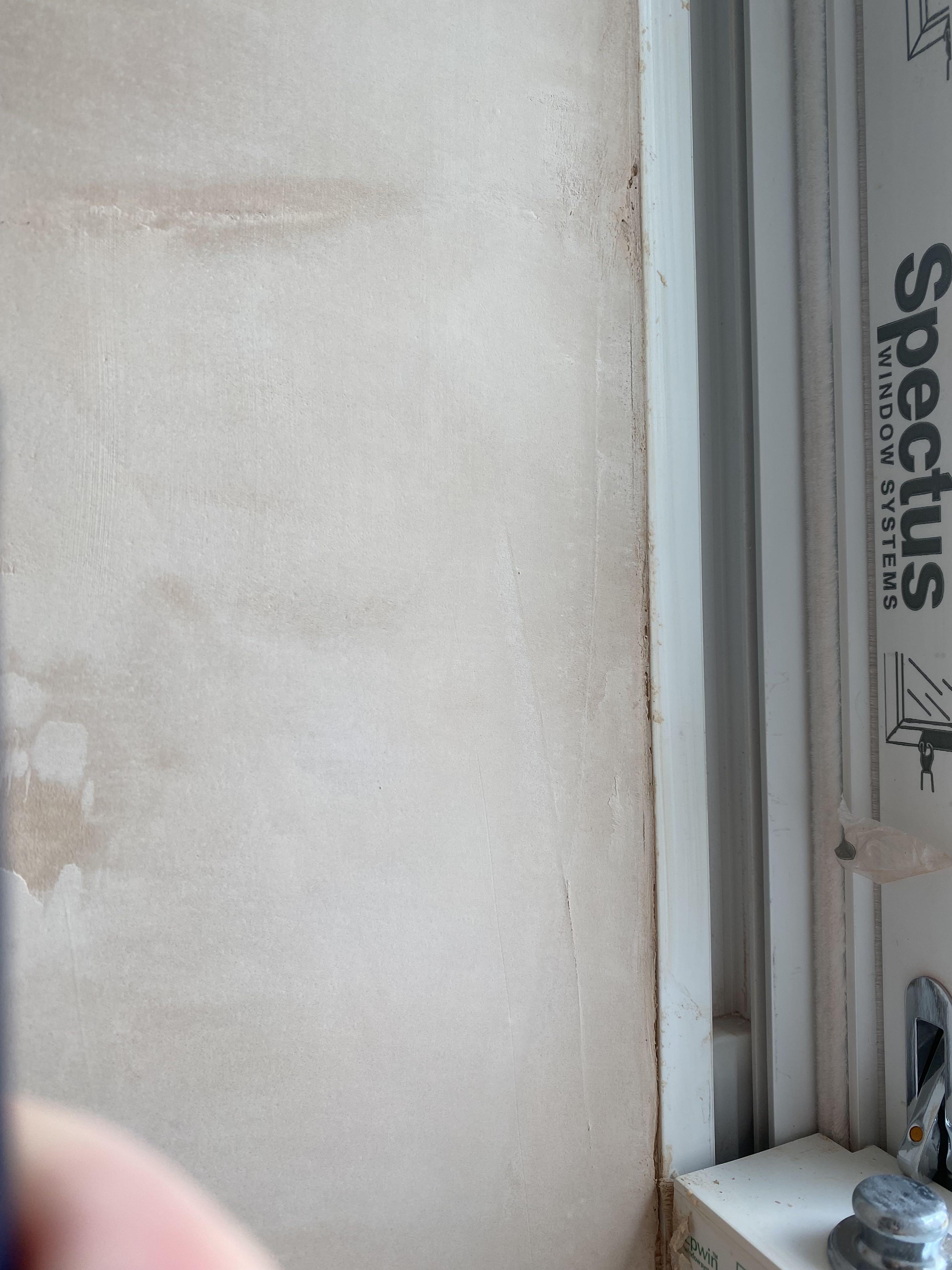

jayc89 Posted June 13, 2023 Author Share Posted June 13, 2023 Window board on and skimmed last week. The finish looks pretty rough to me, appreciate around the window board will be a PITA as there isn't much room, but there's rough to the touch bits around all of the window reveal. The guy who did it said the reveal needs a light rub down and he's coming back to look at the bits around the window board. Am I being OTT? Link to comment Share on other sites More sharing options...
Dave Jones Posted June 13, 2023 Share Posted June 13, 2023 would have extended the cill to the wall rather than leave a little gap. Doesnt look that bad in fairness, decent decorator will polish it up. Link to comment Share on other sites More sharing options...
jayc89 Posted June 13, 2023 Author Share Posted June 13, 2023 Just now, Dave Jones said: would have extended the cill to the wall rather than leave a little gap. Doesnt look that bad in fairness, decent decorator will polish it up. In hindsight that would have been a better idea. Luckily I don't have any more narrow rooms to content with. Link to comment Share on other sites More sharing options...
