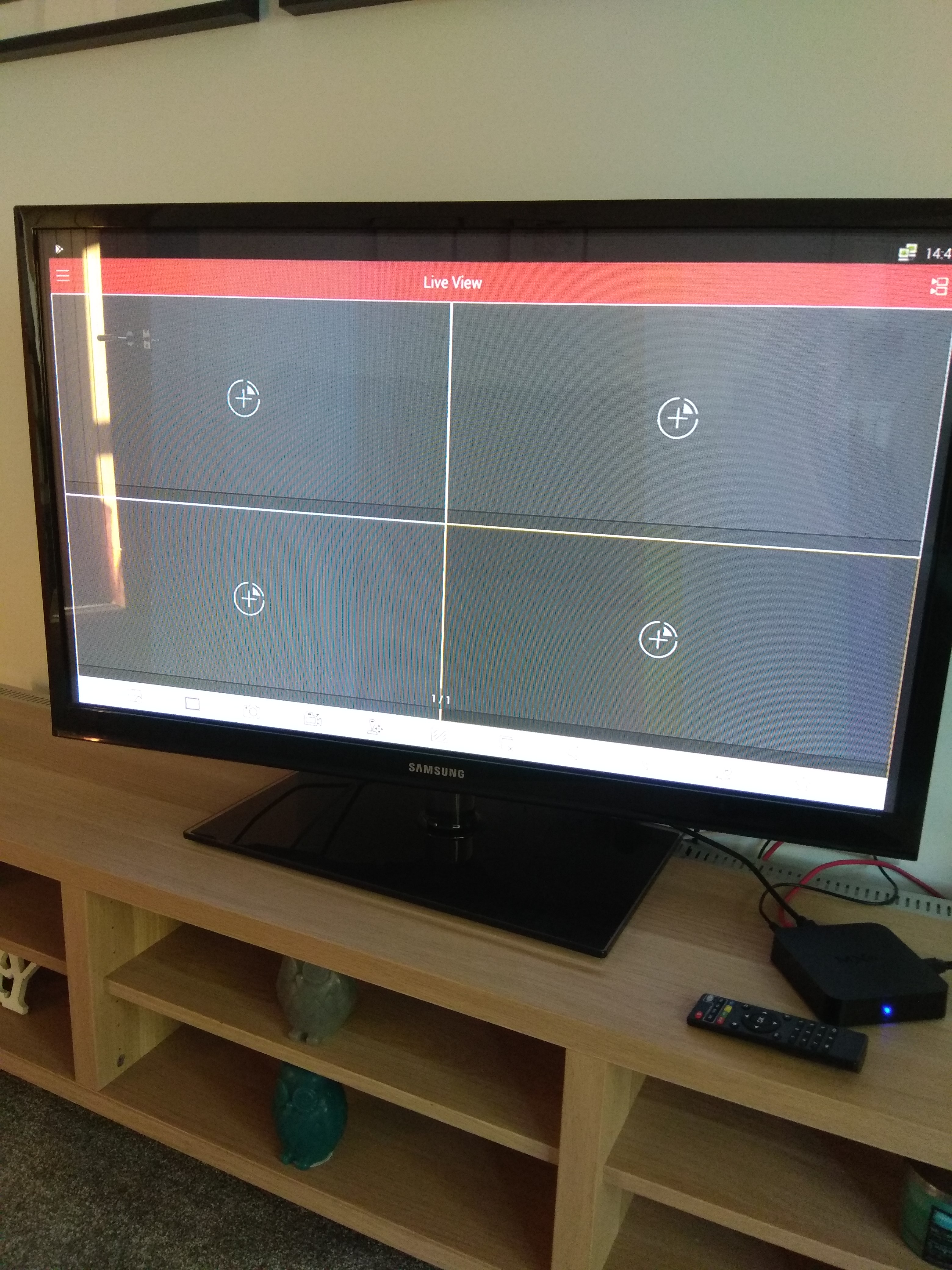

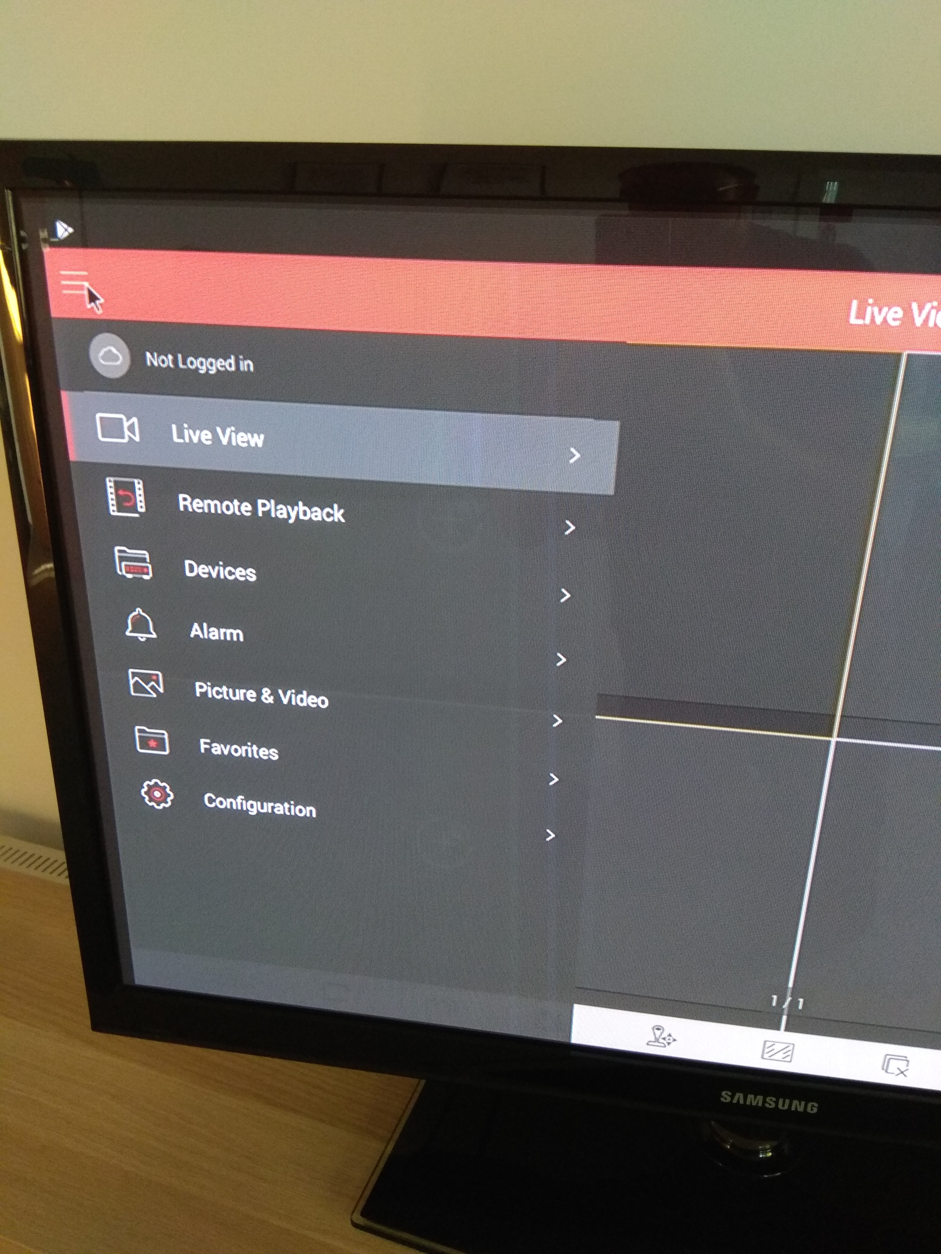

Declan52 Posted August 15, 2017 Posted August 15, 2017 (edited) Installed fine. The first pic is what it loads up to showing 4 places to load up camera feeds. The 2nd is the option menu. Edited August 15, 2017 by Declan52 1
Jeremy Harris Posted August 15, 2017 Posted August 15, 2017 Great news Declan, that's exactly what I was hoping would work! Which Android box did you use?
