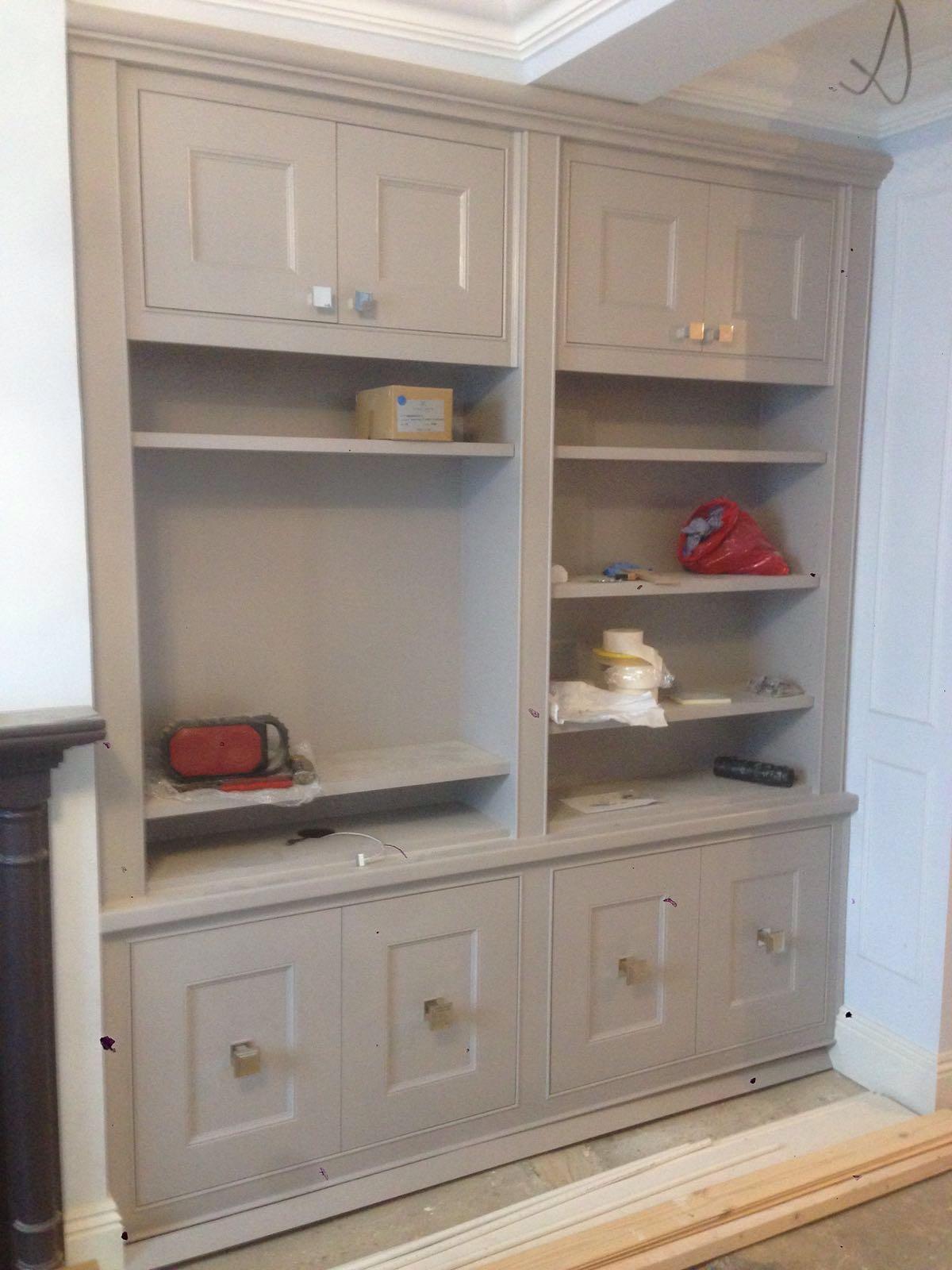

There are people that will make anything for a price. When we built our house in 2007 we decided to get some built in cupboards for a utility room made in a style that matched the kitchen.  They were made from Tulip wood and cost us about £3k fitted but unpainted. Photo below. I could probably have made them myself but had a house to finish.
We asked three local companies to quote to fill a space with floor to ceiling units in a similar style to those in the kitchen. Left them to work out the details. Actually what I did was go visit a few first, I said I might be looking for some work done and they showed me a book of what they had done for other people. Also got to see their workshop and what they were currently working on. Called them back later to ask them to come and quote.
Fitting floor to ceiling units is tricky because you can't get them in through a door upright, and if you take them in laid flat you can't stand them up because the diagonal is taller than the ceiling if you get what I mean. They may have to be made in two parts, a top and bottom.
