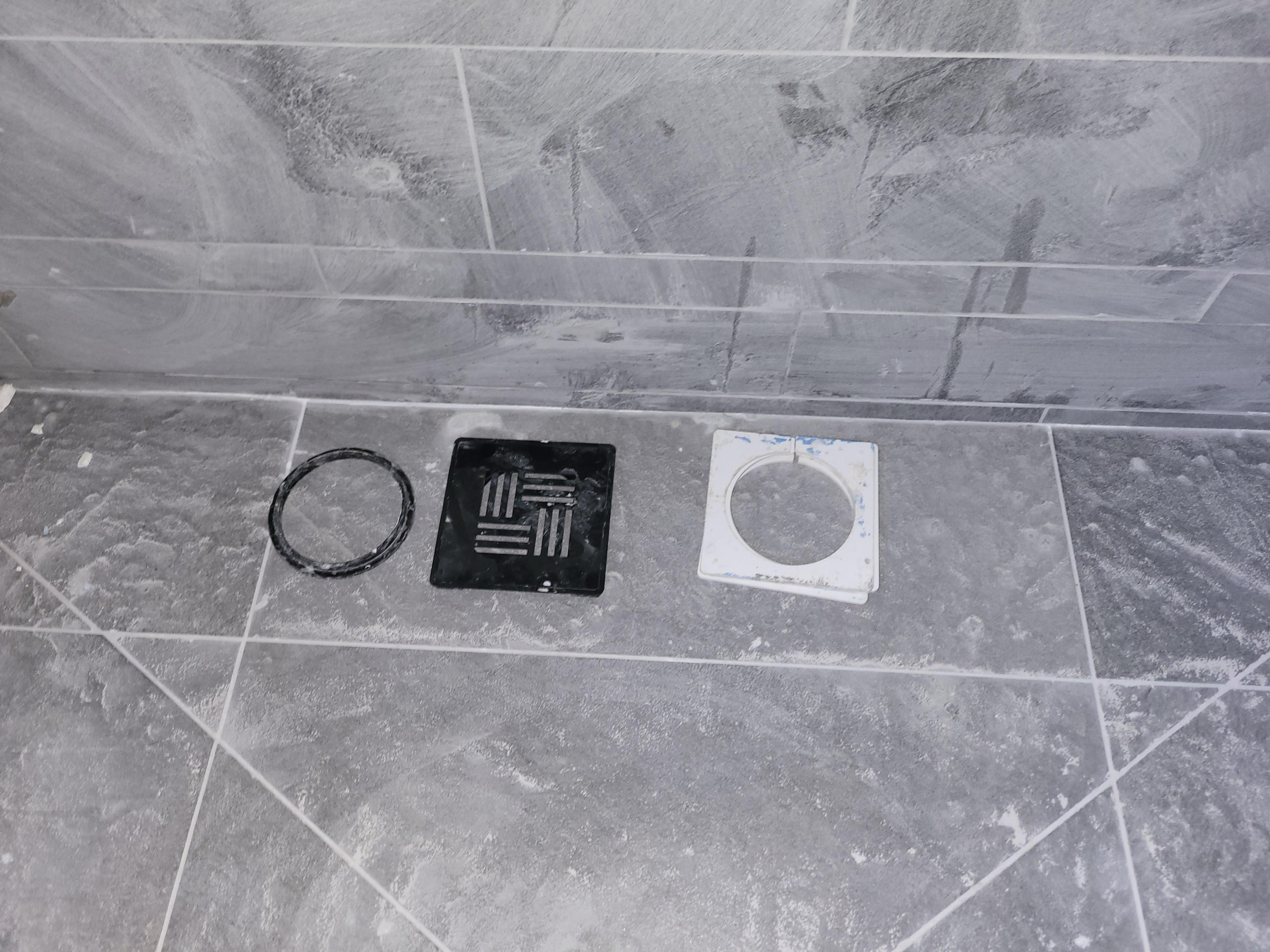

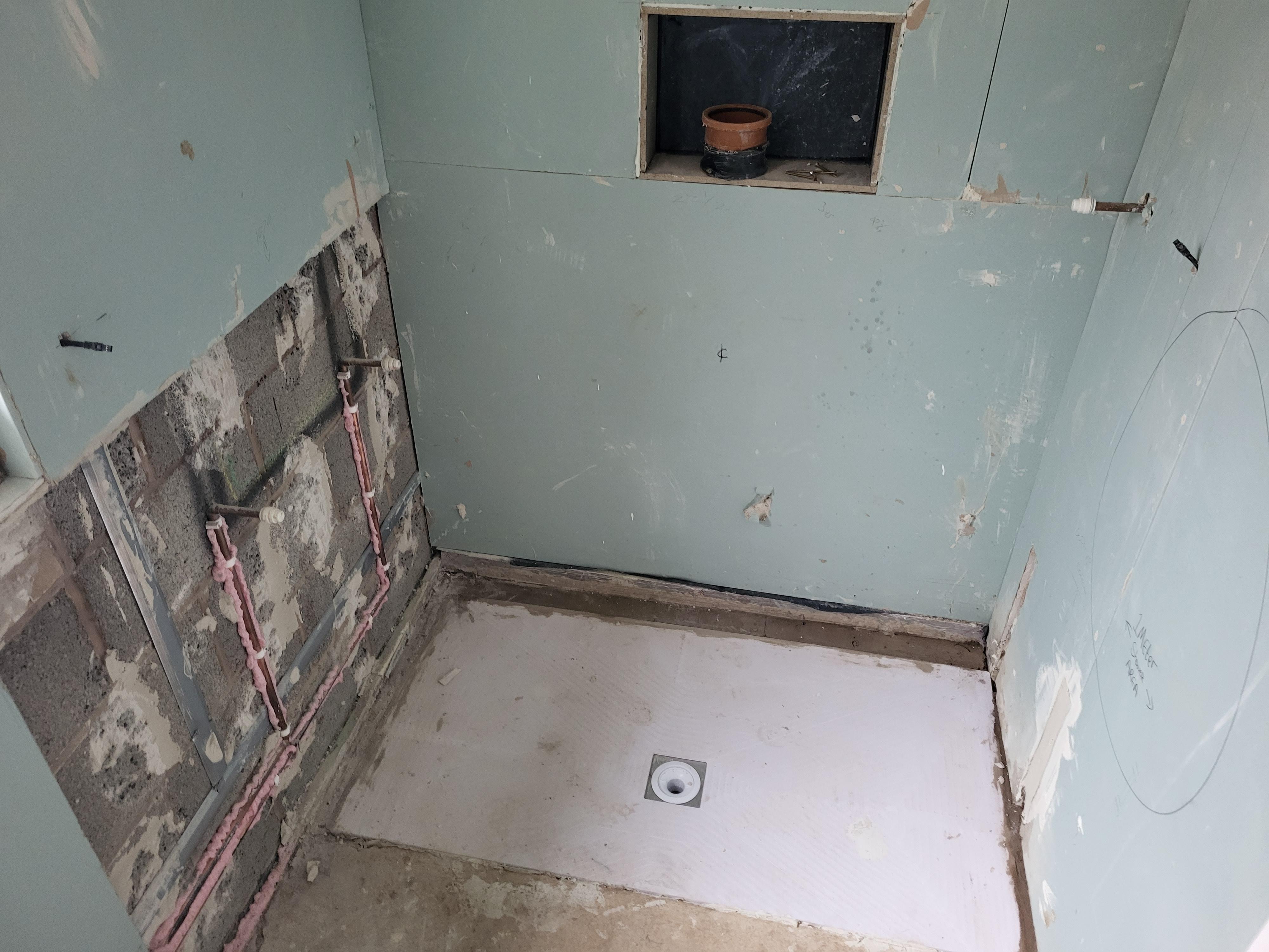

Andehh Posted May 28, 2023 Posted May 28, 2023 We have a wetroom going in our bungalow. It's build up is: 1) Block beam 2) insulation 3) concrete slab 4) wetroom tray (white plastic preformed) 5) Self leveller or equiv, something which blends the tray in with the rest of the room 6) blue tanking fluid x 2 7) Slip membrane 8) Tiles What I don't understand is what the drain details will be, how it is sealed up with so many layers? Usually I've seen some sort of bowl that is silcioned to it, but I don't see one in the drain kit on site. Pic attached! Thanks

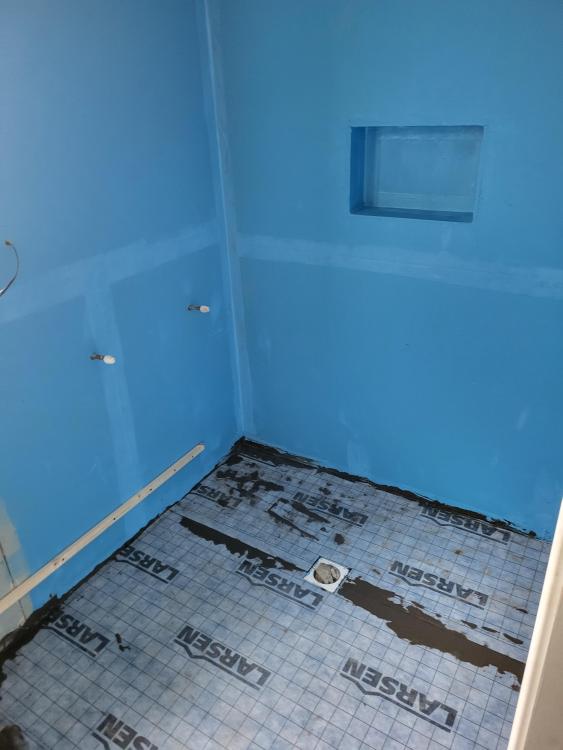

dpmiller Posted May 28, 2023 Posted May 28, 2023 should there not have been a piece of tanking stuck down with the liquid membrane? this kinda thing https://www.sealantsandtoolsdirect.co.uk/aquaseal-wet-room-tanking-waterproof-drain-mat-aqwrsdrain?language=en-gb¤cy=GBP&gclid=Cj0KCQjw98ujBhCgARIsAD7QeAjDtCOWDv1UN_Y0-iR4-zW7p74e7RzZ5rYVIP8WokopUpJvDQ0l8bcaApXPEALw_wcB

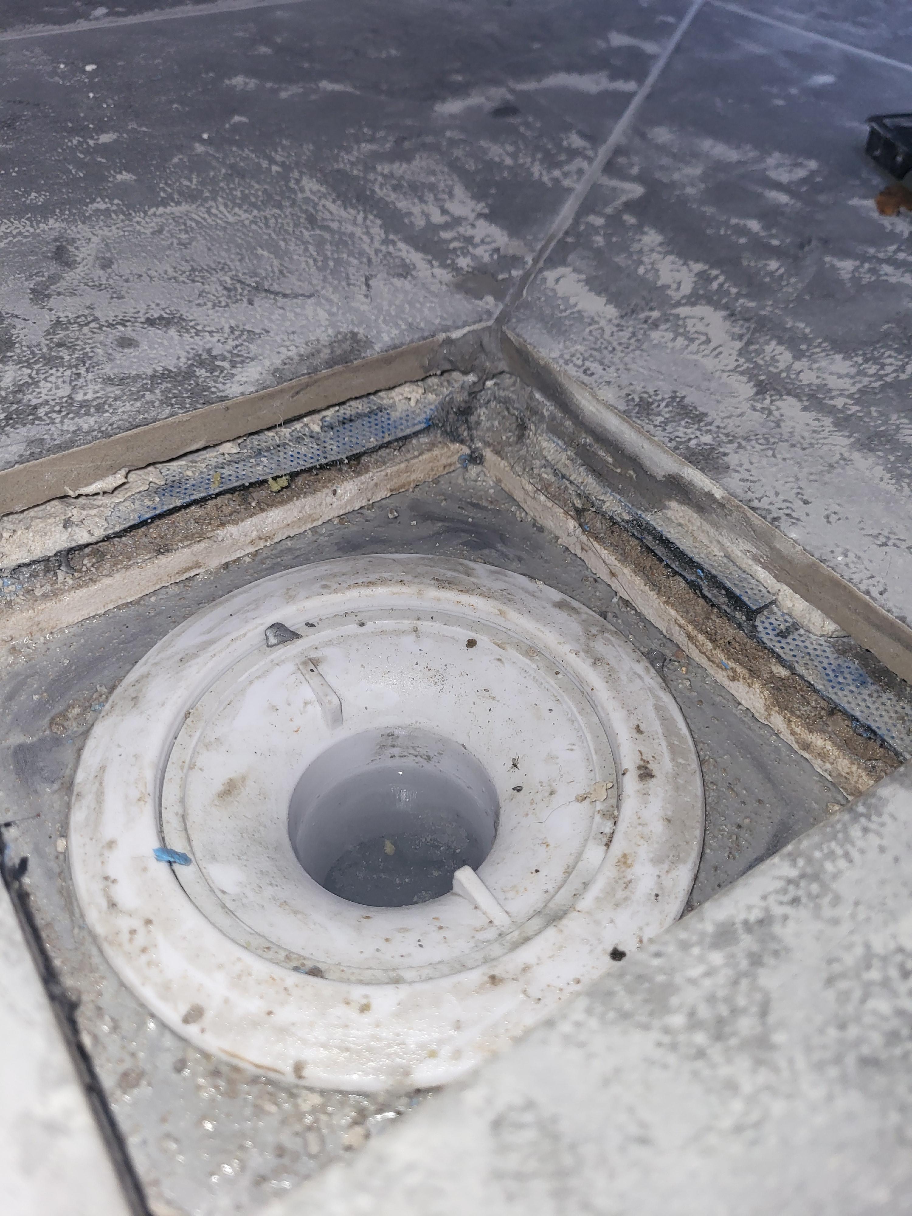

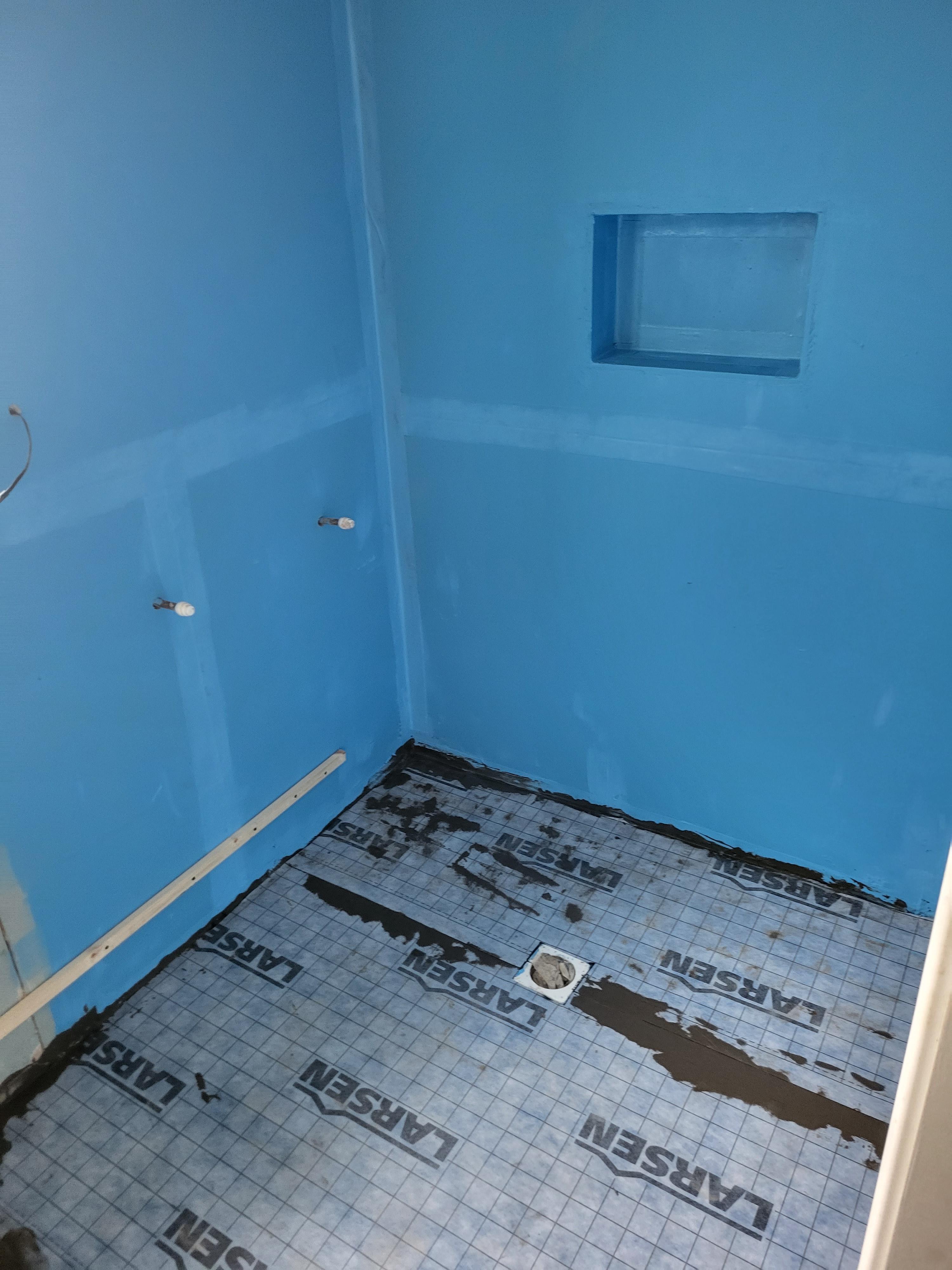

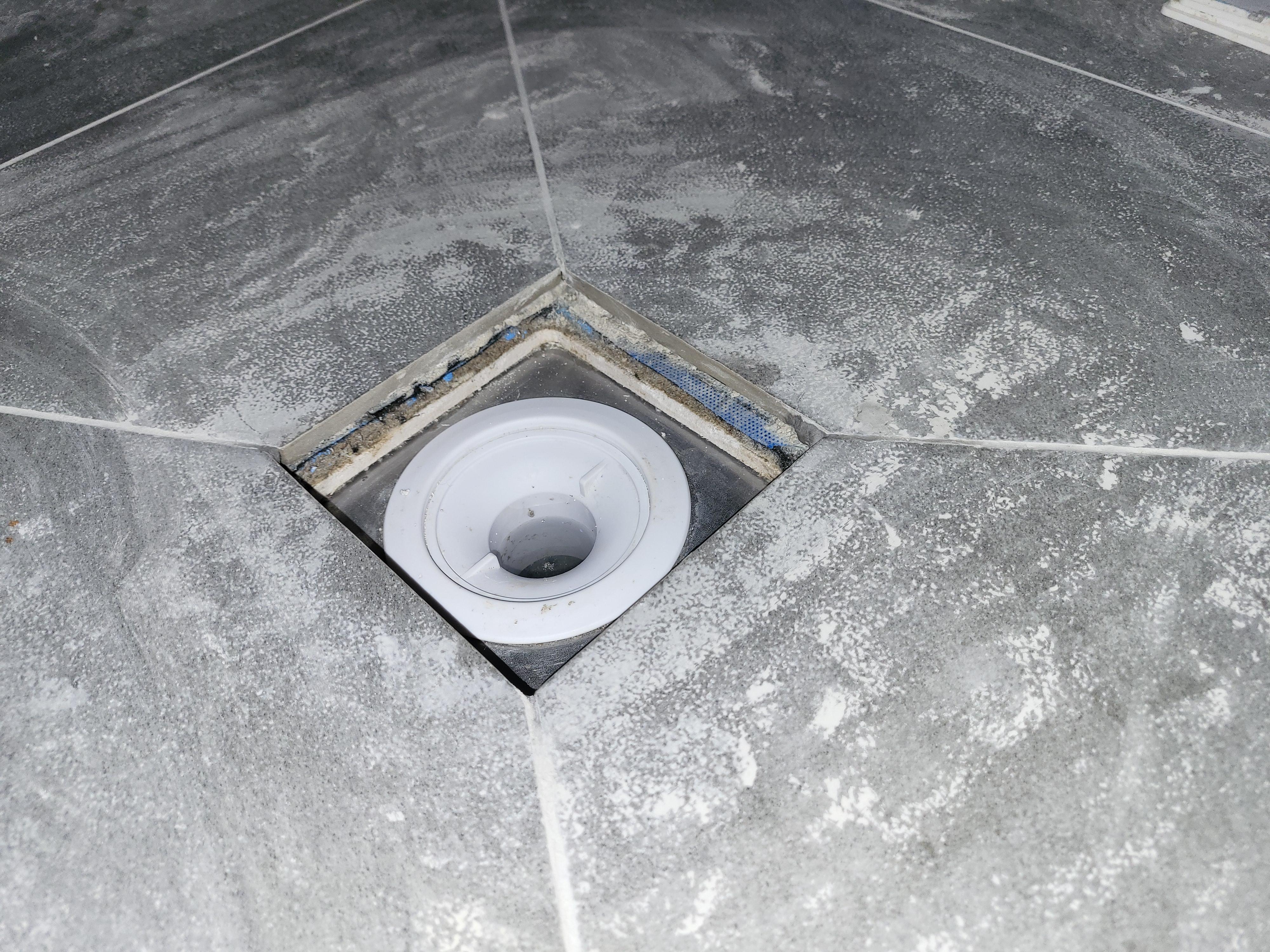

Andehh Posted May 28, 2023 Author Posted May 28, 2023 (edited) Tiler did the room like the attached pic (whole room is blue, the floor just has the anti crack mat laid in top of it), but the plumber is doing the Drains. The wetroom tray only came with the large plastic former, then a metal stainless steel glue in plate for the Drains to be mounted into...which is what the pics show. Tiler using the white spacer as a guide in pic below. The kit just contained the metal grate rubber gasket then 4 of those white spacer things. Tiler did everything, but has left it like the previous pics. Edited May 28, 2023 by Andehh
Andehh Posted May 28, 2023 Author Posted May 28, 2023 And a pic of the tray and stainless steel plate.... Tiler redid the boarding as it wasn't quite square.
