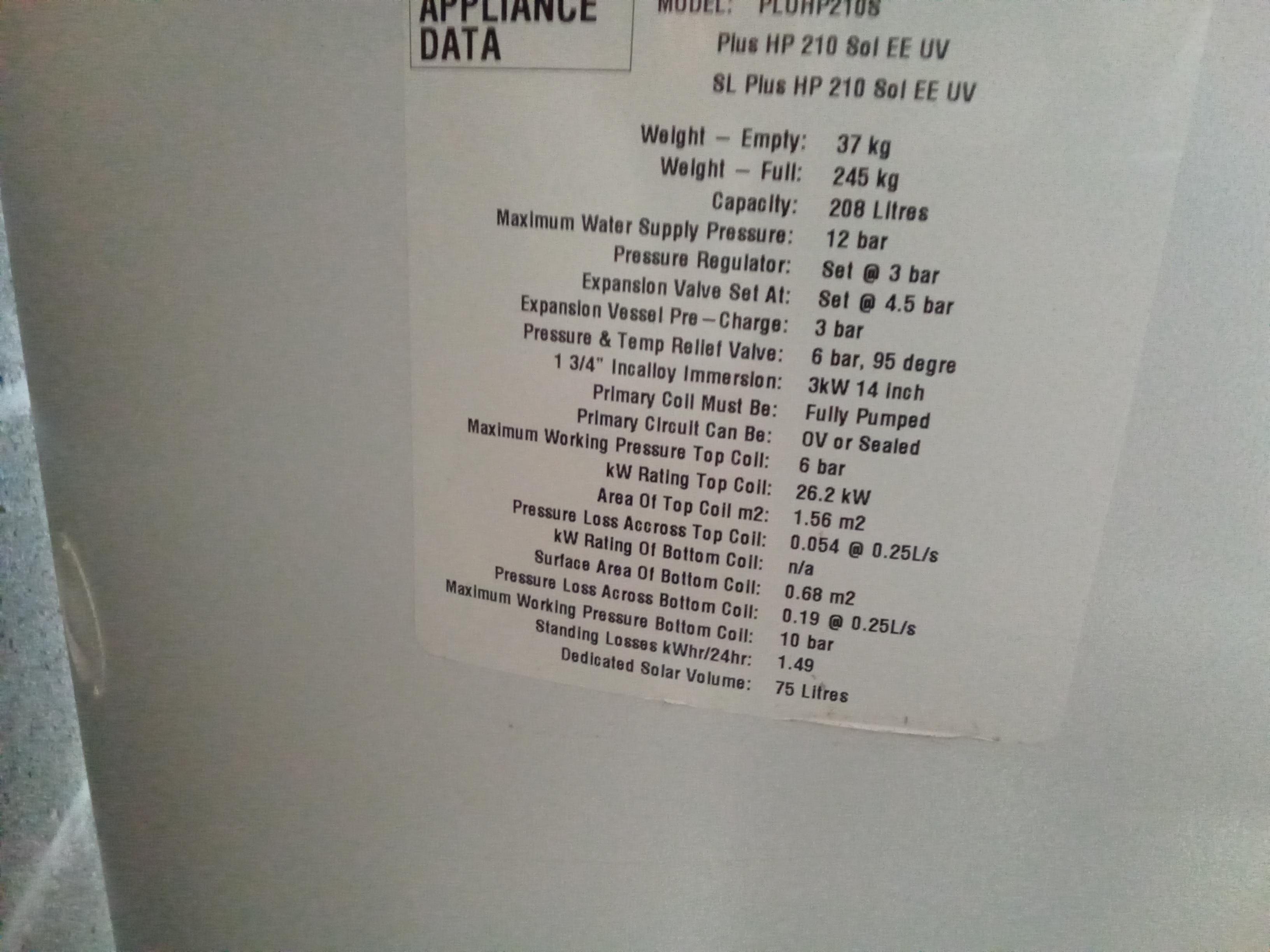

JohnMo Posted May 28, 2023 Share Posted May 28, 2023 It sounds like the the cylinder set point is too high. So the heat pump runs to max temperature stops and restarts and keeps doing this. Your set point should be say around 48. What temp are you trying to achieve in the cylinder and from the cylinder nameplate it should state the coil size. So can you confirm cylinder set point, and coil size? Link to comment Share on other sites More sharing options...

loxian Posted May 29, 2023 Author Share Posted May 29, 2023 I don't know where to find the cylinder set point, although I suspect you are right. I have no user manual so I am largely working blind. I have two cylinders- a 60 litre tank connected directly to the HP external unit which feeds a 210 litre DHW cylinder, UFH and radiator circuit. DHW is set at 42 Celsius which seems comfortable. The 60 litre tank seems hot - well above 42 degrees but I can't work out how to control the temperature. I have checked the control panel usage stats; While electricity consumption is around 14kwh most days, the figure for generation is much lower, as low as 1.8kwh some days. Forgive me if I'm coming across as a complete noob, but I want to fully understand how the system works and this is a very steep learning curve. I have attached photos of the cylinder labels Link to comment Share on other sites More sharing options...

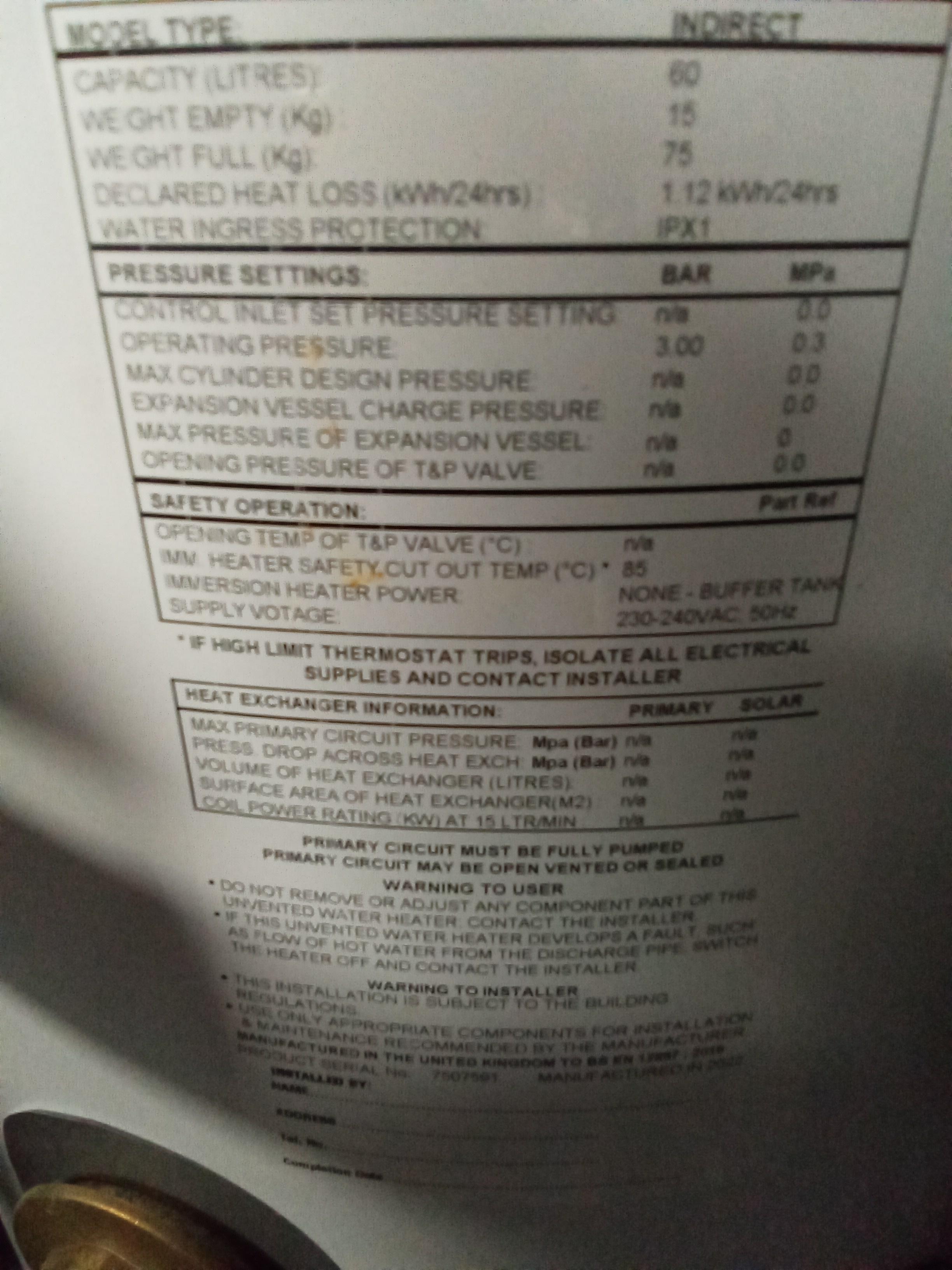

JamesPa Posted May 29, 2023 Share Posted May 29, 2023 (edited) 1 hour ago, loxian said: I have two cylinders- a 60 litre tank connected directly to the HP external unit How many connections to this? 2, 3 or 4? Do you have/can you create a diagram of how it's all plumbed together. Edited May 29, 2023 by JamesPa Link to comment Share on other sites More sharing options...
crispy_wafer Posted May 29, 2023 Share Posted May 29, 2023 Wonder if this 60l tank is some kind of buffer tank? Does it have it's own immersion? Link to comment Share on other sites More sharing options...
JamesPa Posted May 29, 2023 Share Posted May 29, 2023 (edited) 1 minute ago, crispy_wafer said: Wonder if this 60l tank is some kind of buffer tank? Does it have it's own immersion? That's what I'm thinking, but without a system diagram it's complete guesswork. A lot of energy is apparently going somewhere Edited May 29, 2023 by JamesPa Link to comment Share on other sites More sharing options...

loxian Posted May 29, 2023 Author Share Posted May 29, 2023 I have done a bit more digging and tried to work out what is going where. As far as I can work out, a pump circulates water from the 60 litre buffer tank through the heat pump. There is then another circuit taking water from the 60 litre buffer tank, splitting three ways with three valves controlling UFH, radiators and DHW. There is another pump in this circuit but there is no obvious sign that it is functioning. It is exactly the same type of pump as the first one but whereas the first pump lights up with a digital display, the second pump stays dark. I wonder if perhaps this pump could be the source of my issues... Link to comment Share on other sites More sharing options...
JamesPa Posted May 30, 2023 Share Posted May 30, 2023 13 hours ago, loxian said: I have done a bit more digging and tried to work out what is going where. As far as I can work out, a pump circulates water from the 60 litre buffer tank through the heat pump. There is then another circuit taking water from the 60 litre buffer tank, splitting three ways with three valves controlling UFH, radiators and DHW. There is another pump in this circuit but there is no obvious sign that it is functioning. It is exactly the same type of pump as the first one but whereas the first pump lights up with a digital display, the second pump stays dark. I wonder if perhaps this pump could be the source of my issues... OK its basically a small buffer tank which will thus have zero stratification. This will increase your consumption by 10-15%, even assuming that the secondary pump (the one in the CH/DHW loop) is working. If the secondary pump isn't working you wont get much heat to your emitters but you will still waste lots of energy. Without considerable further work its not going to be easy to diagnose fully, I suspect you have multiple problems. But the pump and the buffer tank are a good starting point. Link to comment Share on other sites More sharing options...
loxian Posted June 1, 2023 Author Share Posted June 1, 2023 Ok, finally got to the bottom of this. When there is demand for DHW the HP is heating the 60L buffer tank but water is not circulating through the hot water tank as the circulation pump only activates when there is demand from UFH or radiators. As a consequence, in the summer when the heating is off, the DHW cylinder is literally only heated by thermal conduction along the copper pipe!! (Unless the booster heater is enabled - in which case the cylinder is heated entirely by the emersion heater). After speaking to an engineer from Samsung, it turns out that they do specify the use of a buffer cylinder in order to ensure sufficient flow volume through the heat pump but, crucially, they specify a T-connection from the heat pump directly to the DHW cylinder bypassing the buffer cylinder. The installer had never fitted this, meaning that DHW only functions when either the UFH or radiators are on. This explains entirely why our electricity usage was static at about 15KWh per day just for hot water, even when no hot water had been used. There was a constant demand for DHW throughout the day (and night) which was never able to be satisfied. The HP just short-cycles as the buffer cylinder is at max temperature yet the DHW cylinder never reaches temperature. 1 1 Link to comment Share on other sites More sharing options...
JamesPa Posted June 3, 2023 Share Posted June 3, 2023 On 01/06/2023 at 22:11, loxian said: Ok, finally got to the bottom of this. When there is demand for DHW the HP is heating the 60L buffer tank but water is not circulating through the hot water tank as the circulation pump only activates when there is demand from UFH or radiators. As a consequence, in the summer when the heating is off, the DHW cylinder is literally only heated by thermal conduction along the copper pipe!! (Unless the booster heater is enabled - in which case the cylinder is heated entirely by the emersion heater). After speaking to an engineer from Samsung, it turns out that they do specify the use of a buffer cylinder in order to ensure sufficient flow volume through the heat pump but, crucially, they specify a T-connection from the heat pump directly to the DHW cylinder bypassing the buffer cylinder. The installer had never fitted this, meaning that DHW only functions when either the UFH or radiators are on. This explains entirely why our electricity usage was static at about 15KWh per day just for hot water, even when no hot water had been used. There was a constant demand for DHW throughout the day (and night) which was never able to be satisfied. The HP just short-cycles as the buffer cylinder is at max temperature yet the DHW cylinder never reaches temperature. Well that's that one sorted at least, but I'm curious whether there is a diverter valve or not and if so where this fits. Might be worth checking this too. Also you should be aware that your tiny 4 port buffer tank will certainly be costing you a 10-15 percent increase in consumption during the heating season. There are more intelligent ways to increase system volume if that's the only objective, namely a 2 port buffer and ditch the second pump. However without a full system diagram, making changes could have unexpected knock on effects so it would be inadvisable without getting in someone who knows what they are doing. Link to comment Share on other sites More sharing options...
