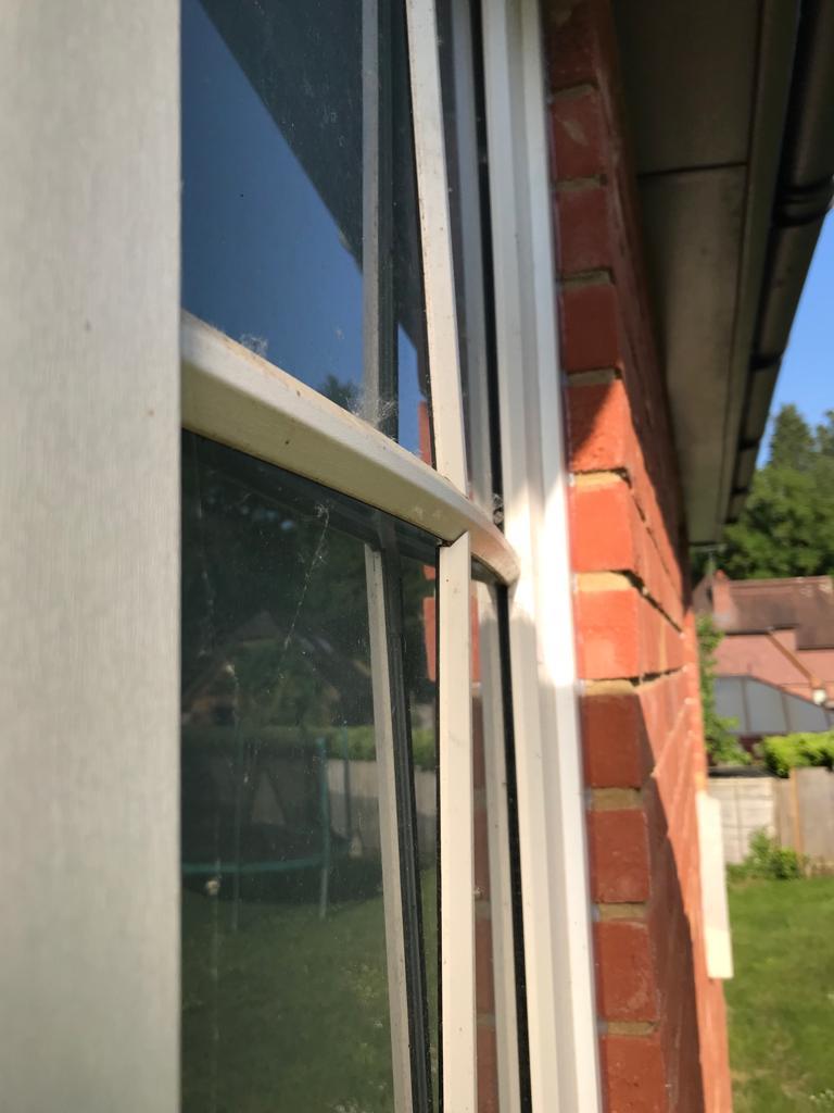

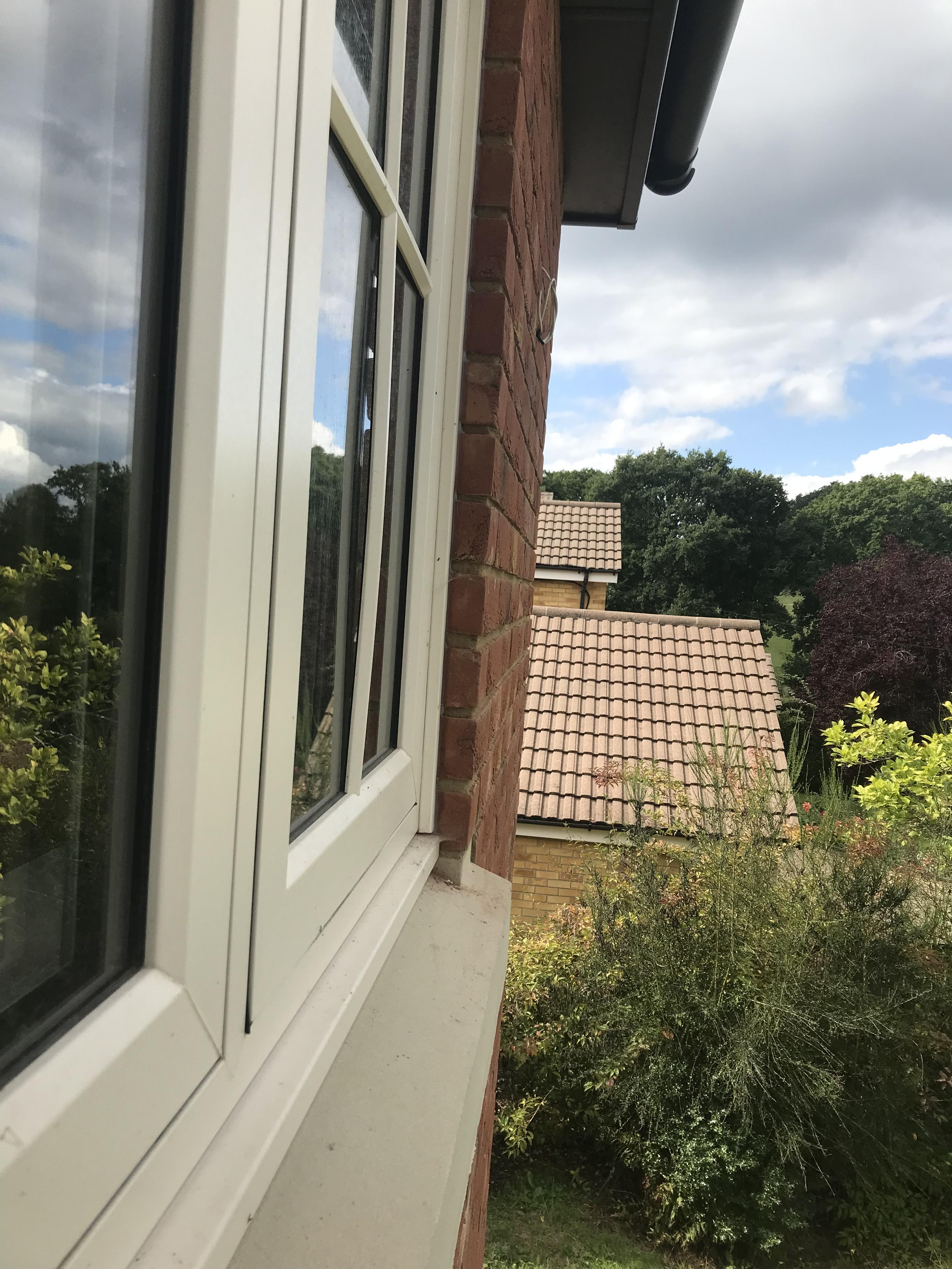

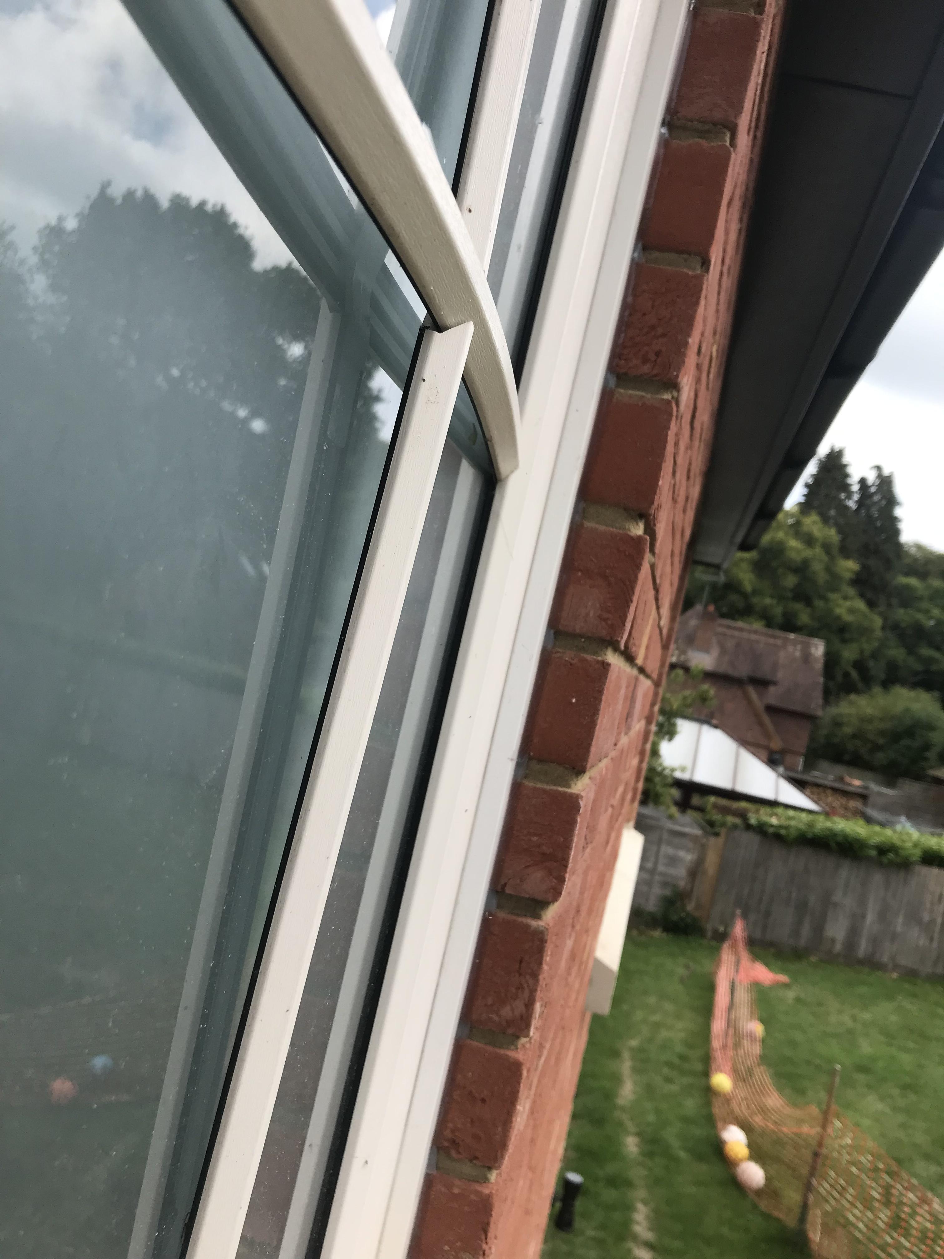

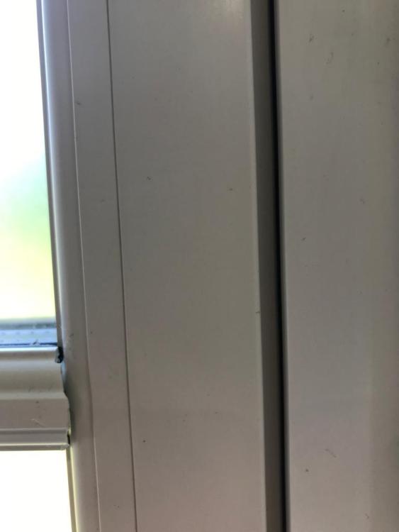

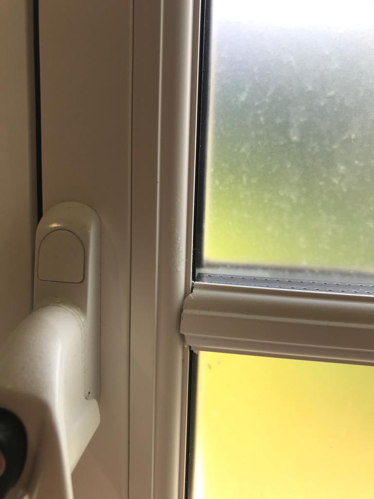

Dan1983 Posted May 27, 2023 Share Posted May 27, 2023 (edited) Evening all, We have Rehau Rio flush casement windows installed on the build with astragal bars. since the build was completed we have had issues with the bars popping away from panes. This has been on our snagging list since august last year but builder is only just addressing it. Rehau not that helpful at the moment. Independent fitter has been out today and said the bars need double sided tape to hold them down but the Rehau system is meant to be tapeless to keep the rubber seal in contact with the pane etc. In my opinion the bars have been cut too long allowing for no expansion gap making them bow in the heat. Some of the internal bars have been recut on-site to make them fit which also makes me think this. Has anyone encountered this type of issue before? i feel I’m being fobbed off by saying they should be taped, possibly need re doing each year is what we were told today! Edited May 27, 2023 by Dan1983 Link to comment Share on other sites More sharing options...

Dan1983 Posted June 13, 2023 Author Share Posted June 13, 2023 Incase anyone else gets this issue we managed to get a rehau rep out last week. basically inside bars were cut too long and outside ones not installed with correct fasteners! Link to comment Share on other sites More sharing options...

Dan1983 Posted December 19, 2023 Author Share Posted December 19, 2023 We are still working this issue for info! Rehau kindly got involved and sent a rep round to measure up for all new bars. Unfortunately when they arrived they forgot to subtract the width of the horizontal bar so ended up way too long to fit! As it stands we still need bars cut to length and some glazing removed so the correct fittings can be attached. Original installers long gone and now 18 months in since first reported to builder. Going to have to see if we can find another installer that will carry out the work I think Link to comment Share on other sites More sharing options...
Dan1983 Posted May 17, 2024 Author Share Posted May 17, 2024 Had another 2 contractors round since the Rehau rep. Finaly fitted new bars to the windows with issues and removed some of the glass to toe and heel the windows as doesn’t look like this was done on install, also to fit correct clips as some were missing. My only concern is we still have existing panes where the bars are tight either end with no expansion gap and concerned the problem may reoccur in the summer Do UPVC bars tend to expand much or should they stay fairly stable in the summer heat? Link to comment Share on other sites More sharing options...
