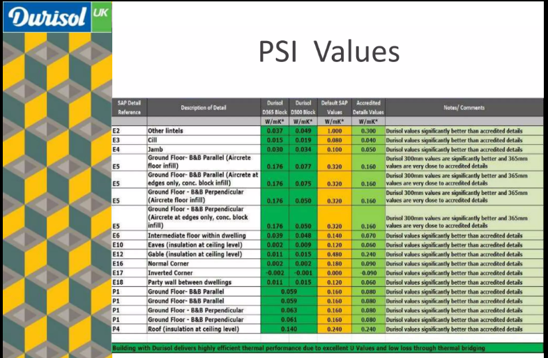

@SteamyTea thanks for your response. My SAP consultant tells me that the manufacturer/supplier would usually have a list of different non-repeating thermal bridging values - the measure of heat loss through the junctions between different construction elements expressed in w/mk.
I've found online a table for Durisol:
I have, of course, written to Isotex in Italy and asked them to provide but am hoping someone who's previously built in Isotex (or their SAP consultant) might already have such a table to hand.
