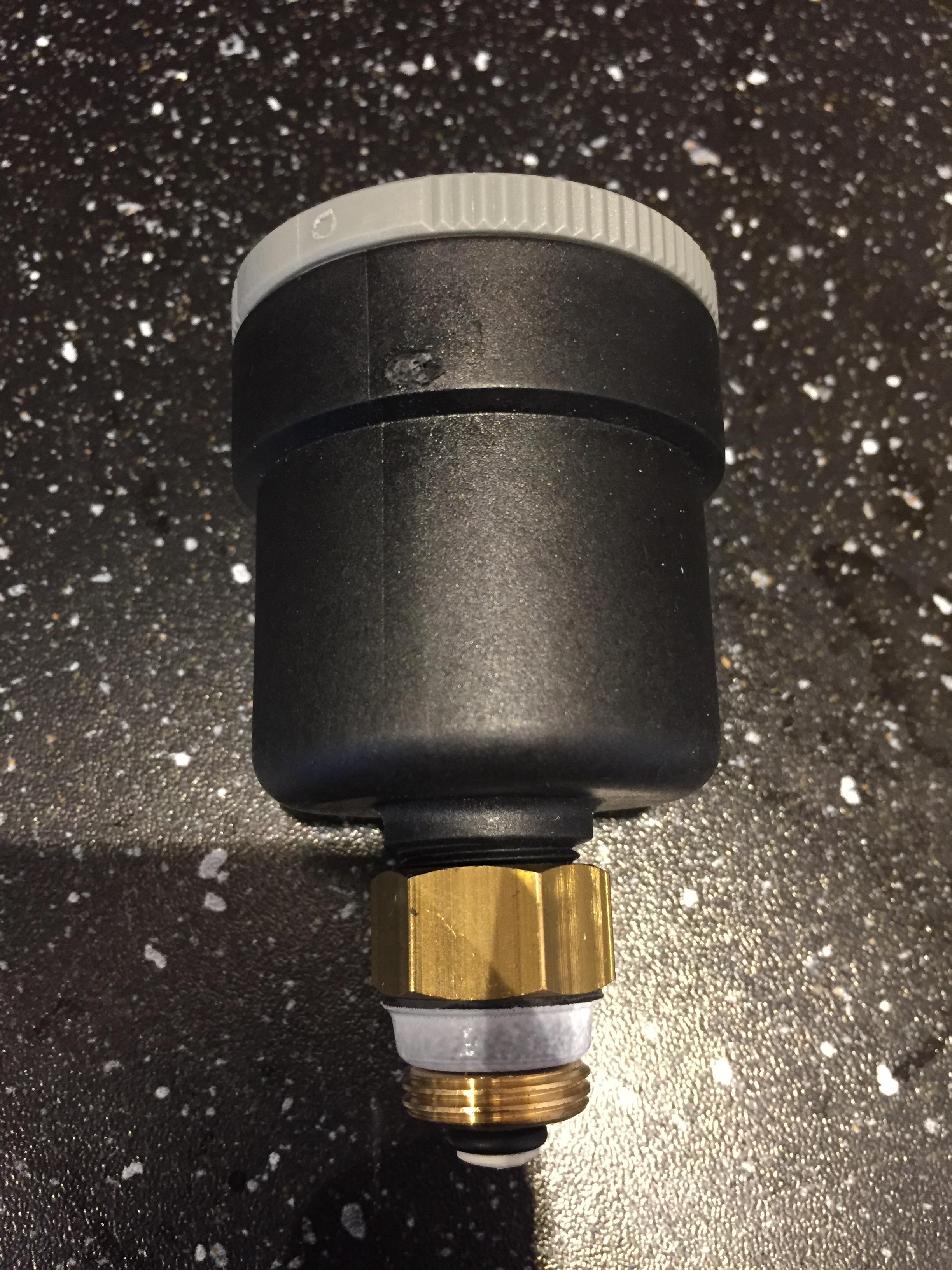

Barney12 Posted August 8, 2017 Share Posted August 8, 2017 Sorry, another plumbing question. I beleive this is an automatic air release valve (its got a red niple on the top not in the photo). Can anyone tell me what I seat this into? It's smaller than 1/2 bsp. it came just as photographed Link to comment Share on other sites More sharing options...
Jeremy Harris Posted August 8, 2017 Share Posted August 8, 2017 That looks like a 3/8" BSP one to me, one of the ones that has a shut off valve so you can unscrew the top part for servicing without draining the system down. Link to comment Share on other sites More sharing options...

Nickfromwales Posted August 9, 2017 Share Posted August 9, 2017 6 minutes ago, gravelld said: Looks like the same AAV that ruined my Christmas 2015. Was it crud in the water that actually ruined Xmas . Any contamination finds its way to the float valve in these AAV's and blocks the pins resulting in water coming out of the cap at the top. 14 hours ago, JSHarris said: That looks like a 3/8" BSP one to me, one of the ones that has a shut off valve so you can unscrew the top part for servicing without draining the system down. +1 1 Link to comment Share on other sites More sharing options...
Barney12 Posted August 9, 2017 Author Share Posted August 9, 2017 Thanks guys. It is indeed. Reducery thingy obtained from Screwfix. Link to comment Share on other sites More sharing options...
Jeremy Harris Posted August 9, 2017 Share Posted August 9, 2017 As a tip, you can unscrew the black part from the brass part to clean the valve if it needs it, without needing to drain the system down. There will be a small amount of leakage as you unscrew the black part - the faster you unscrew it the less there will be. If you wrap an old towel around the thing it will soak up the small amount that dribbles out. Link to comment Share on other sites More sharing options...
Barney12 Posted August 9, 2017 Author Share Posted August 9, 2017 23 minutes ago, JSHarris said: As a tip, you can unscrew the black part from the brass part to clean the valve if it needs it, without needing to drain the system down. There will be a small amount of leakage as you unscrew the black part - the faster you unscrew it the less there will be. If you wrap an old towel around the thing it will soak up the small amount that dribbles out. Ta. That's good to know as it's part of the sealed GSHP loop which will be a pita to drain (not to mention expensive because of the antifreeze) Link to comment Share on other sites More sharing options...
Barney12 Posted December 10, 2017 Author Share Posted December 10, 2017 On 09/08/2017 at 11:07, Nickfromwales said: Was it crud in the water that actually ruined Xmas . Any contamination finds its way to the float valve in these AAV's and blocks the pins resulting in water coming out of the cap at the top. +1 Well what do you know. My AAV seems to p*ss water out of the top. I’ve had to screw the red cap down for the moment. Is it serviceable or do I just go buy a new one? Link to comment Share on other sites More sharing options...
Jeremy Harris Posted December 10, 2017 Share Posted December 10, 2017 They can be taken apart and cleaned. You can remove the one with the type of service shut off valve yours has, by unscrewing the top part quickly. The bit with the O ring on then rises up to block the hole and stop any more water coming out. It will leak a bit as you undo it, and make sure you hold the lower brass fitting secure as you quickly unscrew the top. To clean them out, the top cap can be unscrewed from the body. They are often a bit tight to undo, but the seal is an O ring in the top. You can then lift the float and lever arrangement out and wash out any muck that is holding the thing open (it doesn't take much). When it's all clean reassemble it and refit it by very quickly screwing it back into the brass fitting. Putting an old towel around it when taking it on and off is usually enough to absorb the leakage. These things do have a bit of a reputation for blocking like this, as any tiny bit of buoyant crud can find its way to the tiny air hole where the valve is, and jam it. There is a far more expensive type that pretty much never gets blocked, and that's the Spirovent. Personally, I'm of the view that the best way to use ordinary AAVs like this is to leave the caps open whilst you initially set the system up, to allow any air to bleed out, then shut the caps down and treat them like manual air vents, unless you have a specific need to continuously vent a system that accumulates air for some reason. You could buy another one the same as you have, and just swap them over, cleaning the blocked one in slow time and keeping it as a spare, as they are not that expensive. Heating systems in general shouldn't need automatic vents, as there should be no reason for gases to build up, although I know from experience that this can happen, as it happened to our old central heating system, and was eventually put down to there being two different makes of inhibitor in it, as when drained the water came out all frothy, full of gas and milky-looking. Washing it through with clean water for an hour or so, then refilling with Fernox, fixed the problem completely, and since then I only ever put the same type of Fernox in it , and the problem hasn't recurred. We have a Spirovent fitted on our main water feed, as our water is heavily aerated as a part of the treatment process, so there is always a lot of dissolved air that if I don't remove ends up as small air pockets that then make the taps spit a bit. The version of the Spirovent I have is one that includes a stainless microbubble collector, so it takes pretty much all the air out of the water before it gets to the rest of the house. I doubt that you need anything like this on your system, and would suggest that using your AAV as a manual vent, closing the cap and just periodically opening it to see it there is any air collected in the cup, is probably good enough. Link to comment Share on other sites More sharing options...

Jeremy Harris Posted December 10, 2017 Share Posted December 10, 2017 1 hour ago, Nickfromwales said: Is there any merit to adding a Y strainer before these AAV's in systems that have ferrous components or part existing pipework being recommissioned ? Not sure, but there might be. The problem is really that the vent hole is tiny, less than 1mm in diameter inside, where the silicone seal closes it off, and it only takes a really small bit of buoyant crap to get in there stop the seal seating properly. All the buoyant crap in a system should really just be from initial assembly, little bits of sealant, bits of plastic etc. When one of ours jammed, what came out when I washed it was a tiny bit of black plastic, that I couldn't identify, but assume may have been a bit of lost moulding flash from the UFH flow gauges, as they were the only bits of black plastic I could find. Once the initial crop of crud has floated up to the AAV, I would think the chances are that things should be OK from then on. Link to comment Share on other sites More sharing options...
