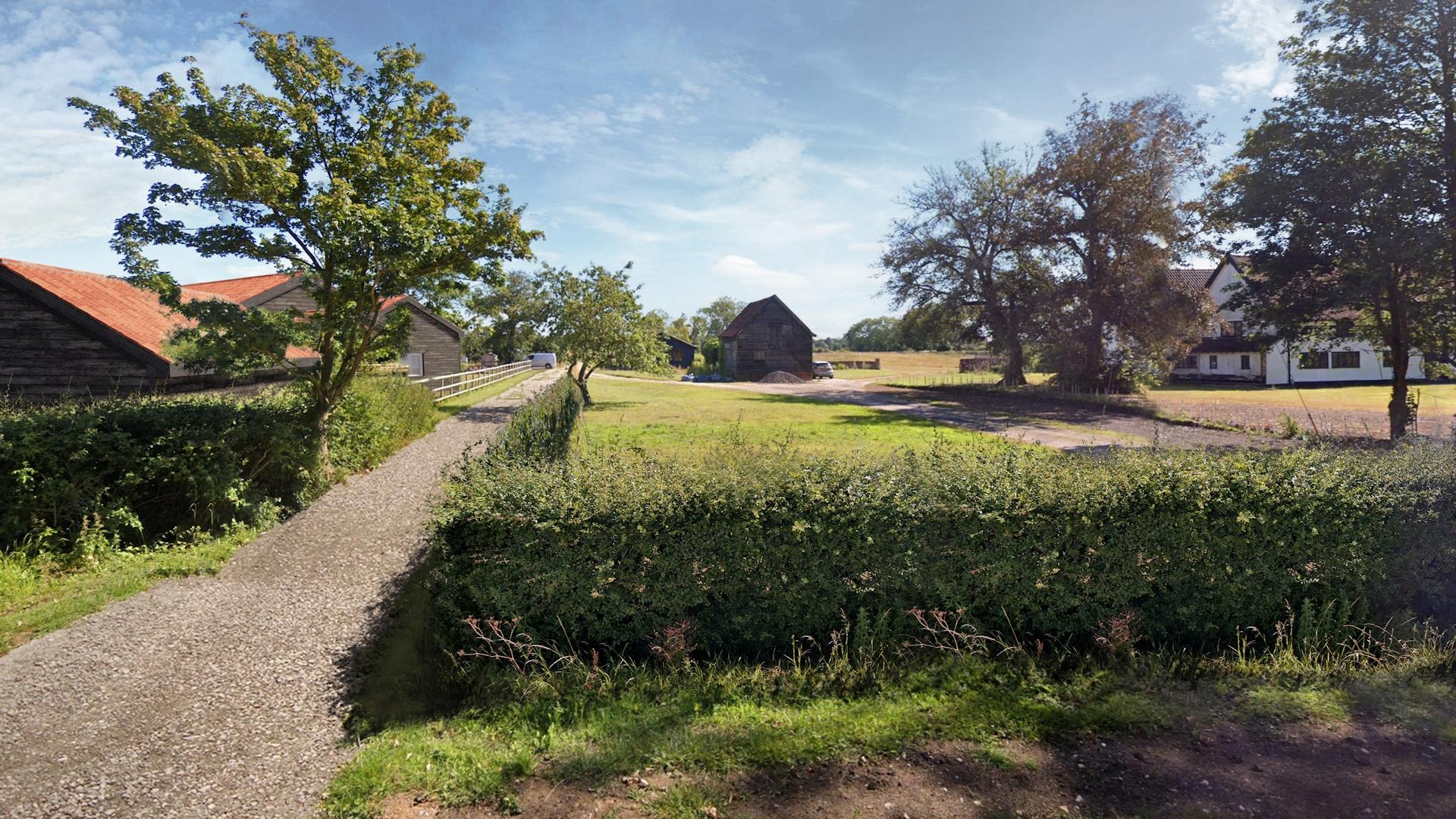

Alan Ambrose Posted May 19, 2023 Author Posted May 19, 2023 (edited) >>> but next time one pops up I’ll share the details. Thanks for that. It's this sort of thing, of course, where the barn-style building on the left is 'CGI' and superimposed: Edited May 19, 2023 by Alan Ambrose

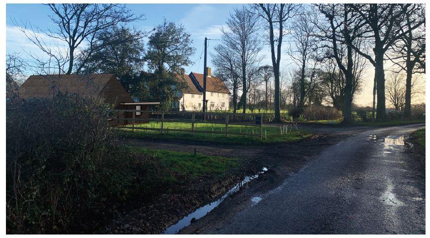

Alan Ambrose Posted July 14, 2023 Author Posted July 14, 2023 (edited) OK just to report back - for anyone else needing these kind of services. I used these guys: https://www.fiverr.com/quark_visuals - and they we're professional and reasonably priced. I was careful to write a 8-page brief specifying my objectives and the exact viewpoints and another 7-page brief on materials (lots of images in both of these). They were careful to do quick mock-up images to verify the content / viewpoints etc which I thought was professional. I supplied the CAD models from Fusion (actually in sketch-up format) and the block plan drawings for positioning. The objective wasn't to make the whole thing 100% photo realistic (actually better so the split between what is rendered and what is original image is clear) but to demonstrate what the casual viewer would see looking at our proposed build in relation to the farmhouse 'heritage asset'. There was a bit of flexibility on both sides - I asked them to add a driveway and adjust some colours and I put up with some small image artifacts (which are inevitable with this kind of image manipulation). I chose to build on top of Google street view images (which were fortunate as they were taken on a sunny day). These are not the best quality, but it does allows the LPA to verify the images. Here's the kind of thing - our proposed building is on the left: Edited July 14, 2023 by Alan Ambrose 1
