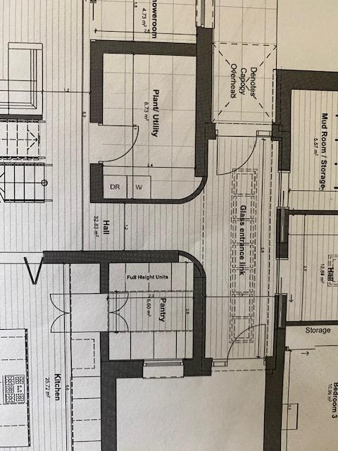

Meabh Posted May 18, 2023 Posted May 18, 2023 We are doing groundwork for a passive raft and the walls will be ICF. ASHP will be located outside the pantry window area) which is about 5/6m from the plant room. Opinions on how to install the flow/return pipe please? Option 1 - pre-insulated twin pipe under the raft insulation but with a 90 degree fixing to get the pipe up to the plant room or Option 2 - through the walls. Many thanks

Conor Posted May 18, 2023 Posted May 18, 2023 We cored a 100mm hole in our wall and ran the pipes plus power / data cable through it in individual ducts, foamed it up after. Then they all go through the outer insulation layer of the wall, finally rendered over. Only bit of insualtion actually needed we're for the flexy hoses coming out from the wall to the unit.
JohnMo Posted May 18, 2023 Posted May 18, 2023 Ours ended up being done a year after the house was complete. Converted to 28mm copper before coming up the wall. Then core drilled 2x 50mm holes, placed copper tube central in the holes (slight upwards to allow self bleeding) and used expanding airtight foam to keep in place. And then sealed the ends at the wall with sealant. Then used external 19mm insulation.
HughF Posted May 18, 2023 Posted May 18, 2023 The 90 degree elbows for the insulated twin stuff are not cheap... Something to bear in mind.
