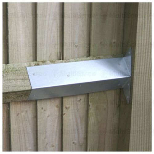

WWilts Posted May 17, 2023 Share Posted May 17, 2023 90 degree corners no problem. Slotted fence posts with T&G panels. How to deal with odd angles? How to get/improvise fence posts? Link to comment Share on other sites More sharing options...
Discoeye Posted May 17, 2023 Share Posted May 17, 2023 Have a look at fence cant rails to use as posts. 1 Link to comment Share on other sites More sharing options...
JohnMo Posted May 18, 2023 Share Posted May 18, 2023 Maybe not the best fencing option for the job at hand. Or change the shape of the fence line so you close to 90 degree angles. Or use round posts at the corners and just notch a flat at any angle you want. 1 Link to comment Share on other sites More sharing options...
Dave Jones Posted May 18, 2023 Share Posted May 18, 2023 featheredge it, angles are easy to accomodate. 1 Link to comment Share on other sites More sharing options...
Temp Posted May 18, 2023 Share Posted May 18, 2023 One option is to notch the posts so the rails go into the post. Taper the rails so they don't have to be a precise angle. Probably rots quicker... https://www.hooverfence.com/how-to-install-fence-panels-at-odd-angles Or perhaps bend your own arris rail brackets. Commercial ones are typically 90 degree.. 1 Link to comment Share on other sites More sharing options...
WWilts Posted June 4, 2023 Author Share Posted June 4, 2023 Reporting back. Used galvanised fence clips. Easy to angle any which way. Time will tell how many need replacing how quickly. Link to comment Share on other sites More sharing options...
