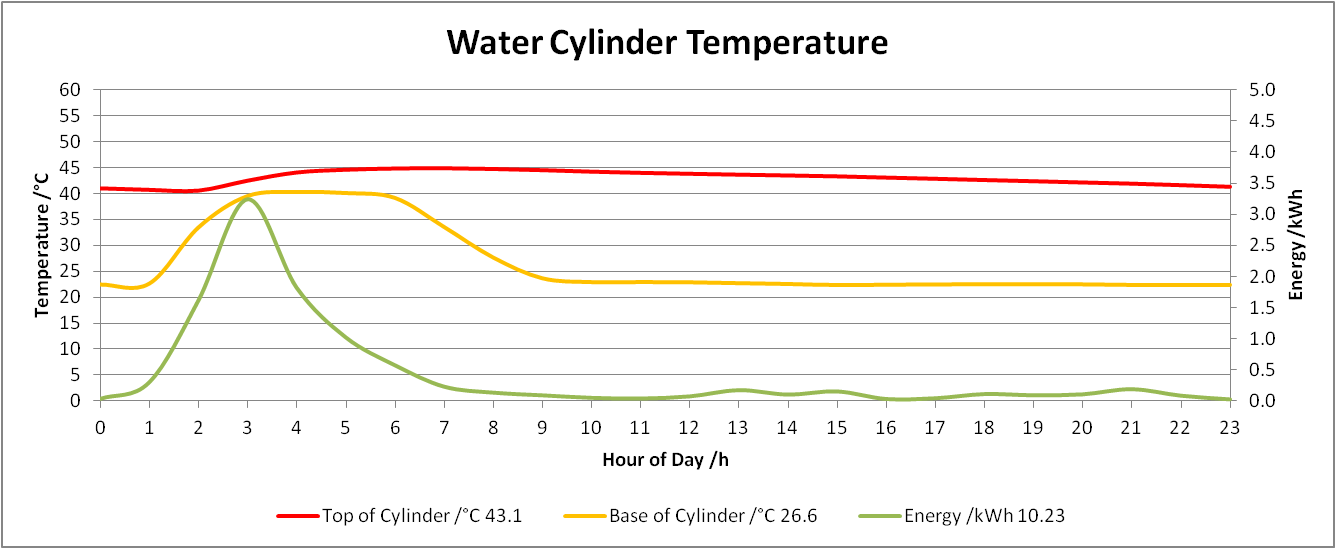

Here is what happens to my 200lt, E7 cylinder.
Where is the element located @SteamyTea ?

It is a standard E7 cylinder, so almost at the base.
There is a secondary element at the top, but that was not used.
Since I collected that data, I have changed the timings so that rather than heat at the beginning of the E7 window, it heats at the end of it. Mainly did that because for a couple of hours it was loosing heat to the house, and as I like a bath in the morning (decided I actually dislike showers and only use them to get work grub off) I wait till the water stops heating, then draw off a bath full, then they cylinder is at a lower temperature, so less losses.
I really should start to monitor it again, maybe with it's own energy monitor as the kWh trace included all usage, so fridge, kettle (I am a very early riser) washing machine etc.

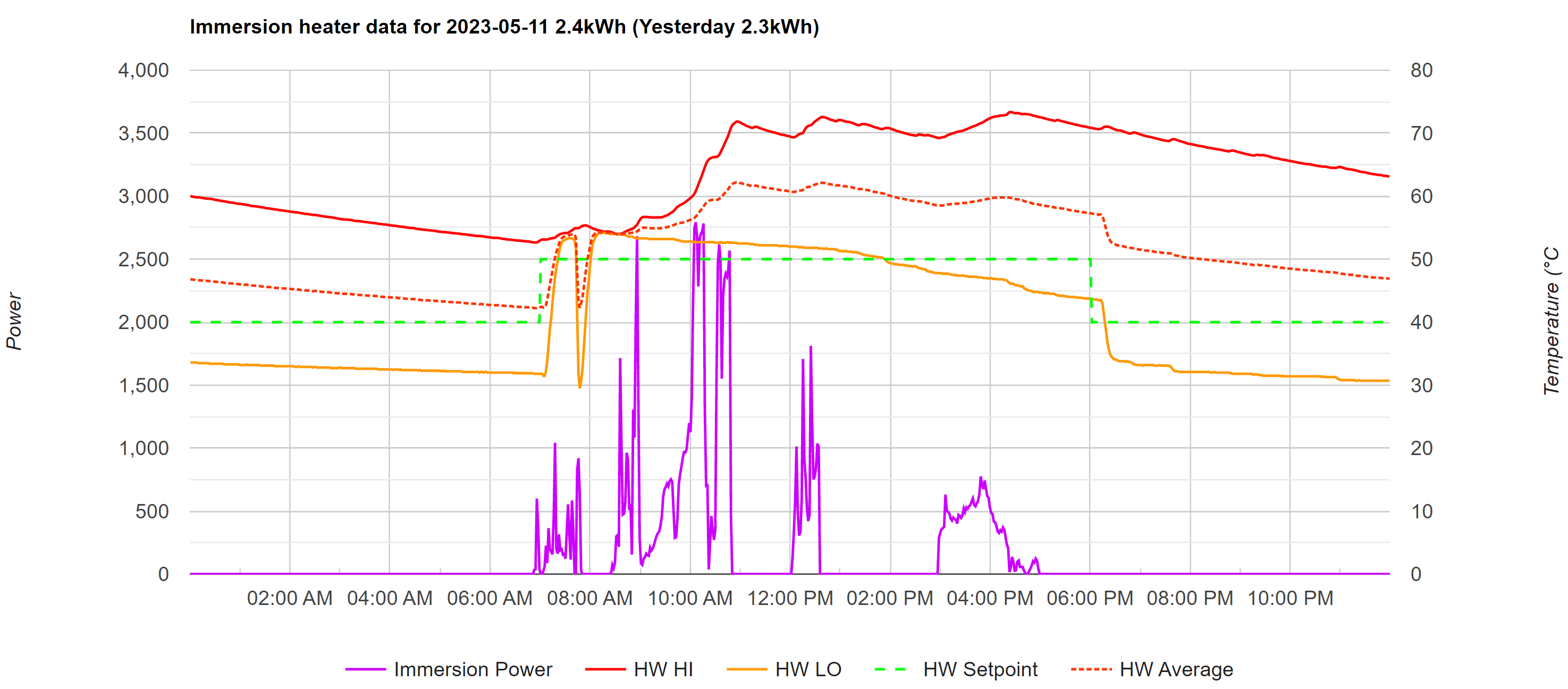

I wish, but sadly no. The immersion element is exactly half the height of the cylinder which is 1200mm and by the evening of a good sunny day it can be 70+ degrees (HW HI):
The lower sensor (HW LO) has "no idea" about this and continues to cool off albeit more slowly as per Newton's law of cooling.
