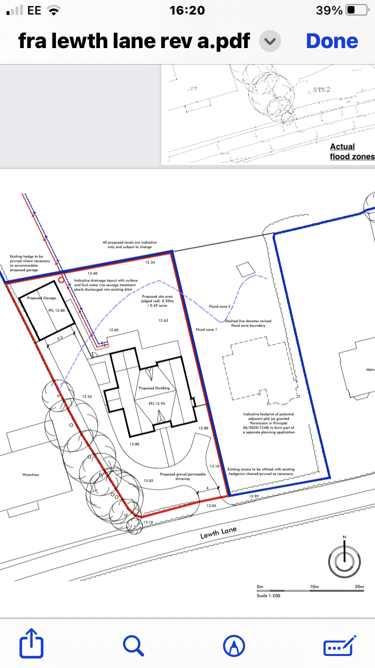

Bluebaron Posted May 8, 2023 Posted May 8, 2023 I’m looking at planning for a single dwelling in flood zone two. The government strategy states that I am exempt sequential testing under minor development status. see here: https://www.gov.uk/guidance/flood-risk-assessment-the-sequential-test-for-applicants However, Reigate and Banstead Council say they will still apply the sequential test for all applications in floodplain 2. also that the are they use is the entire borough some 130sqkm and so I’ve got no chance in passing it. Do I have any right to appeal that they are going against government guidelines? thanks

Bluebaron Posted May 9, 2023 Author Posted May 9, 2023 (edited) Thanks for advice, im at RH6 just north of LGW. As you can see below the flood plain is quite extensive I’m the red circle. im not sure how effective an arguement it would be but I’m currently 1 mile north of the airport where I walk to work. And overlook fields. Could I argue that I need a plot walkable to LGW? 🤔 sounds like a stretch but using the paddock agreement above might hold some weight? Edited May 9, 2023 by Bluebaron

Bluebaron Posted May 9, 2023 Author Posted May 9, 2023 I think my map was drawn up in the 1960’s, I do have a flood report from my neighbour two years ago if anyone is interested. its not about mitigating the risk to a new development. It’s purely about whether or not a difference/better site is available. Flood Assessment-grasmere.pdf
