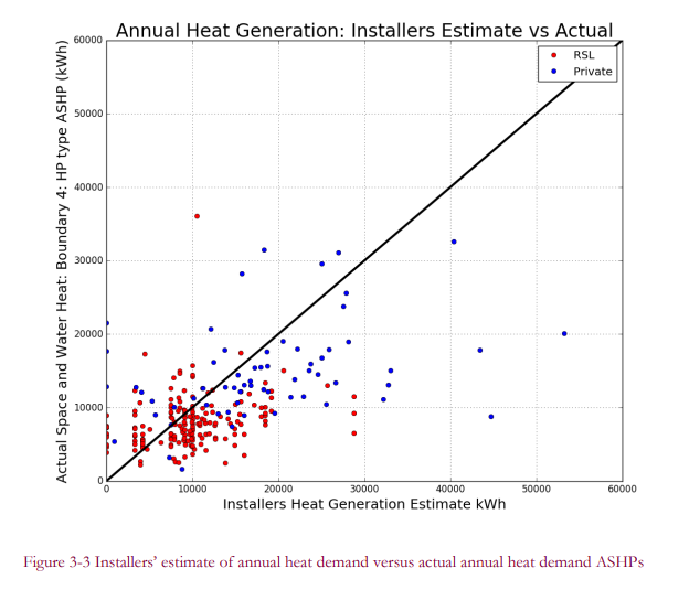

In this thread Id like to suggest a discussion of system engineering amendments for: whole house sizing (particularly to avoid over-sizing), and the DHW tank.  The first because it has so many knock on effects, the second because its often the biggest single identifiable change other than the HP itself, and quite likely the one causing most disruption.  Im throwing in ideas here, which seem reasonable from an engineering perspective.  I don't claim to be an expert (because I'm not), so I may have missed something fundamental.  I do, however, claim to be capable of understanding logical arguments put by experts if they make them.
1.    Whole house sizing
This is fundamental.  Get it too low and the customer is cold, get it too high and the system performance is compromised, you may need an otherwise unnecessary buffer tank which is likely to compromise performance, the DHW and primary feeds may need upgrading unnecessarily, and it costs more.
This is what we achieve using the current method (https://assets.publishing.service.gov.uk/government/uploads/system/uploads/attachment_data/file/606834/Report_on_compliance_with_MCS_installation_standards_v32.pdf),
ie quite frequently a 2 fold oversizing or worse, less frequently undersizing.  Its pretty poor.  Not surprising really, much of the fabric on which surveyors base their estimates is not visible, so they have to make assumptions which are unlikely to be accurate (particularly if they don't listen to the customer when he tells them how the house construction has evolved!)
So why dont we do the whole house sizing by simply measuring demand, or at least use demand as a sense check?  At its simplest its really, really, really simple to take annual gas (or oil) consumption and from that work out the load at any chosen design temperature, and thus the required peak output.   Obviously a few questions are required to determine how the customer uses the house, but at its root its real world data thats easily obtained and measures the right thing.
Now there are more sophisticated methods than this crude calculation, using smart meter readings (only applicable for gas of course) or making a specific measurement with sensors and calibrated heat sources, but I would suspect that the simple method, supported by a few questions that the householder has to answer, may well be good enough, and almost certainly better than we currently manage.  For my house this calculation comes out about 8.5kW, against a measured peak of 7.5kW at design OAT.  Meanwhile surveyors (two of them) got to 16kW (because they ignored fabric upgrades that I told them about and double counted room to room losses) and if I use MCS assumptions but put in the fabric upgrades, I get to 10.5kW.
I reiterate - get this right (which currently, based on the evidence above, we dont) and lots of other problems disappear
