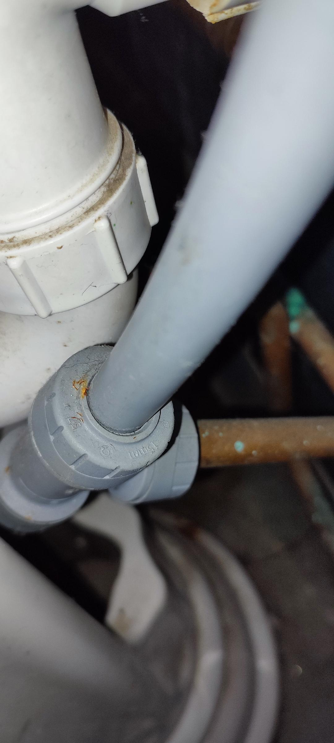

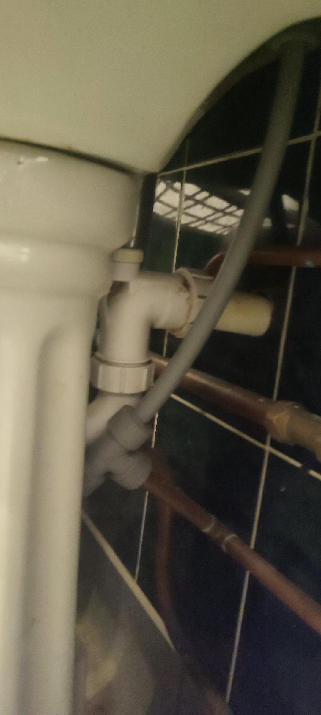

Question Posted April 22, 2023 Posted April 22, 2023 (edited) I have a sink and want to add an isolating valve for the taps. See photos. The 15mm plastic pipes are at least 20 years old or probably 30- 40 years old. Should I get a (a) plastic isolating valve and not worry about what brand it is. In other words, different brands are compatible with each other. (b) plastic isolating value of a particular brand (if so, please tell me what brand) (c) copper isolating valve, and if so do I get a pushfit or compression or either. (d) do not touch it. (the plastic pipes go under the floor). Grateful for any advice. Edited April 22, 2023 by Question
Question Posted April 22, 2023 Author Posted April 22, 2023 I think I can answer my own question. The cap of the T junction has the distinctive polyplumb brand markings. So I'll get a polyplumb isolator.
Iceverge Posted April 22, 2023 Posted April 22, 2023 I did away with all the isolating valves when I replumbed our house. Considering how irregularly they'll be needed the inconvenience of turning off the mains for an hour while I fix a tap really wasn't worth the extra point of failure or cost in my opinion.
Nickfromwales Posted April 22, 2023 Posted April 22, 2023 Yup. Polyplumb. Some of these exact fittings still available on eBay.
Question Posted April 23, 2023 Author Posted April 23, 2023 Thanks very much for your comments. This came up, as I have to change a washer in a tap. I don't think the plastic piping is polyplumb, as there are no markings on the pipes. So there is already a mix of different brands, the T junction being polyplumb. The whole thing has been in place and fine for 20 years. The polyplumb T junction was probably added by a plumber who was extending the water for an extension. So I'll just leave it alone and switch off the water from the main to change the washer, like Iceverge suggested. 1
