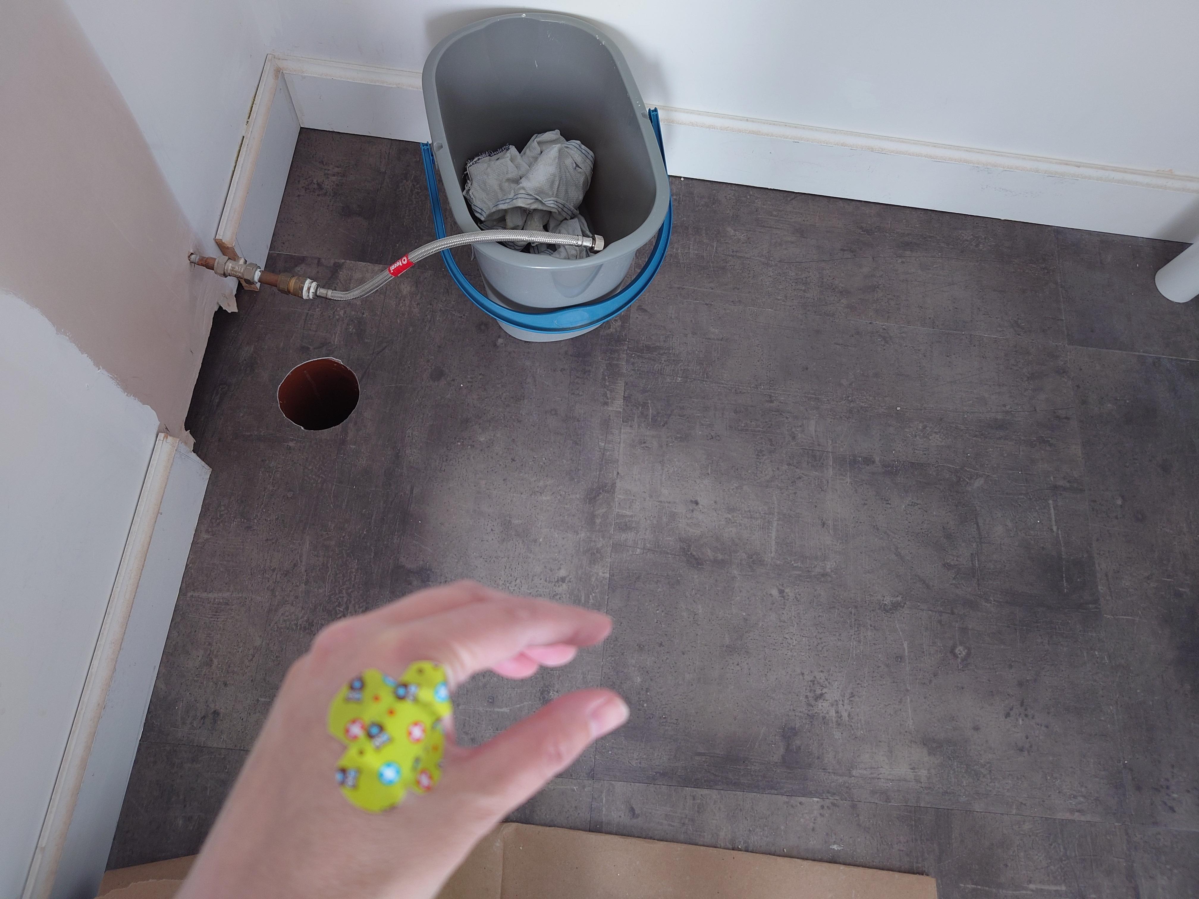

canalsiderenovation Posted April 13, 2023 Posted April 13, 2023 Long story short, taken out toilet which I've never liked (huge argument with other half about how I can be offended by the old loo). The new one is slightly smaller so need to replace a few of the LVT tiles. Got old ones up, old glue off, purchased adhesive and sorted nice templates of what I need to cut. Without risking taking my fingers off - is there a special type of tool I should be using or knife? Had a little practice and my god it's tough stuff (or I'm just weak)! Getting grief about how I've created lots of other jobs now and I want to prove it's really simple and we don't need the flooring man to come back at more cost. And let's face it at some point it's inevitable I'll have to replace a tile and this is just good learning.

ProDave Posted April 14, 2023 Posted April 14, 2023 Use a good quality metal knife with a good new blade, don't even think about it with a cheap plastic knife. Don't hold the knife with your finger on the blade, just hold the handle. +1 for tile the whole floor then put the loo back. Fewer cuts less to get wrong etc.
joe90 Posted April 14, 2023 Posted April 14, 2023 10 minutes ago, ProDave said: Use a good quality metal knife with a good new blade, +1, the blades go blunt quite quickly, new blade only.
S2D2 Posted April 14, 2023 Posted April 14, 2023 If it's the really rigid boards you can just score with a Stanley knife as deep as you can then flex the tile along the line and it will open up the cut and snap cleanly. I only did this with straight cuts though, not a c shape. Pliers help if it's just a small piece needs snapping off depending where the score line ends up on each tile, grip the waste piece as you will damage it.
Nestor Posted April 14, 2023 Posted April 14, 2023 I have just fitted 60sqm of Parador 914mm x 457mm x 6mm LVT and used a table saw, circular saw and jigsaw. Tile first before fitting the WC as others have mentioned. If using a Stanley do a couple of test strips first.
canalsiderenovation Posted April 14, 2023 Author Posted April 14, 2023 Thanks I've ordered a new decent knife and a pack of new blades and will practice first. Luckily our flooring company sent out about 20 extra packs of flooring too many so we have absolutely lots spare Incase I make a dogs dinner out of it. Not sure how I'm going to cut out the circle of the waste in the floor but it doesn't matter if it's a bit rough as we won't see it. 1
Nick Thomas Posted April 14, 2023 Posted April 14, 2023 If it's anything like the "rigid core" floating LVT tiles, scoring it didn't work well for me with curved cuts. I just used a jigsaw 🤷♂️, and a dremel on some particularly awkward bits. As the cutting blade heats up, it can start melting the vinyl and get gummed up, but not the end of the world for a few small cuts in inconspicuous areas.
canalsiderenovation Posted April 16, 2023 Author Posted April 16, 2023 Success ready for us to fit the new toilet tomorrow. Minor injury but I did a pretty decent job even though I'm covered in soudal adhesive. 1
