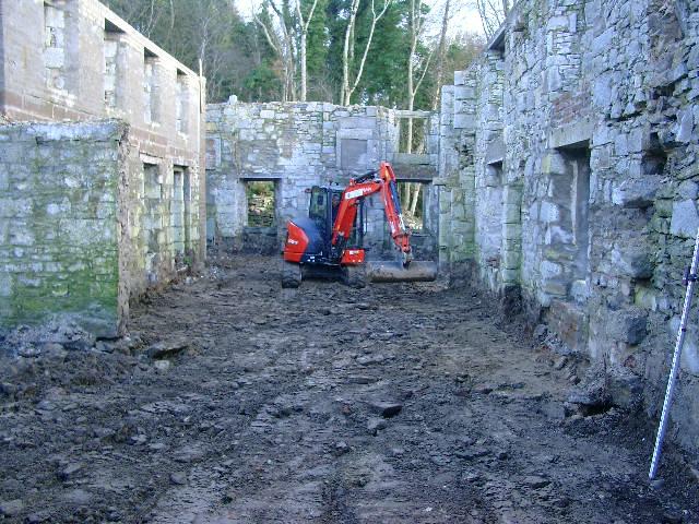

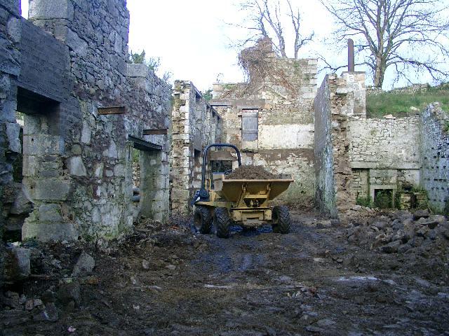

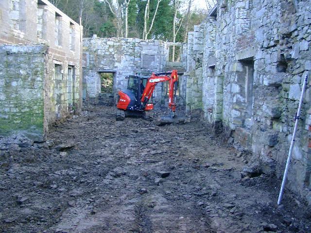

scottishjohn Posted April 11, 2023 Posted April 11, 2023 when i last visited this subject in early 2020 -after I bought my plot i was told that if it had been empty for 10years --then it was a zero vate rebuild is this still the case finally getting close to getting started on the project all we have now is some of the outer facades -

scottishjohn Posted April 11, 2023 Author Posted April 11, 2023 this where it gets sticky al I have is the outer walls -- nothing else and some of outer walls ahve gone as well I
joth Posted April 11, 2023 Posted April 11, 2023 Yeah that's not a full demo so you're clearly in the refurbishment rather than rebuild rules. I suggest reading them in detail but my recollection is you need to gather some solid evidence of it never being occupied, you need to employ a single main contractor for supply+labour, and they need to see the site is unoccupied on the day that start work.
