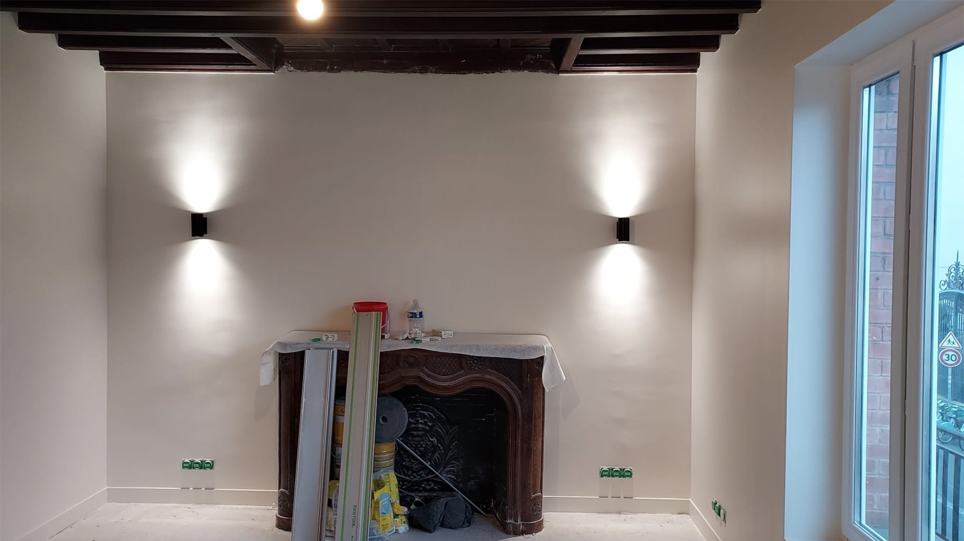

As some of you here may remember, what will be my library/piano room (the main room of the house, really) overlooks a fairly noisy two-way road. Newer double-glazing has helped, as has the heat insulation we chose (air + 14.5cm of BioFib Trio (hemp+cotton+linen) + air + 18mm plaster), but it's still not quite what I was hoping for. Now, that wall will have built-in bookcases - really my last line of defense at this point.
What should I do in order to maximize how much the bookcases will help with sound reduction?
1. What material to use on the back? (Cork behind wood maybe?)
2. I take the further up the bookcases go, the better, but I can't go flush against the ceiling, as there is moulding (which I am very happy the workers managed to preserve).
(Also, does it make sense to add sound-reduction drapes? I will have shutters on the outside. I'm a bit concerned about drapes gathering dust (I have allergies).)
I'm not there right now, so this is the best I can do:
May be an image of indoor
May be an image of chandelier and indoor
It's the wall with the window here - it's on the double room's long side. The bookcases should go along the entire length. I am a little concerned that the contractor may have put the lights a little too close to the wall, though it is true that I am planning on rather shallow bookcases (about 22 or 23cm on the inside).

Books will be good. They are dense but also loose which will absorb some sound.
The noise will mostly be through the window. Heavy curtains will help a bit. Get blackout ones and the pores are closed  and one side at least does not gather dust. Heavy is good.
Any sound through the walls will be low frequency from heavy vehicles. The books are good. Anything dense hanging on the wall will help a bit.
Noise gets through gaps, so it is a case of the 'weakest link'

The main source of bother is heavy vehicles (buses mostly) but also motorcycles. One can't hear people talk on the street (where one can from the kitchen, which also got new, supposedly high-grade double-glazing, but where the insulation is much thinner - a few cm of BioFib + some cm of reflective insulation).
So, does backing up the bookcases with cork make sense? Perhaps one continuous sheet? Or should I just get a solid wooden back for the bookcases (as opposed to some thin IKEA-style panel)? Or does it not matter much at all?

From the look of the photos, it looks like the house is of traditional masonry construction, so the walls should already be pretty effective against airborne sound - and I presume that the BioFib is internal wall insulation, which will have boosted that further and broadened the frequency range being damped. In which case I suspect a bookcase would only make a marginal difference.
It looks like you could be on the top floor; if so, did you do anything to reduce sound transmission through the ceiling?
Windows are likely a weak point unless you specifically chose double glazing units & frames with enhanced sound-resistant specifications, rather than just new double glazing.
And, as @saveasteading says, noise also get through gaps.

The rumble from heavy traffic is the whole building trembling. Covering the back of the bookcase will make a difference  but not much.
All the furnishings will help, and the weight of the bookcase and other furniture may stiffen the floor and help too.
A tapestry would possibly be the biggest help....or drapes.

Not to beat a dead horse (an activity at cross-purposes with noise reduction), but don't we need:
- mass (books)
- decoupling (bookcase that is only loosely attached to walls, and that only at a few points)
- absorption (provided by something like, well, cork, or rubber, or acoustic foam, between the bookcase and the wall)?
