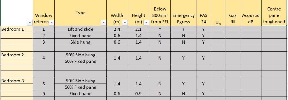

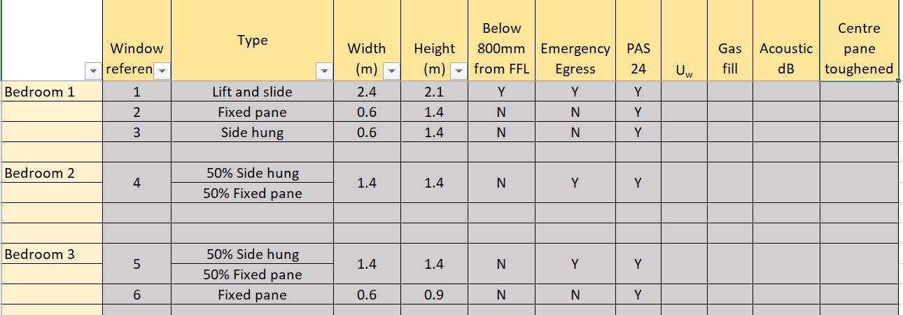

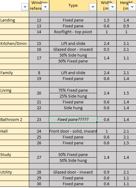

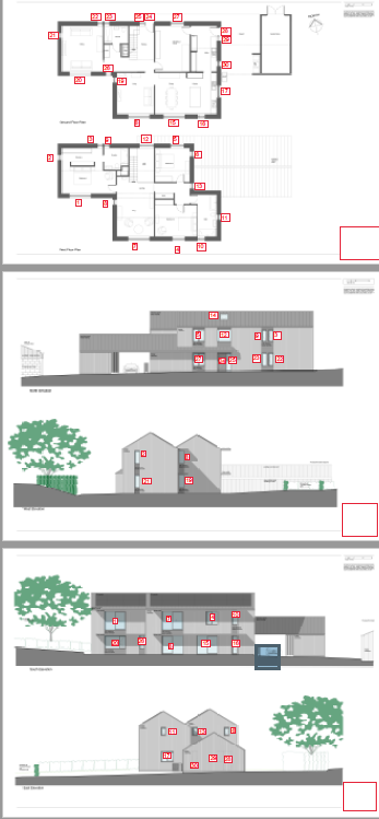

Furnace Posted April 3, 2023 Share Posted April 3, 2023 (edited) In order to avoid endless tail chasing when seeking quotes, I'm keen to present all the information required so quotes can be fairly compared. Having read the sticky, I've put together the 2 attached docs. window_schedule_plans.pdfwindow_schedule.pdf I also need to add: Gas filled Any coatings Glazing build-up (e.g. 4-16-4-16-4) Aluclad, aluminium or wood. Inward/outward/tilt'n'turn Delivery and installation Number of compression seals (particularly on the weather side of the locking mechanism) I'm inclined to go Aluclad, but have not particular view on the other choices. I've only encountered inward/tilty jobs when in Europe and have no experience of 'living' with them. As an aside, I'm curious about some windows that don't have a compression seal on the weather side of the locking mechanism. This seems a bit daft to me? All suggestions most welcome. Edited April 3, 2023 by Furnace added question 1 Link to comment Share on other sites More sharing options...
MikeSharp01 Posted April 3, 2023 Share Posted April 3, 2023 What you have looks good, you need to give them enough so that they can get it right first time rather than change things when they find out that your openings are not what they assumed in terms of build up. So other things to think about including are: Making sure the quote contains the Uw values for every window - you need to meet PH standard there. Specifying if the installer is responsible for attaching air tight membrane tape and / or connecting to the airtight layer adjacent to the window. Which windows are designated escape windows, if any. Which door(s) is(are) your accessible door(s) for BC purposes. If you have section drawings of your openings that will help them, and stop them coming back and upping the quote when they find a difficult opening. Including / not including such things as compriband on the external connection to the opening. Which foam to use when sealing around the windows - You can say a brand and /or say it should have similar properties to a brand. The finished colour(s) inside and out (Some colours are standard others cost), also if coastal location you will need a marine grade finish. Do you want secured by design as standard on all doors / windows on GF - this affects the glass build up and the locking. If you are expecting the windows to be installed with access to both sides. IE will they work from the inside or both sides. (On ours the windows are bigger in their boxes than the surrounding tile hanging so they need to go in from the inside although you can work on the outside.) Section drawings will show this to them. What is access like to the the site - can they get a lorry close and / or a window robot around all sides. Is there / will there be scaffolding - window robot then no good. Hope that helps. 1 Link to comment Share on other sites More sharing options...
nod Posted April 3, 2023 Share Posted April 3, 2023 You need to get them to stick to YOUR numbering Window suppers have a habit of adding there own numbering or get to say window 5 and put x 2 Looks crystal clear to me 1 Link to comment Share on other sites More sharing options...

craig Posted April 3, 2023 Share Posted April 3, 2023 An excel sheet with the sizes quantities and types is usually good enough, window schedules are usually best and take away any ambiguity. If you can also specify what windows are below 800mm from FFL that will help, with any specific security requirements (i.e. SBD/Pas24, Emergency escape windows). The one thing to look out for with your quote is glazing (especially triple). Look out for the middle pane of glass being float glass and those that toughen the middle pane (more so on South East to South West windows). We did this with one of our suppliers for a while to match everyone else's price as it's very competitive and to be honest, you all like to do cost comparisons on m2 prices and it can be the difference between winning or losing a job. However, it's important to note that this is the number one way to save costs but it can cost you in the long term if it breaks (whether that be from slamming shut, thermal stress, or thermal fractures) the bill for this is left with you. We always did this with our Austrian supplier but not with our other suppliers - a lesson has been learnt. 1 Link to comment Share on other sites More sharing options...
Furnace Posted April 3, 2023 Author Share Posted April 3, 2023 (edited) 2 hours ago, craig said: Look out for the middle pane of glass being float glass and those that toughen the middle pane Not sure I understand. I'd imagined that glazing below 800mm needed to be toughened (inner pane only?), but all other glazing would be float. If any glazing breaks, surely that's my problem? Am I being dim? edit Is it that the centre pane of all TG units should be toughened because it's subject to greater thermal stress and therefore more vulnerable? Edited April 3, 2023 by Furnace Link to comment Share on other sites More sharing options...
craig Posted April 3, 2023 Share Posted April 3, 2023 Safety glazing should be inner and outer, no current regs re triple glazing. Yes, regarding middle pane and thermal stress. 1 Link to comment Share on other sites More sharing options...

Furnace Posted April 3, 2023 Author Share Posted April 3, 2023 @craigIs this the sort of thing that would make comparison easier and avoid to-ing anfd fro-ing? I'd also say I'd like a 'supply and fit' quote inclusive of fitting materials. Does that make sense? Link to comment Share on other sites More sharing options...

craig Posted April 3, 2023 Share Posted April 3, 2023 2 hours ago, Furnace said: @craigIs this the sort of thing that would make comparison easier and avoid to-ing anfd fro-ing? I'd also say I'd like a 'supply and fit' quote inclusive of fitting materials. Does that make sense? Looks good to me 👍 1 Link to comment Share on other sites More sharing options...
