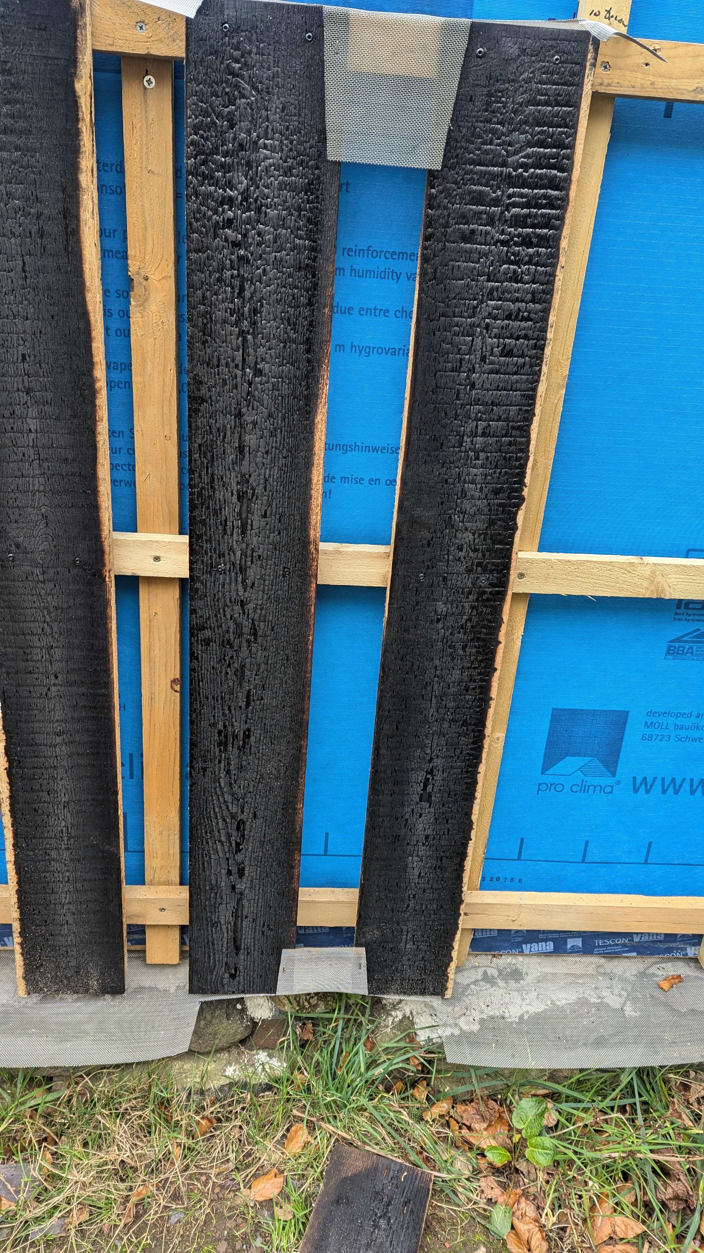

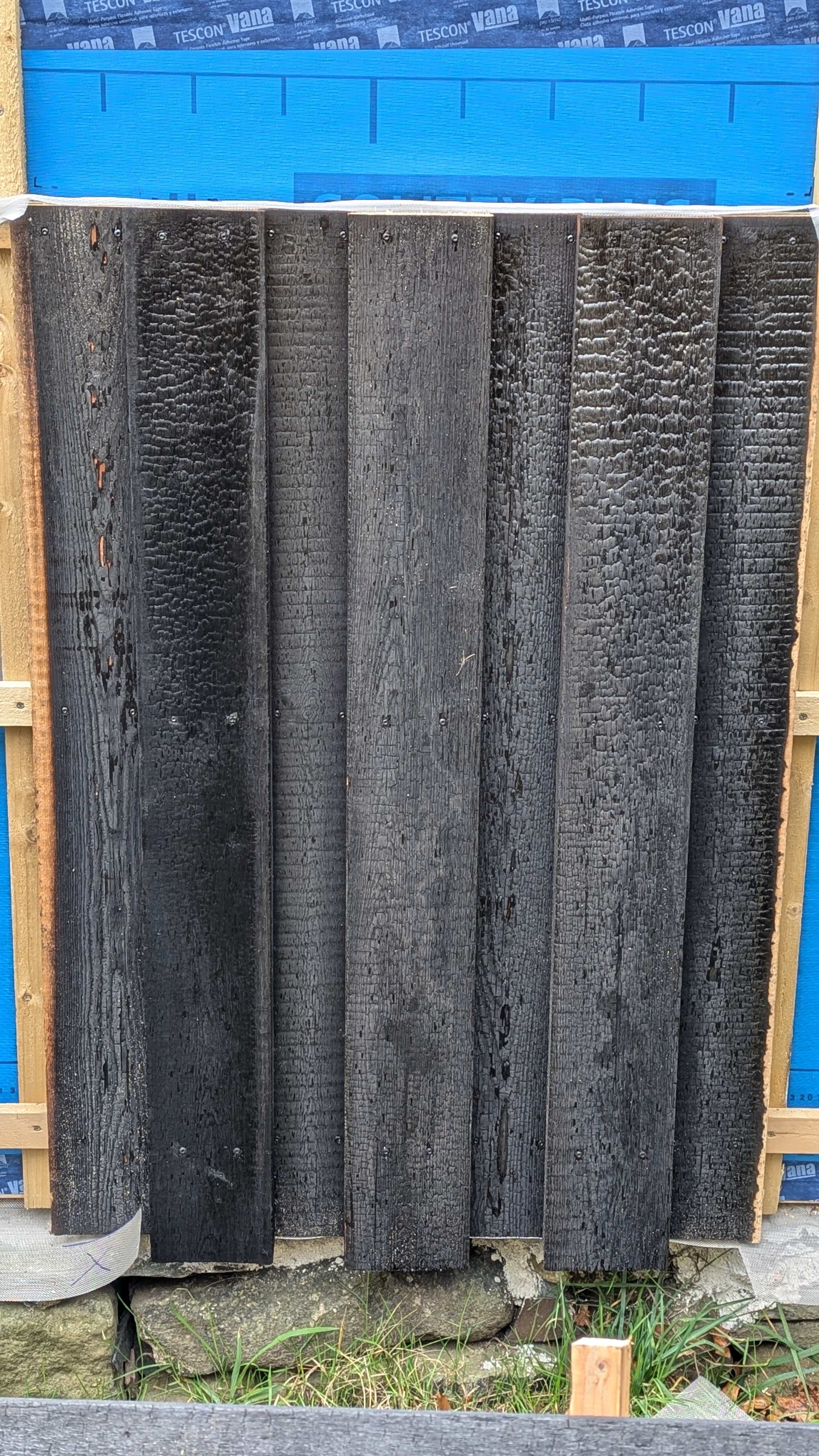

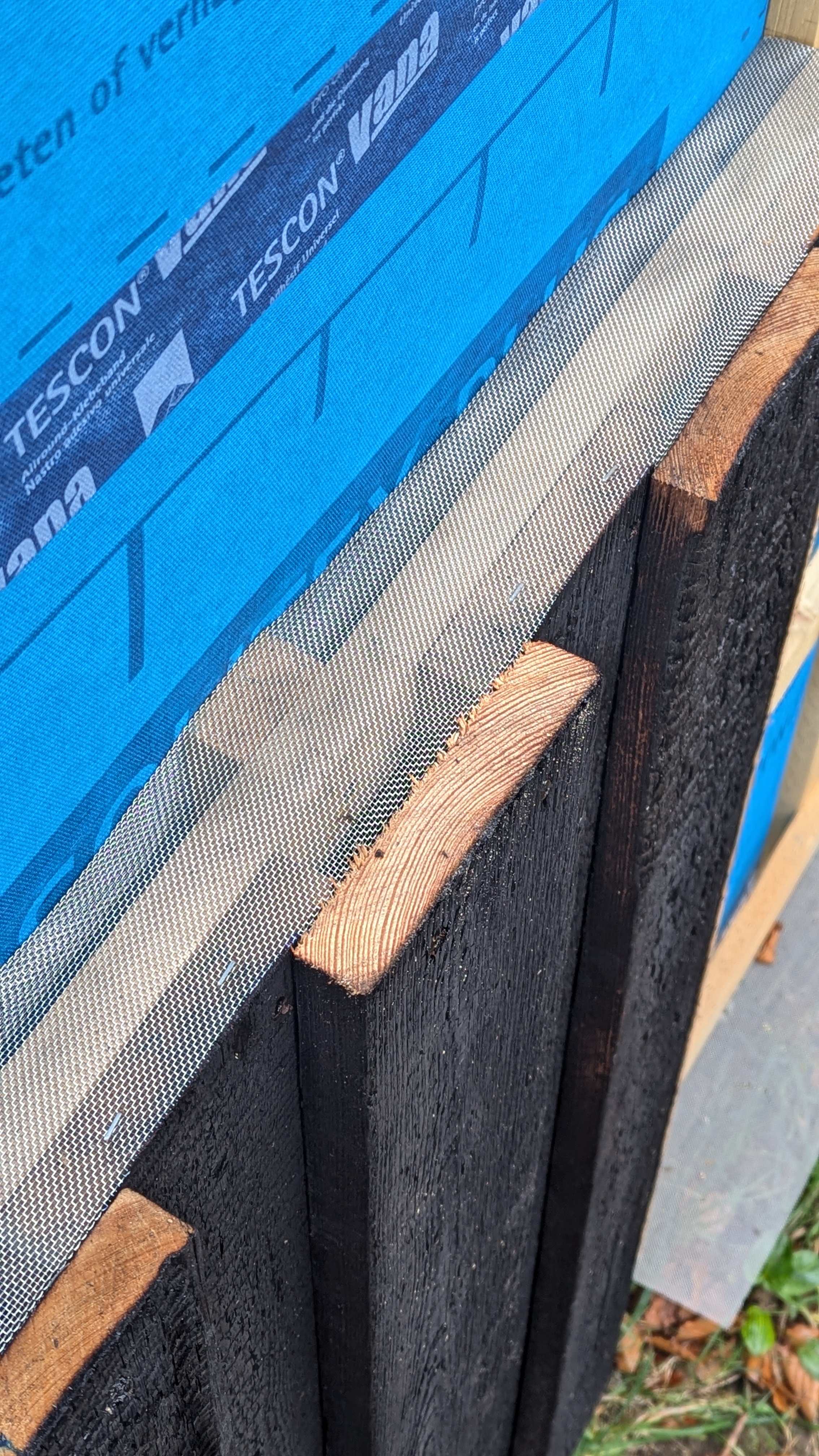

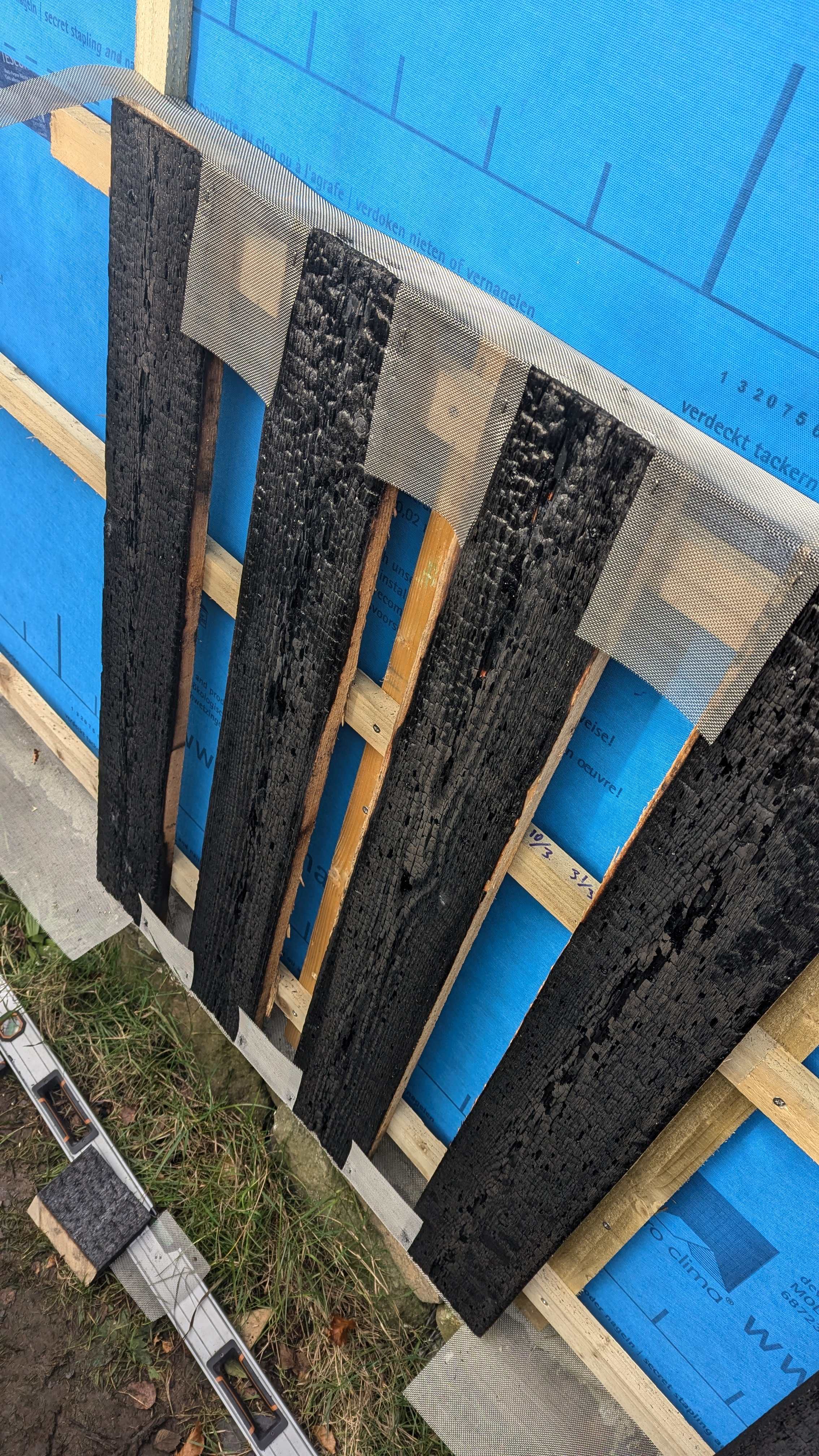

PlaneIron Posted November 14, 2024 Posted November 14, 2024 I thought I'd share my approach to wire mesh with board on board cladding. I couldn't find any real detail about this is trada publications or internet. Mesh is held behind the counterbattens or under a batten at the sill level, then folded over the first boards with a couple of staples to hold it in place. Where the mesh would show it's cut away and then the top board holds everything in place. Fairly quick, simple and relatively inexpensive for a roll of stainless mesh. 2
Flyingpig Posted February 16, 2025 Posted February 16, 2025 Hi, thanks for posting these photos, this is just what I need to do with my board on board cladding.... Question - how did you finisih at top to prevents bugs and allow ventilation? Cheers
Alan Ambrose Posted February 16, 2025 Posted February 16, 2025 +1 for doing this carefully. We had a mouse last winter and on investigation I found there was no mesh at the bottom of the cladding on our barn conversion. So, a hard job down on my knees for a few days and digging part of the earth away from the brick plinth in parts (the house is on sloping ground). Used ss mesh as images above and also ss brillo pad stuff for smaller holes - as it’s an old barn everything is a bit uneven and all over the place.
PlaneIron Posted April 27, 2025 Posted April 27, 2025 On 16/02/2025 at 13:08, Flyingpig said: Hi, thanks for posting these photos, this is just what I need to do with my board on board cladding.... Question - how did you finisih at top to prevents bugs and allow ventilation? Cheers Pretty much as the top part in the photos above. Trap some SS mesh in the vertical battens and fold over the inner vertical boarding. There's a little ledge under the eaves created by this approach which isn't ideal. The alternative would be to attach the ss mesh on the surface of the inner boards and run upwards to another fixing point but it's a lot more hassle.
