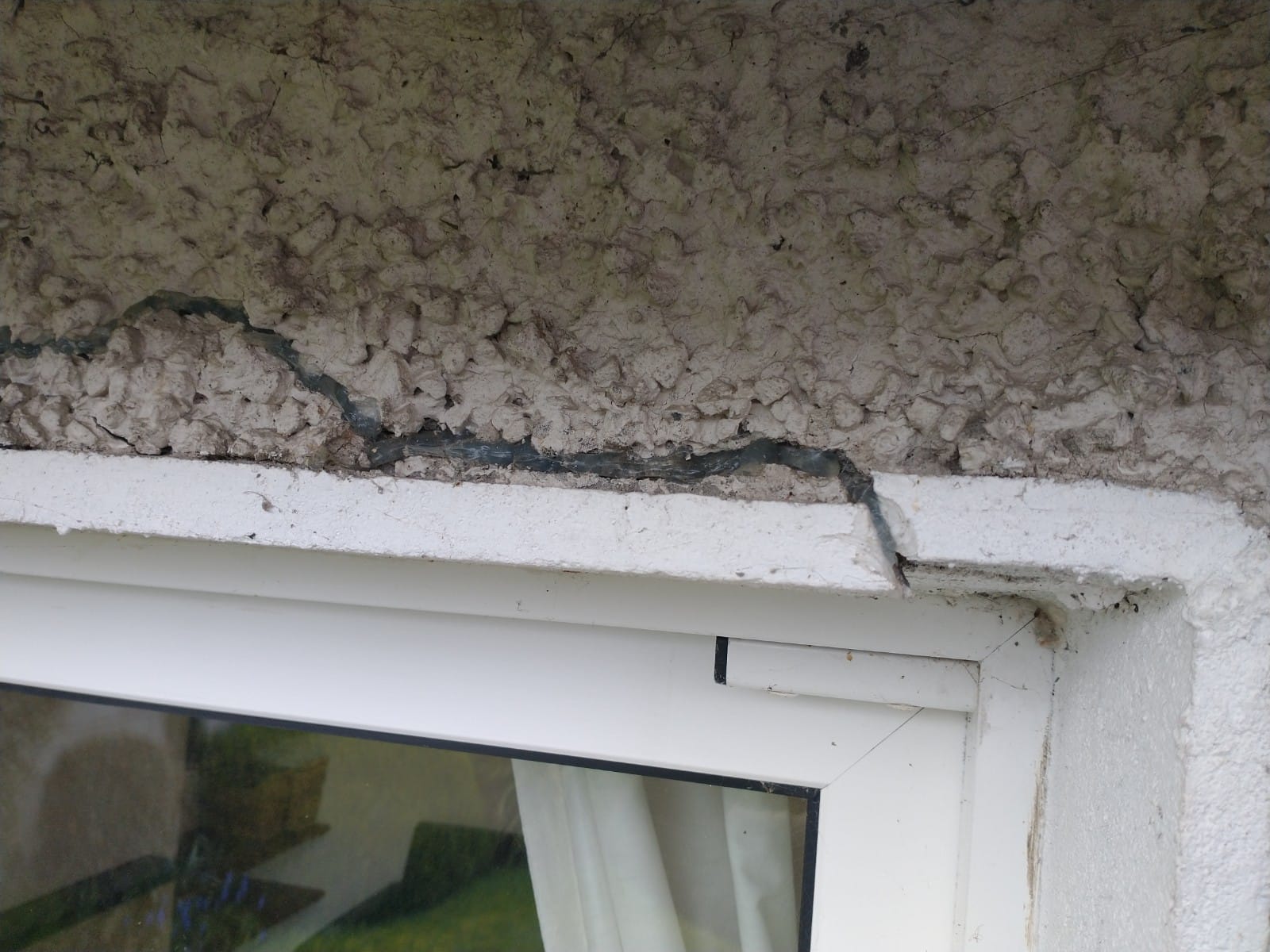

mickespite Posted March 26, 2023 Share Posted March 26, 2023 Looking at this house for sale and I've noticed there seems to be a cracked lintel over the patio door on the right if you zoom in. The pain of glass below has a wide crack so I'm guessing the door frame must be taking some of the load. there is a converted attic space above. potentially serious problem ? Easy to fix ? Link to comment Share on other sites More sharing options...
MikeGrahamT21 Posted March 27, 2023 Share Posted March 27, 2023 Do you know whether it’s a cavity property or solid wall? if it’s cavity there won’t be much load above on that outer leaf, certainly above my bungalow windows there are no lintels at the eaves on external leaf, my windows go right to the fascia though with nothing on top, I can see there is a small amount of masonry on this one, could just be render infill and maybe why it’s cracked 1 Link to comment Share on other sites More sharing options...
Dave Jones Posted March 27, 2023 Share Posted March 27, 2023 my guess would be the crack is evidence of no lintel. hard to tell but looks like a solid wall from the width, the added weight on the trusses when it was converted as loaded up that wall and it wasnt designed for it. Get a RICS survey so you (mortgage company) have someone to sue if it all goes pete tong in a years time. 1 Link to comment Share on other sites More sharing options...
mickespite Posted March 27, 2023 Author Share Posted March 27, 2023 Thanks guys. Its a cavity wall construction. Link to comment Share on other sites More sharing options...
johnhenstock83 Posted March 27, 2023 Share Posted March 27, 2023 in a cavity wall, the structural bit is always on the inside. the outside wall is not really holding any weight from above, so not that much to worry about. having said that, if I was you, I'd have it done properly, using a catnic lintel. 1 Link to comment Share on other sites More sharing options...

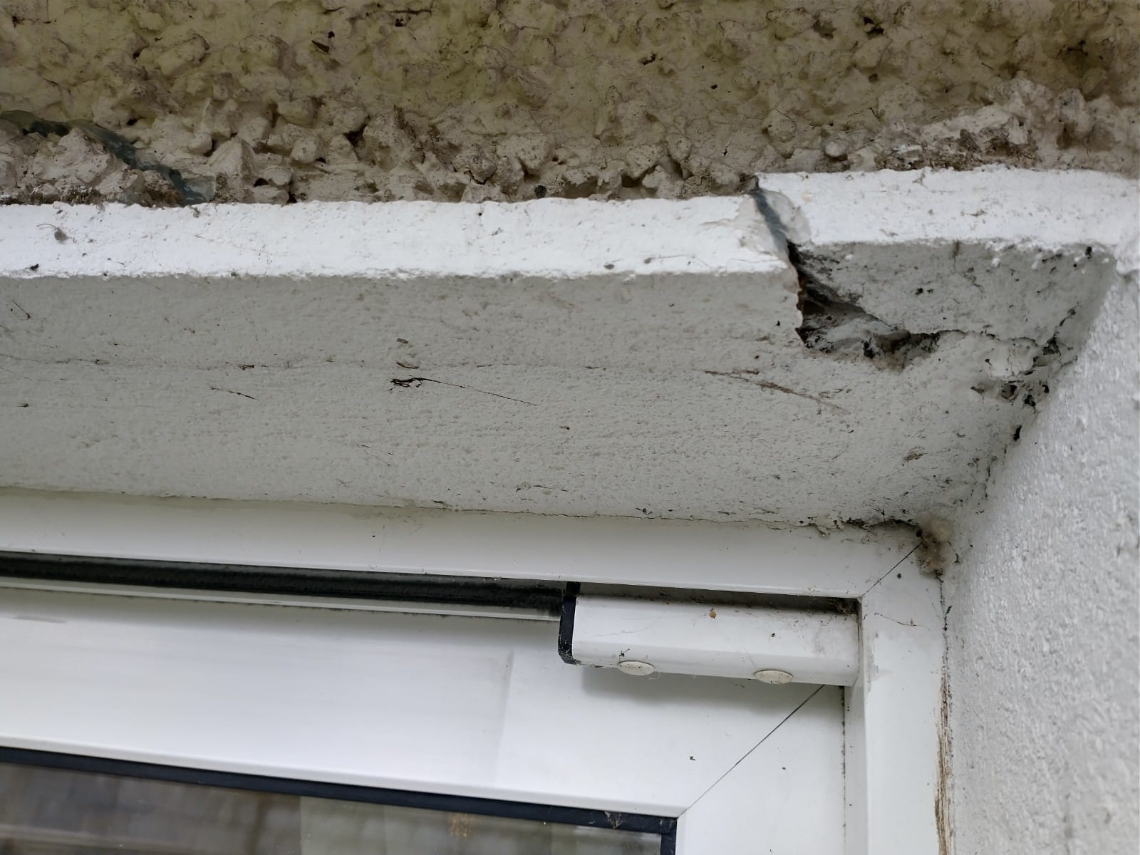

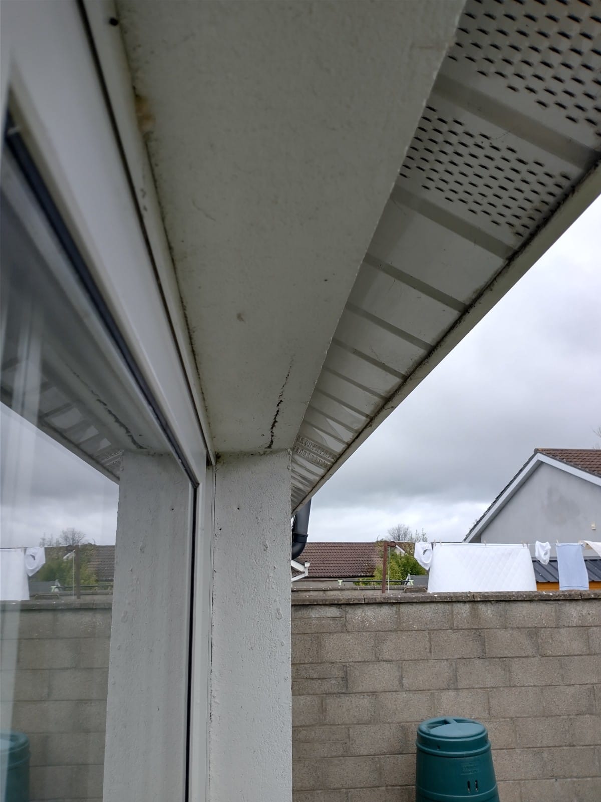

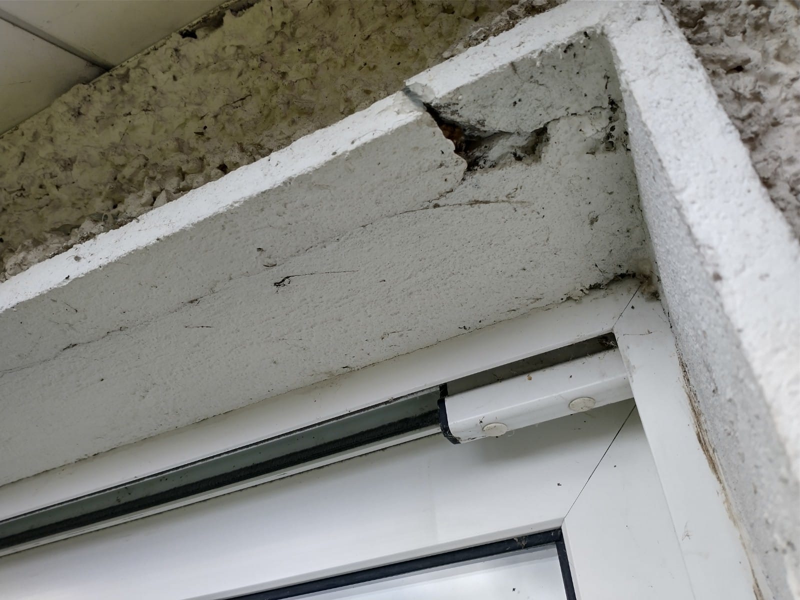

mickespite Posted April 1, 2023 Author Share Posted April 1, 2023 Few more pics. Apparently the crack has been there for many years. Link to comment Share on other sites More sharing options...
Nickfromwales Posted April 1, 2023 Share Posted April 1, 2023 The house may well have had timber windows there before the PVC was installed, and then the "cracks appeared". A lot of shit window companies mistakenly removed timber windows with central mullions which were load-bearing and incorporated into the load for the spans. Yes, a cause for concern and may be tricky to fix retrospectively. Try and negotiate a discount for this work, at least £5k, and also ask for the building regs paperwork for the room in roof, or the house needs to be valued minus that room ( so it would then only be classed as a ( valueless ) attic / storage space and not habitable space ). 1 Link to comment Share on other sites More sharing options...
