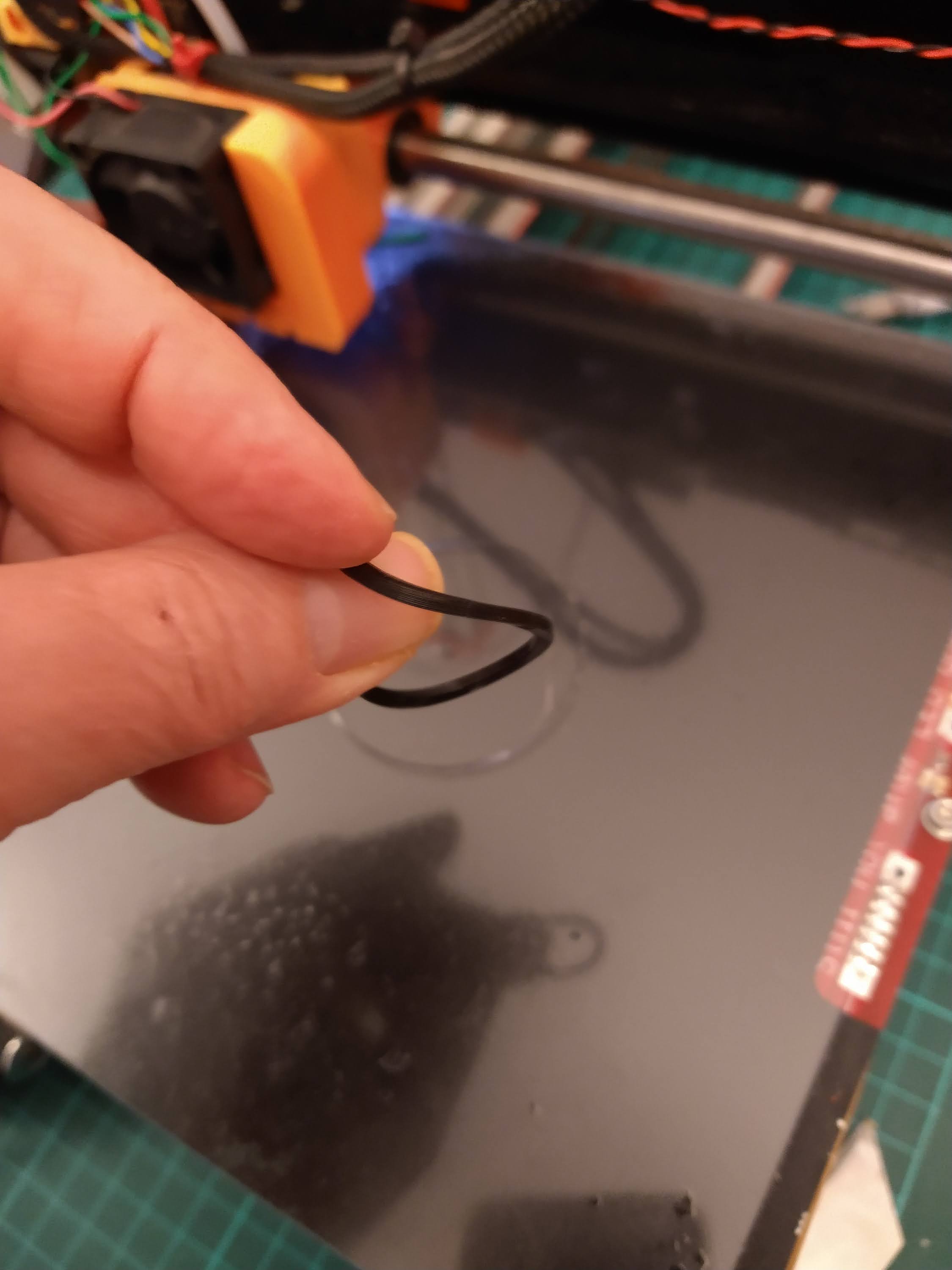

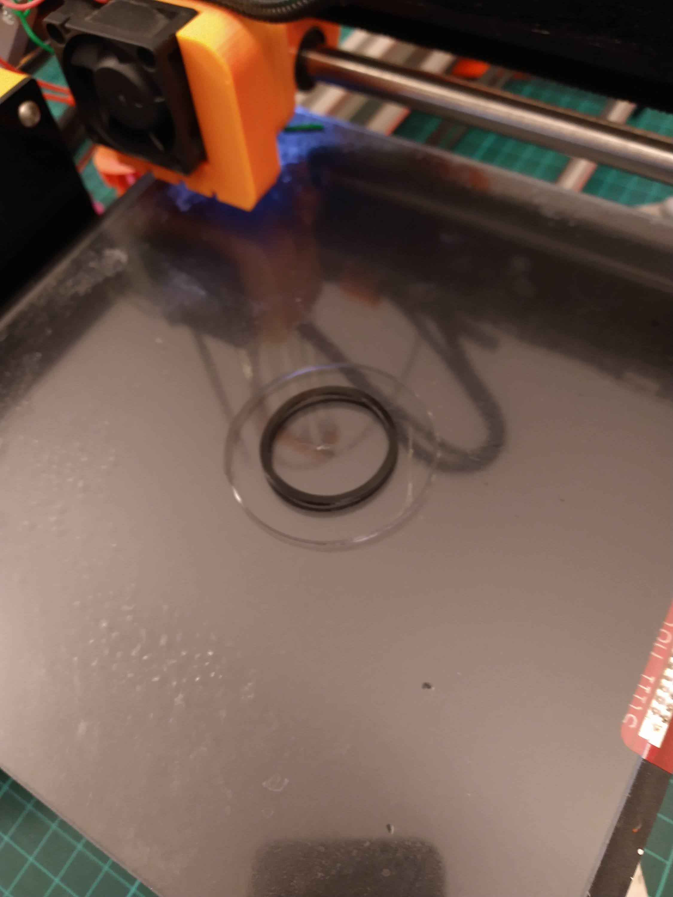

I've only just discovered TPU!
I wanted a particular sized O-ring and was about to buy a selection kit when it struck me that a flexible 3D printing filament would allow me to print one instead. After a quick search, Thermoplastic Polyurethane turns out to be a thing!
IMG_20230320_222359844.thumb.jpg.254f69aaebc6935825ac704b8f496999.jpgIMG_20230320_222427700.thumb.jpg.13e95a9c5eb400842330adf34b1daddc.jpg
I'm besides myself with joy!

Yes, I've done that before and was planning to do it again when it struck me that I might be able to print something the exact size. Superglue on even tiny little drive-belts like those in CD drives is incredibly effective - but you're right about needing a jig to line up the ends.
The bit that got me really excited was the prospect of making custom gaskets of arbitrary 3D printed shapes from TPU. Then I realised both parts of an electrical  box in the case of the thing I'm making could be made semi-flexible and hence watertight when secured together.
