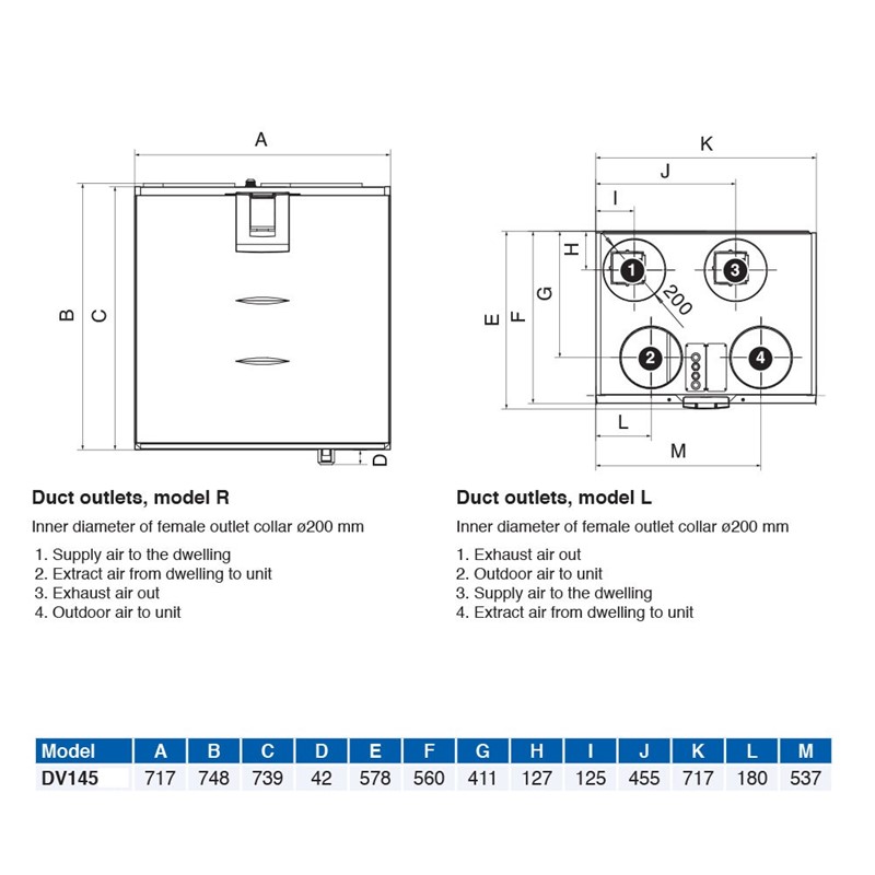

Hi, I'm hoping to get some advice. We have an Airflow DV145 MVHR. I have a problem with the exhaust air being warmer than the inside air but no idea why. Airflow technical support weren't very helpful either. It's bizarre. What tends to happen is when the front cover of the unit is opened/the system is off for 10 minutes then the readings are reset and the exhaust air is cool for a while. But 'sometime' later (even sometimes only after a day or two later) the exhaust air is showing as warm again. I thought it may be a problem with the extract air motor warming the air, but the unit power is only 20W so I think that's not the issue. I had the bearings replaced in case it was somehow friction, but no luck there either. I'm wondering whether the heat recovery is working in reverse or there's a blockage or something weird in the airflow? But then why is usually fine 'for a while'? Any ideas!? Thank you!!

I think Exhaust is the air leaving the room, not the room air being expelled out the MVHR unit, though I am never quite sure.
If I'm looking at the right thing... they have left and right hand models. Would be easy to plumb them in wrong but not sure what effect it would have..

No I think exhaust air is air leaving the building from the unit, but I agree it is not always intuitive.  The stale air from the room to the unit is extract air.

I think it's plumbed in correctly (or mostly correctly), also as this is not always a problem.! Will take a video of the settings and the unit and see if that prompts anything! Please standby... :)
Can you get another thermometer into the exhaust airstream, to confirm if it's outgoing air is actually at that temperature, or if it's an error with the probe / controller?
From the second photo, with 5°C outside but your supply air at 16°C it would appear the heat exchanger is working (or, you're violating the Law of conversation of energy) which leads me to suspect something is misreporting numbers.
If this is in the winter I would expect to see INDOOR as the highest temperature as this is the stale air being taken into the unit and OUTDOOR being the lowest as it is outside air.
After passing through the heat exchanger the INDOOR surrenders heat and is expelled at a lower temperature, recorded as EXHAUST.  Meanwhile OUTDOOR takes on some heat and is fed to the rooms, recorded as SUPPLY.
