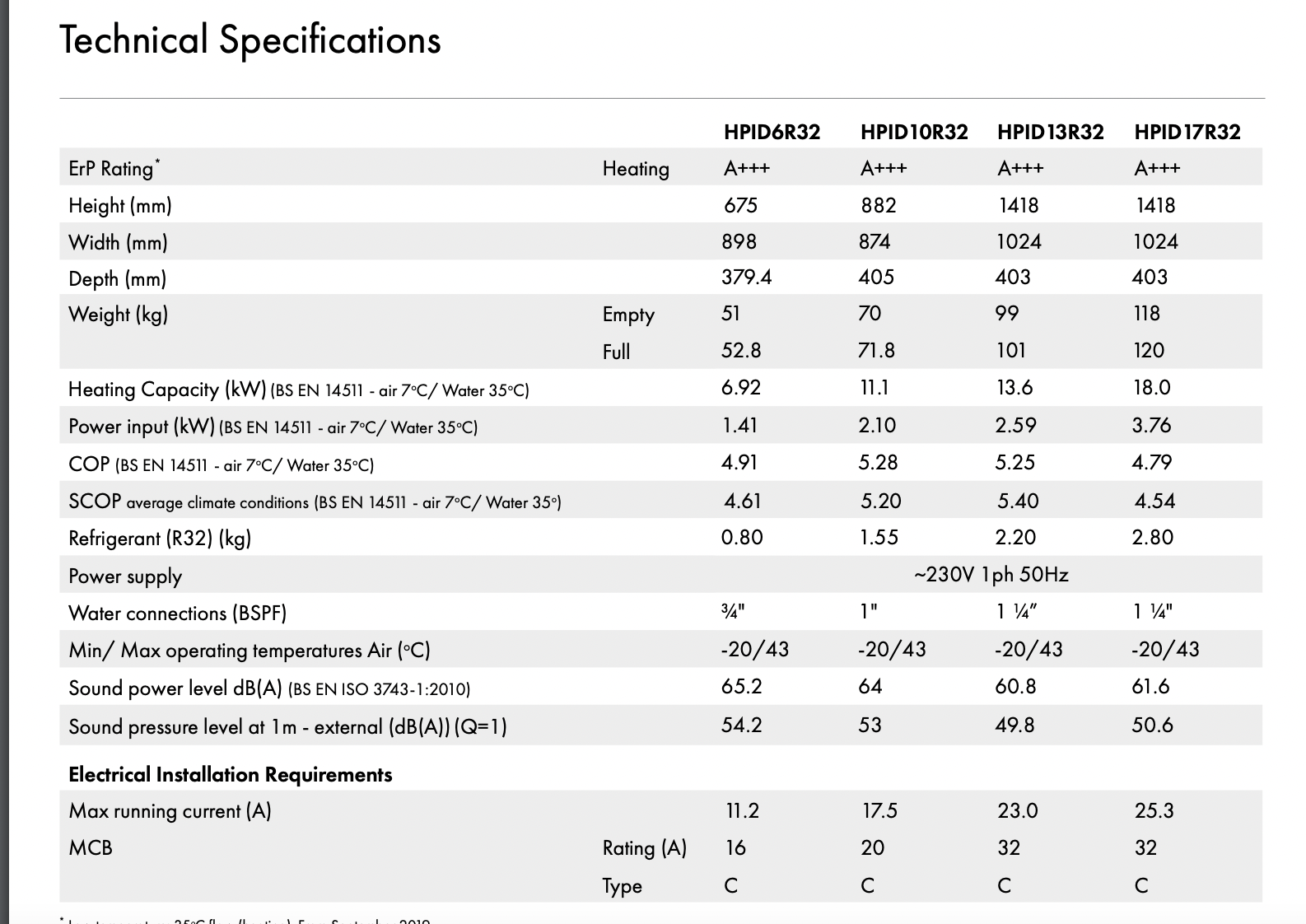

andyj007 Posted March 12, 2023 Posted March 12, 2023 (edited) Evening all. looking at the specification for my grant aerona 10kw heat pump it states an input max of 2.10 kw air 7 flow 35 degrees,, .. is that the max the system pulls energy at? im trying to calculate what battery capacity and or solar panel would be required need to run this in spring and autimn .. could someone look over and see what im missing pls https://www.grantuk.com/media/4759/aerona3-r32-data-sheet_feb-2022.pdf Edited March 12, 2023 by andyj007
sharpener Posted March 12, 2023 Posted March 12, 2023 Yes but you also need to take account of the declared max running current, the 17.5A represents some 4.2 kW which I presume is the max at startup, your ESS needs to be able to handle this. Victron systems can IIRC supply 200% rated power for 10s, don't know about others. Am considering this Grant 10kW for my own system but plan to connect to grid side of the ESS as it would eat through the 10.65kWh battery pretty quickly. I think the capital cost of thermal storage would be much lower/kWh. Also the 7/35C conditions may not be worst case. I have asked Grant for performance curves covering Ta down to -10 and Tw up to 55C but have had no response.

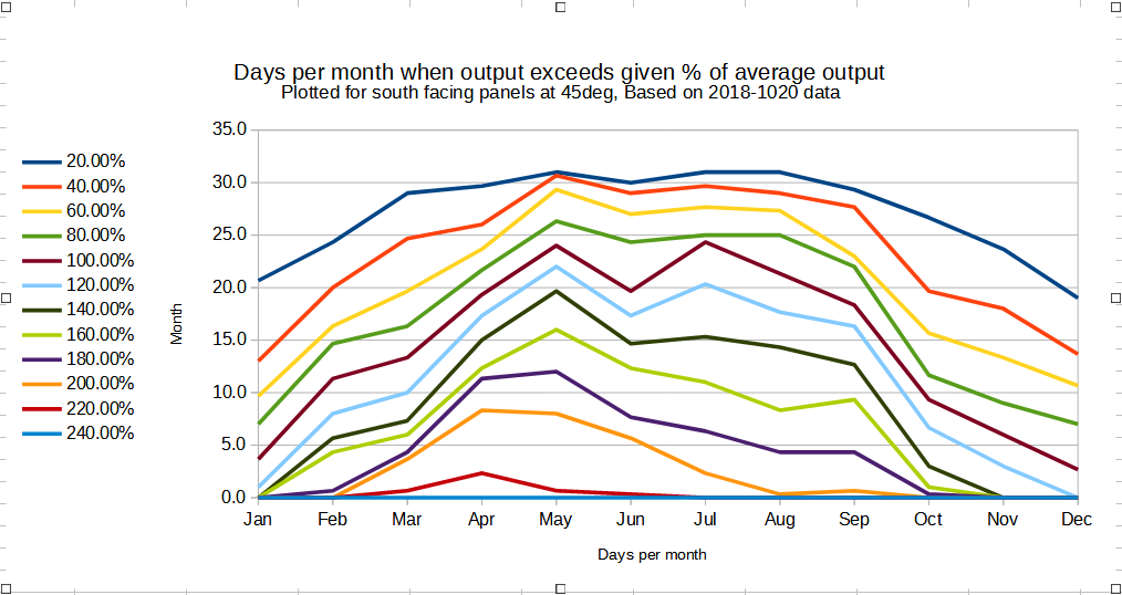

JamesPa Posted March 12, 2023 Posted March 12, 2023 (edited) On 12/03/2023 at 18:23, andyj007 said: im trying to calculate what battery capacity and or solar panel would be required need to run this in spring and autimn Expand The easiest way to estimate this is mostly to ignore the Grant spec and just work out how much energy you need to store to heat your house assuming a COP of say 4-5 or whatever seems reasonable at the ambient temp you want it to work at. So if your house needs say 3kW input at say 12C and the cop is 4 at that temp, you need a total of 3*24/4=18kWh. Storage requirement is perhaps 30-40% less because you don't need to store when the solar panels are generating. Also (possibly do this first!) use pvgis to work out how much solar capacity is required to harvest the total energy requirement (in my example 18kWh) at the relevant time of year. Once you have got approx sizing use pvgis again to work out how much actually needs to be stored and how much you will use in real time. Unless your 10kW hp is well oversized for your house or you are prepared to cover a large garden with solar panels I think you may conclude it's not possible to cover anything more than a fraction of the demand with solar, and that only modest storage is needed to shift the daytime peak to the daytime shoulder. This simple calculation is the way to go to scope what's achievable, then you can refine as appropriate. Edited March 12, 2023 by JamesPa
JamesPa Posted March 12, 2023 Posted March 12, 2023 (edited) On 12/03/2023 at 20:21, JamesPa said: Also (possibly do this first!) use pvgis to work out how much solar capacity is required to harvest the total energy requirement (in my example 18kWh) at the relevant time of year. Expand Eg in mar pvgis says that a south facing 1kWp array at 35deg to horizontal generates about 80kWh per month, an average of 2.6kWh per day. Of course this is an average so some days will be quite a bit more and some days quite a bit less. So if you have space for a typical 4kWp array you will generate 10kWh average, perhaps twice that on good days (???), enough for the example calculation (better than I had guessed when writing the above to be honest). If you were to download the hourly figures you could work out exactly how much is generated on good days and thus how much storage is worth having. I'd work it out this way first, assuming you are constrained in practice by solar capacity. Obviously if you have plenty excess solar capacity then only the hp demand needs to be considered. Edited March 12, 2023 by JamesPa
JoeBano Posted March 12, 2023 Posted March 12, 2023 On my grant aerona3 10kw, the grant control panel tells me the power consumption is 3200w when doing a hot water cycle. That’s the highest I’ve seen it at.

andyj007 Posted March 14, 2023 Author Posted March 14, 2023 (edited) Hi All, firstly thank you for all the replies.. its interesting that as pointed above a 10kw Grant pulled 3kw when it reads max is less.. perhaps it pulled a bit on immersion? thought id try better to explain my thinking.. sorry if it doesnt make sense, and i coud be very wide of the mark I have found over the years that it is very hard to apply and work with calculations based on predicited heat usage .. kwh , kw .. whilst a piece of paper and S.A.P software can throw about some interesting figures .. there are too many varibles that can effect the outcome.. ..and in reality struggle to reflect anything accurate IMO. Its quite simple maths for me.. my 7.2kw W facing array at 5 deg pumps out just approx 2kw at 9.am on a cloudy day .. 3kw if its sunny (early march 2023) . I have a grant 10kw ASHP which calculations show I need 90% of this to heat my house -3 .. its a fair size at just under 4000sq ft.. . i did try this in early december 2022 cold spell and it worked a treat... but then turned it off as its not been needed. The house has been designed to maximise solar gain, I installed a log burner with back boiler , which can heat my 300l of water to 60 degress in 50mins , then will divert to the buffer tank from whic feeds the under flloor, within a couple of hours the floor is charged (some zones not all 4000 sq ft of floor!) which keeps the house pretty nice until the next night. where if needed i can choose if i want to add a little heat and of what source to provide it .. I fitted some IR heaters to the en suites for instant extra warmth comfort when you juct get out the shower .... and have a log burner in an open plan lounge.. along with x 2 A2A units ( which i can run from the solar to heat the rooms withour cost) I think if i my ASHP runs constant and pulls 2kw, I could dump heat energy into my floor 3 hours in morning & 3 hours in afternoon and it not cost me a penny . and set this up automatic .. say from march - april , october -november.. , based on my previous experiance I will not need any heating at all from mid april to end november unless we hit a perticulary prolonged cold spell without sun... what complicates matters is the ASHP is diverter driven and ramps down (i think) so i cant just turn it on flat out and see what it costs ove a given period.. Perhaps i could pre heat my flow and return to 35 degrees , whack the thermostats up very high , limit teh ashop flow rate and run it for three hours when its about 5 deg and see what it pulls on the graph.. .. that was my thinking anyway .. . Edited March 14, 2023 by andyj007
JoeBano Posted March 15, 2023 Posted March 15, 2023 You can check the power consumption on the little white grant control unit. Hold the cog symbol to a 0000 comes up and using the up & down keys put in 0103 press the tick button. This is the power consumption at the time, it’s read only so you can’t change anything. 3200w was hot water cycle, heating cycle around 2700w then will drop down to depending how cold it is outside. 1
andyj007 Posted March 23, 2023 Author Posted March 23, 2023 (edited) If anyones interested : some real life data today, I heated my 300l DHw that was down to 22degres to 54.7deg in 90 mins , The energy delivered to the heat pump was 2.6kw . total , with peak draw hitting 2.5kw twice during the 90min session. . outside temp was 11-12 degrees .. currently I have x2 3.5 batteries and both were charged to 100% before I switched on the HP.. it was bright with cloudy / sun today, and the 7.2kw panels (west facing at 5 degee. off flat covered the water heating costs... .. leaving the batteries untouched.. we then exported another 5kw this afternoon, so a third battery would have easy been charged .. ..even still in March . Aj Edited March 23, 2023 by andyj007
ReedRichards Posted March 23, 2023 Posted March 23, 2023 On 23/03/2023 at 19:05, andyj007 said: The energy delivered to the heat pump was 2.6kw . total , with peak draw hitting 2.5kw twice during the 90min session. Expand Can I presume that the first figure should be 2.6 kWh (kWh being a unit used to measure energy)? Whilst the second figure is a peak power of 2.5 kW?
andyj007 Posted March 23, 2023 Author Posted March 23, 2023 On 23/03/2023 at 20:54, ReedRichards said: Can I presume that the first figure should be 2.6 kWh (kWh being a unit used to measure energy)? Whilst the second figure is a peak power of 2.5 kW? Expand Yes your presumption is correct.. big fingers little keys .. thanks
SteamyTea Posted March 24, 2023 Posted March 24, 2023 On 23/03/2023 at 19:05, andyj007 said: .even still in March Expand Depending on your roof angles, March can be a good month because the 'direct solar beam' aligns nicely with the roof, creating a flat plain. Yesterday Cornwall was getting, during the day, about a quarter of its electrical power from local solar.
andyj007 Posted March 26, 2023 Author Posted March 26, 2023 On 24/03/2023 at 08:32, SteamyTea said: Depending on your roof angles, March can be a good month because the 'direct solar beam' aligns nicely with the roof, creating a flat plain. Yesterday Cornwall was getting, during the day, about a quarter of its electrical power from local solar. Expand 5 degrees West .. appears to be more pruductive at this time of year than my south facing system at 37 degrres on my last house .
