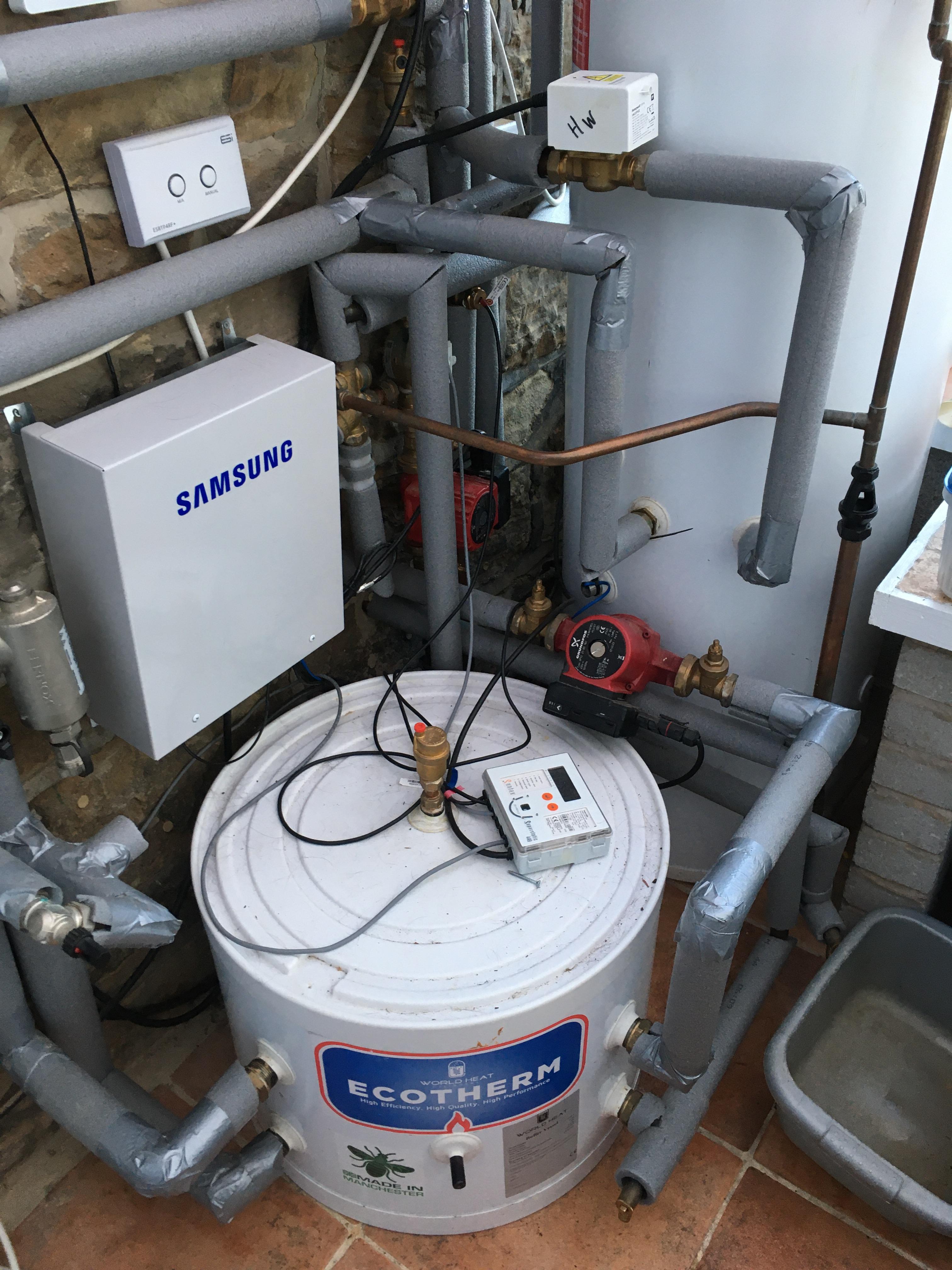

On 11/03/2023 at 15:52, JamesPa said:
@IanRis absolutely adamant that is not the case, if you follow the thread.  So far nobody has posted measurements to confirm either way.,
I have followed the discussion between @JohnMo and @IanR with great interest. I suspect Ian is right if buffer tanks are suitably designed and sized. However, I believe that most are similar to my own 50L buffer tank (see attached photo), installed by a company that claims to install more ASHPs than anyone else. There is a 4-5 deg C temperature drop between the flow from the 12kW Samsung ASHP into the buffer and the flow out of the buffer to the radiator circuit as seen in the attached diagram. This adds around 10-12% to the energy costs of heating for no apparent benefit. When the ASHP cycles in warmer ambient temperatures it cycles every 8-9 minutes, despite the buffer. In fact I believe that the lower heat delivery from the radiators due to their lower temperature means that cycling becomes more likely, not less.
When I reduced the setting on the primary water pump from 3 to 1 and increased the setting on the secondary water pump (to the radiators) from 1 to 3, the difference between buffer in and buffer out rose to around 10 deg C and the ASHP started cycling 5-6 mins on and 3-4 mins off. This cycling stopped once the pump settings were restored.
I am hoping to have my buffer tank removed and bypass valves installed. Together with the removal of glycol, this might reduce energy costs by 25%. The expected SCOP of 3.68, based on Samsung's datasheet at 50 deg C flow temperature is a complete joke. I can only surmise that Samsung's 'Seasonal' was from June to August, possibly in the Bahamas!
I'm not sure how any of us would know. I was told my installation was typical of a Nibe install at the time, accept for the cooling.
It does look as though your flow Temp is around 5°C higher than your emitters require to meet the heat demand.
Are all the temps taken at the buffer?
From the temp trace there doesn't appear to be any of the cycling you mention, was the temp trace during a particularly cold period?
Are your tanks installed within the thermal envelope? I can see what looks like an external wall, and, is that buffer insulated? Neither would account for the delta between buffer in and out temps, it's just out of interest.
Visually, it does look as though the port positions on the buffer are unlikely to stop the buffer mixing.
Yes, they are all taken from the pipes leading into or from the buffer. I also recorded the flow and return temperatures recorded by the Sontex heat meter and these were virtually identical to the buffer in and buffer return values (the lines on the graph with all values overlap almost completely).
There was no cycling during this period. Ambient was around 7 deg C
The tanks are installed in an unheated porch. The buffer has internal insulation presumably as it it is not warm to touch on the outside, similar to the DHW cylinder.

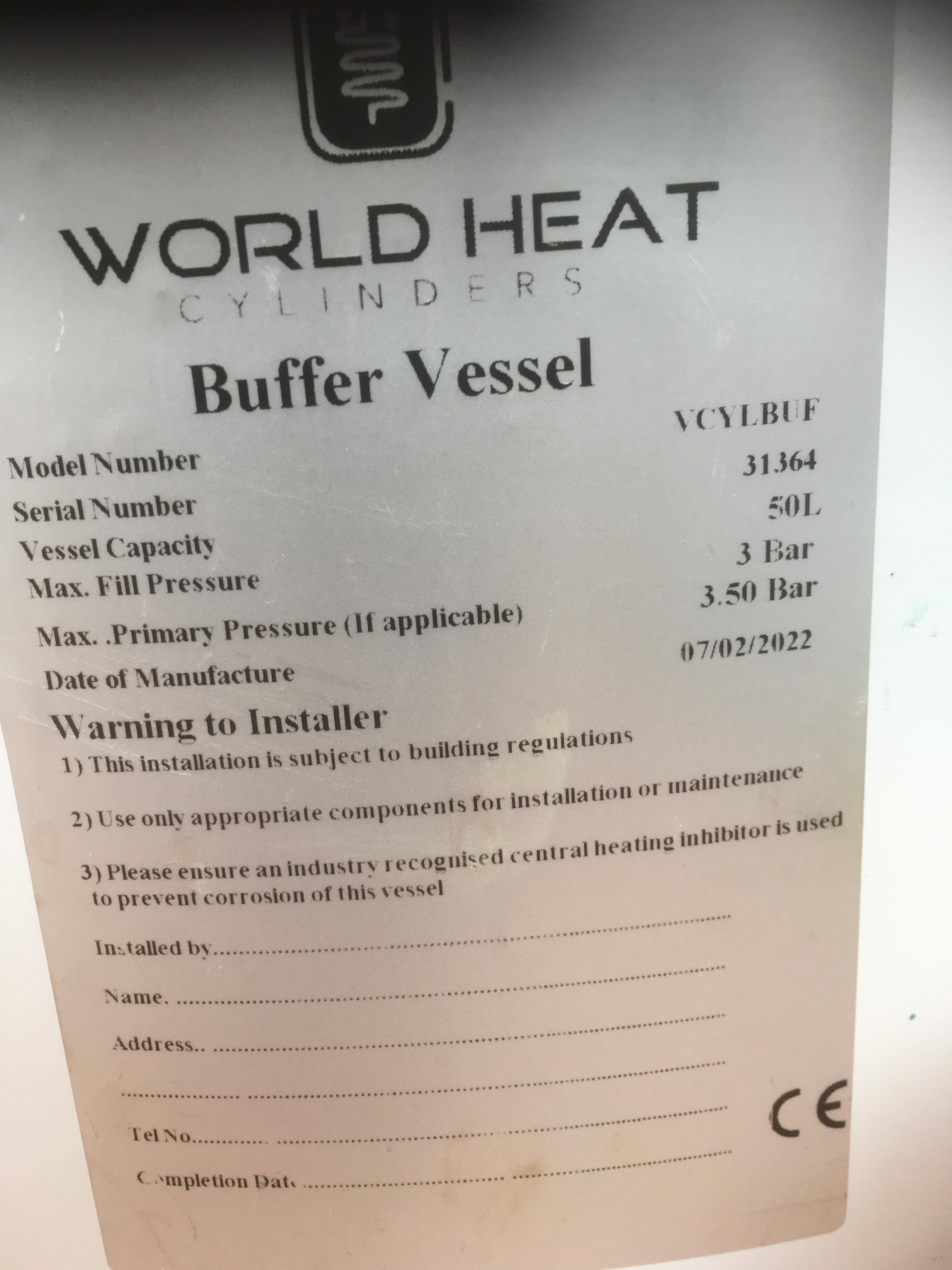

Link to comment
Share on other sites
6 minutes ago, JohnMo said:
I would look to dump the buffer, but would not install bypass valves, I would ensure a proportion of the rads stay open, so take any trv's off a couple of the bigger rads, so you have good size of system always open to the heat pump, if room get to hot fine tune the lock shield valves to balance. Or better still modify the WC curve downwards, so it reduces overall flow temp.
Thanks. The advice to install bypass valves came from Brendon Uys, plus remove TRVs and the Honeywell valves and anything else that will reduce flow. My pipework to the radiators is 22mm to 2 kitchen radiators and the upstairs bathroom radiator and then 15mm to 5 other radiators, so I won't be able to get a flow rate much above 20L/min. According to the Samsung wired controller the maximum flow rate is 23L/min in the primary circuit, but the Sontex heat meter gives a value of 15L/min, so this may not be an issue.
According to Freedom Heat Pumps, a buffer tank with flow separation is required by the Samsung warranty. This despite its previous owner now saying that buffer tanks should rarely be used.
@IanRs argument (which, ultimately, was fairly convincing) depended on stratification, which in turn depends on (all of) a well designed tank, the thermostat controlling the hp being located correctly, the pumps being more or less well adjusted, and a good height to diameter ratio. Yours doesn't have the last of these, your measurements confirm 100% mixing in the tank and, as you correctly say, this will be a 10%+ efficiency hit solely because of the mixing and hence elevated flow temperature.  Losses from the tank will add to this and if WC is not correctly adjusted (which seems unlikely given that your installer clearly has not prioritised efficiency), will add further.
If the buffer tank is essential for the warranty (which I doubt), plumb it as 2 or 3 port but definitely not 4.  If it's plumbed as 2 port, you will need to lose a pump.
Unless there is a good reason that you have not stated, this is a poor installation.  However that's nothing special to heat pumps, since condensing gas boilers were introduced (and widely touted to be a good thing) most installations seem to have been poor, ie with a flow and return temp adjusted to exceed the maximum figure at which condensation occurs this sacrificing 10% or so in efficiency.  Installers, it seems, frequently prioritise avoiding support calls over efficiency, and there is no reason on earth why new technology will change that behaviour.

Have seen the  Samsung warranty stuff before e.g. here. From what I have read elsewhere you might as @JamesPa says do better with it as a 3-port buffer, as a compromise between too much mixing and not enought engagement. Ideally with the 1 port teed off the flow and the 2 ports on the return.
If you can then tune the pump settings so there is least flow through the tank when the demand is greatest I think you will have better efficiency. Fortunately you seem to have better instrumentation than the installer!
