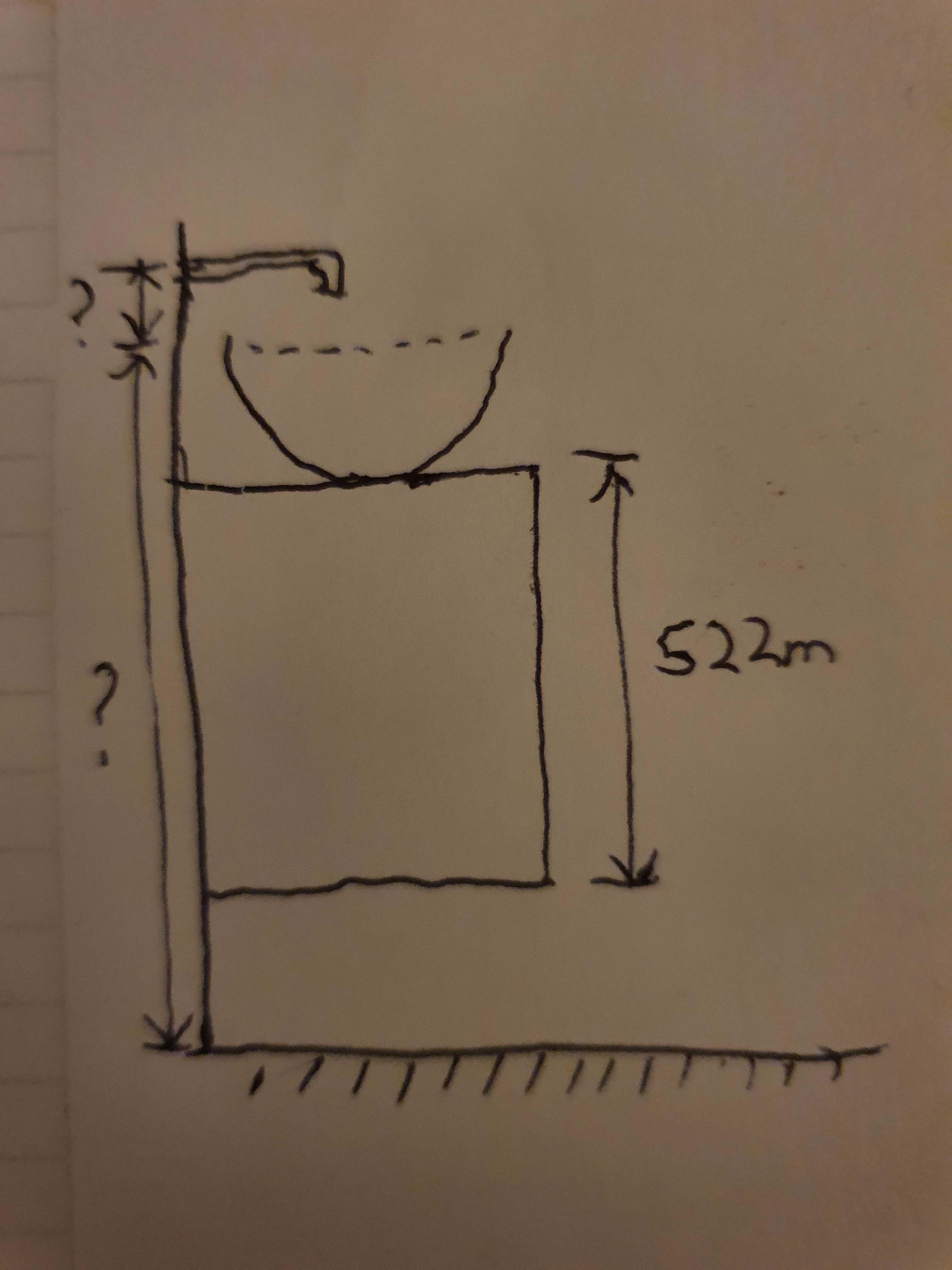

I am have a very dumb moment I think, in our en suite we are going to have a wall vanity unit and wall taps.
I am really struggling to get my head round hieghts and need a sanity check.
I am looking to set the top of the counter top bowl to 850mm above floor level, then that the wall mounted taps 200mm above the top of the bowl.
Does that sound about right?

I was saying the 850mm would be the top of the bowl, the counter top would be the basin bowl depth below that.
Sounds like I need to work out the basin depth, and the will be the counter top level.

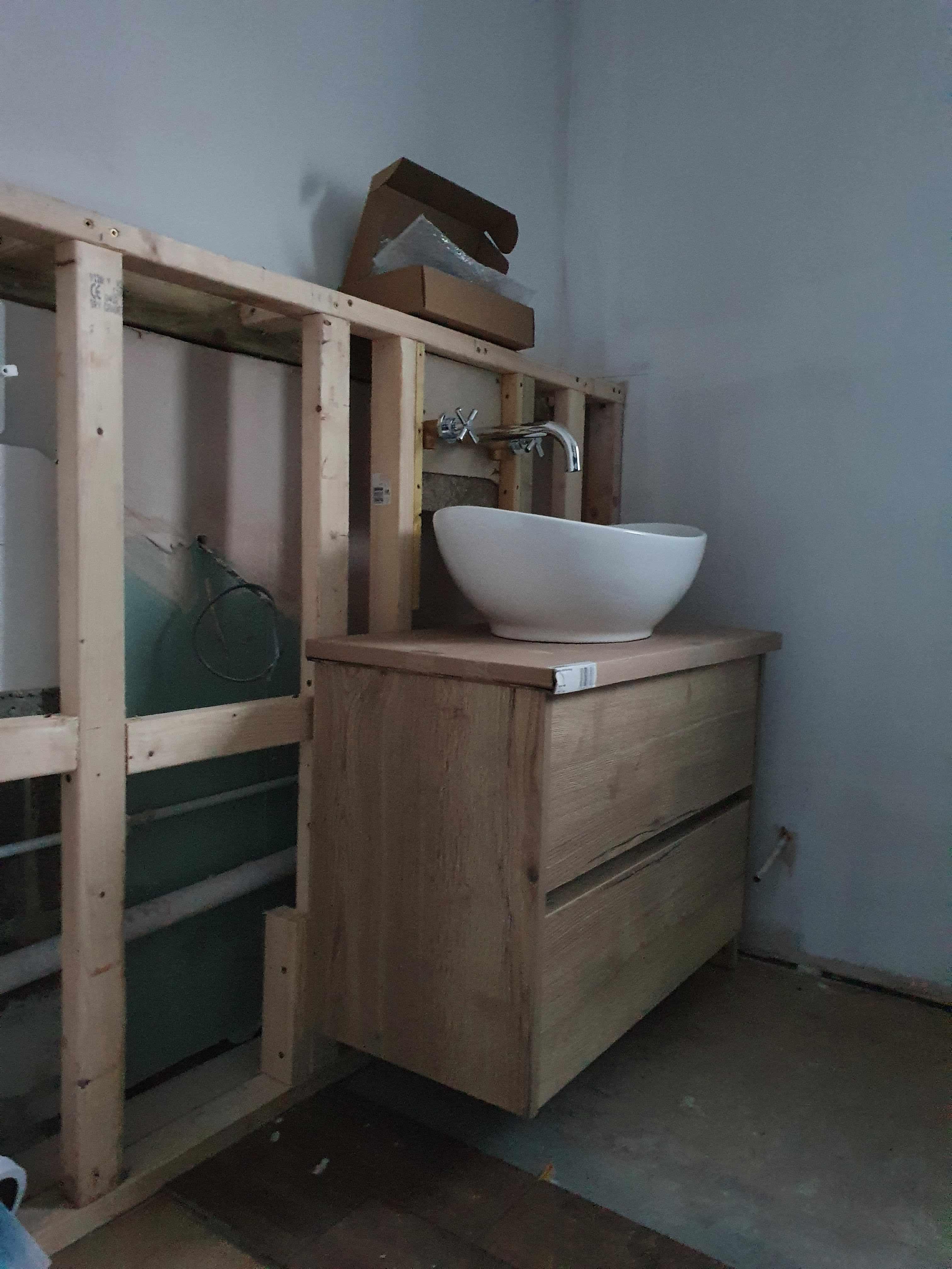

I did a dry fit of the unit and taps, with top of bowl 840mm above floor, tap hieght seems right.
The thing that concerns me is the small space below vanity unit and floor.
