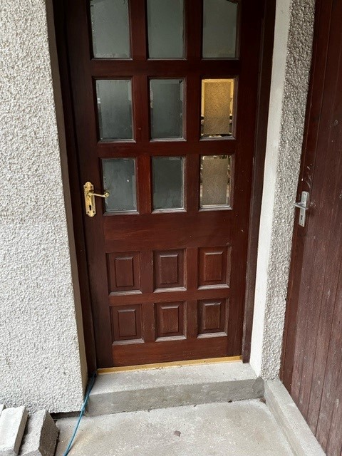

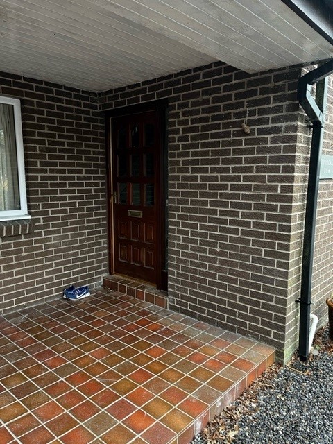

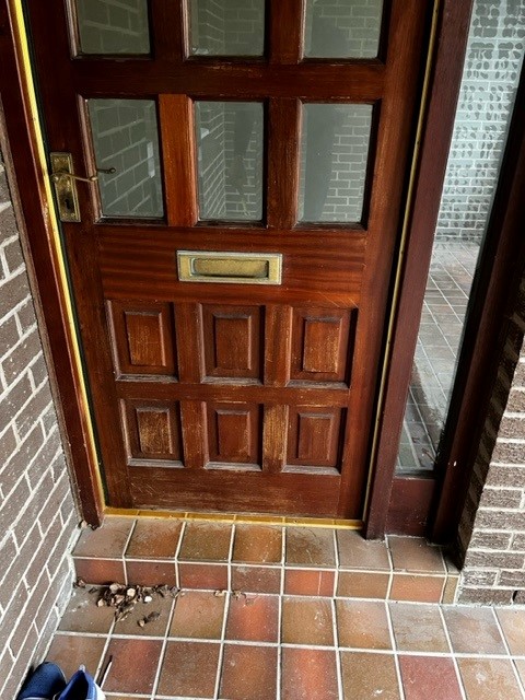

rmillener Posted February 28, 2023 Share Posted February 28, 2023 All, Am fitting new front and rear doors as the current ones are plain awful, old wooden ones - warmer outside than inside half the time. The question is would you add a sill to these doors? They are both very well protected. I would be tempted not to and just have a 55mm threshold to give the best seal. I will also be removing the tiles on the front door and re-tiling. The back door step may also be tiled in the future too. To add a sill would be 180mm sill on the front and 150mm for the rear. My understanding is the main aim of the sill is to drain rainwater away but both don't get any rain due to them being so sheltered. Thanks Rich Link to comment Share on other sites More sharing options...
ToughButterCup Posted February 28, 2023 Share Posted February 28, 2023 12 minutes ago, rmillener said: ...would you add a sill to these doors? They are both very well protected. ... No, for the reason you give. Link to comment Share on other sites More sharing options...
gaz_moose Posted February 28, 2023 Share Posted February 28, 2023 no sill and low threshold. Link to comment Share on other sites More sharing options...
craig Posted February 28, 2023 Share Posted February 28, 2023 Why would you? It’s not needed for the reasons you have said. Link to comment Share on other sites More sharing options...
