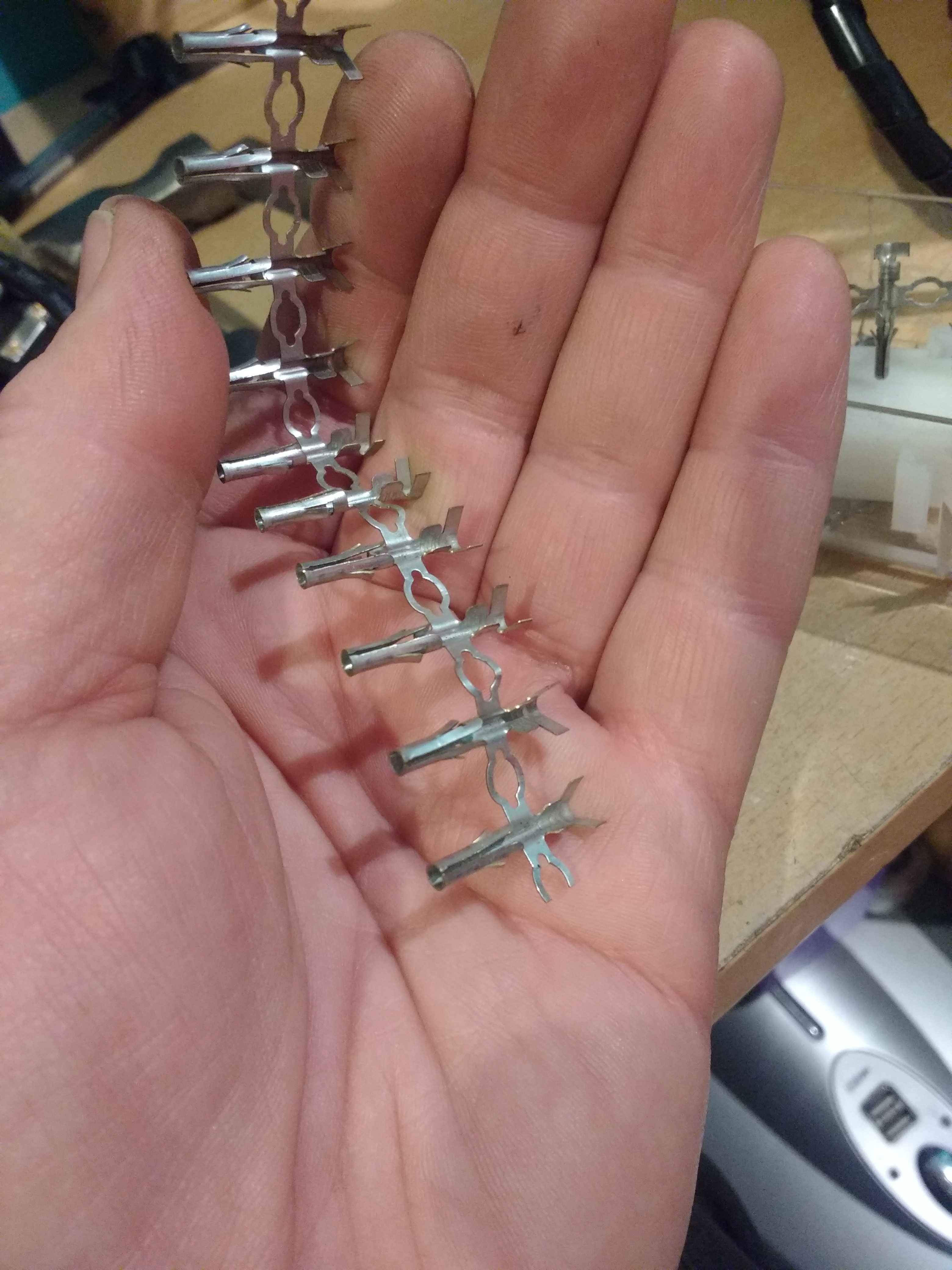

I got these connectors from Maplin probably 35+ years ago. I think they may be Molex or similar.

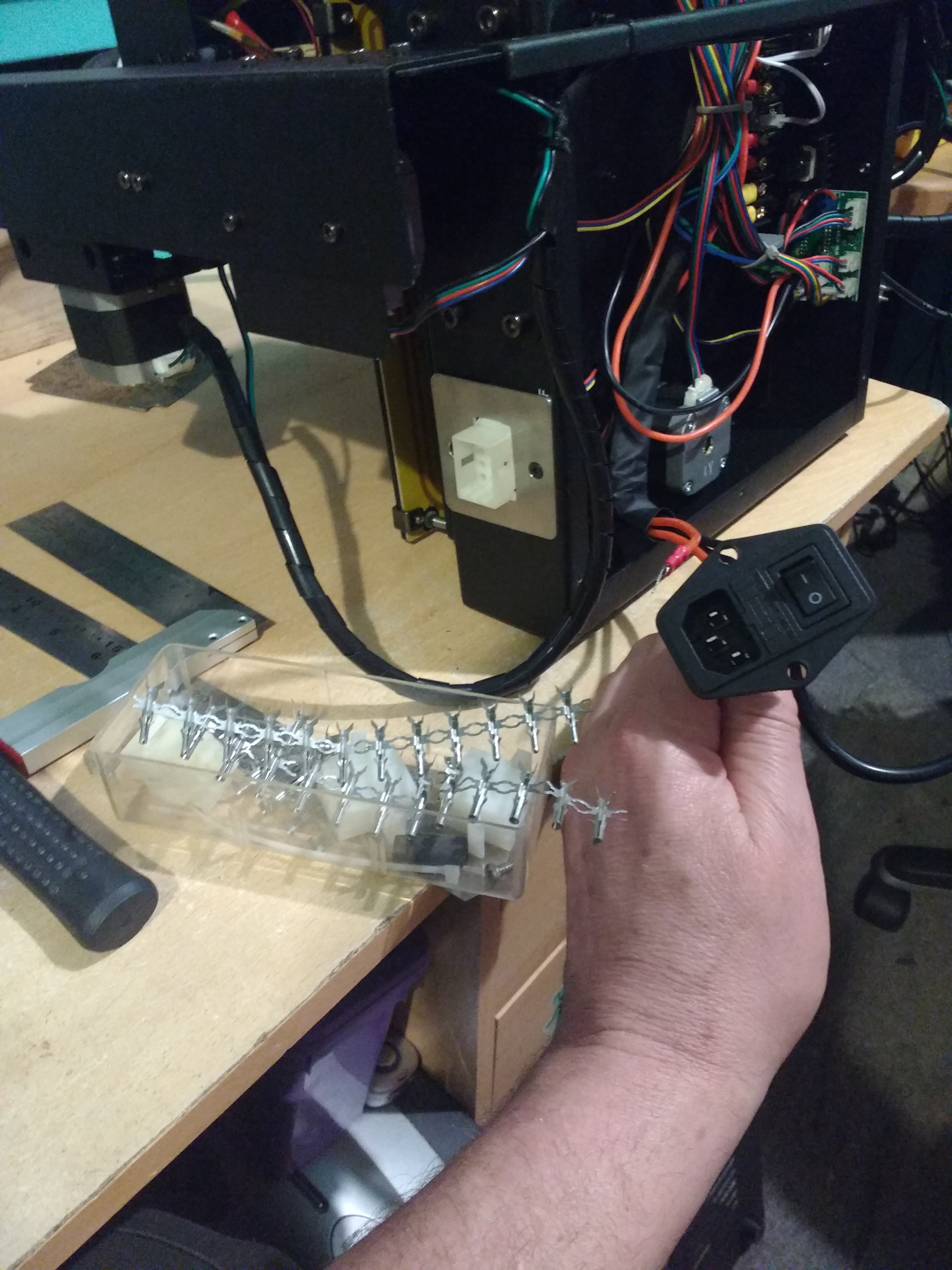

It was when I was making quick release car stereo harnesses for mates so they could take the factory head unit out and fit aftermarket ones. Then quickly fit the original when they sold the car. I had a tool for crimping them once but it's long gone.
They comprise a white plastic shell that you push the crimped M/F ends into. A shell below attached to the 3D printer:
These are the female crimps:
Can anyone point me at a suitable crimping tool?

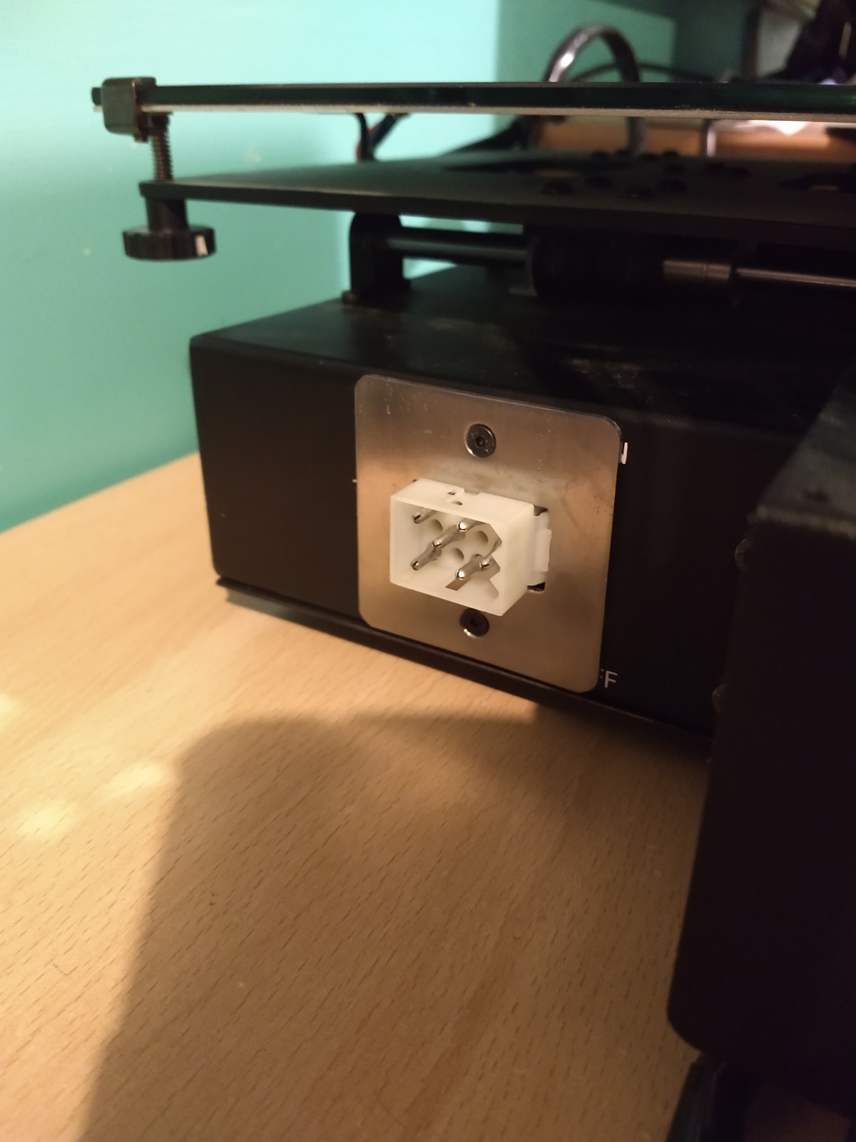

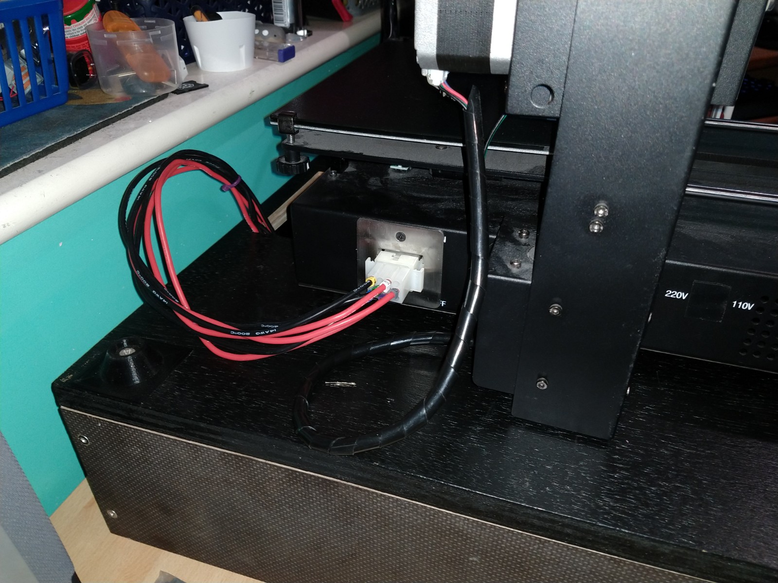

Sorted. Removed the IEC mains inlet and switch on the 3D printer. Knocked up a little stainless plate and fitted a male Molex with the pins nicely spaced out. The PSU is getting mounted externally. All this connector has is 3 reds & 3 blacks at 12V from the PSU:

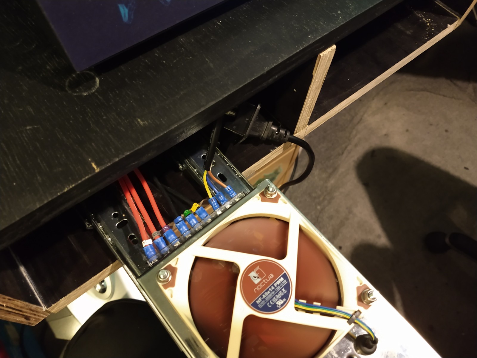

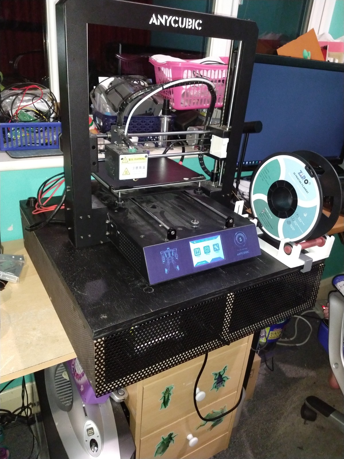

The relocated PSU all fires up as it should on the new connector:

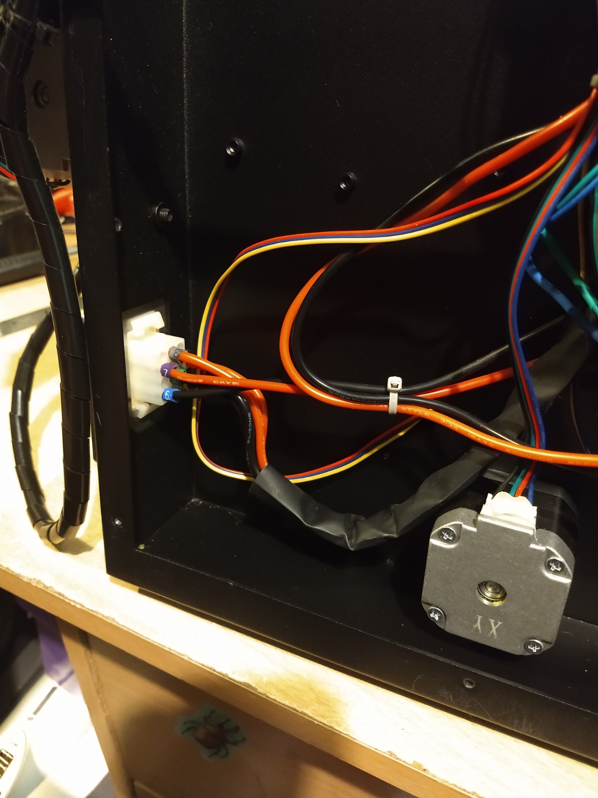

New, bigger fan is quieter. Haven't properly fixed the IEC connector on the base section yet:
12V wires just stuffed through where the duct will go when the enclosure sits atop. These will get tidied up:
