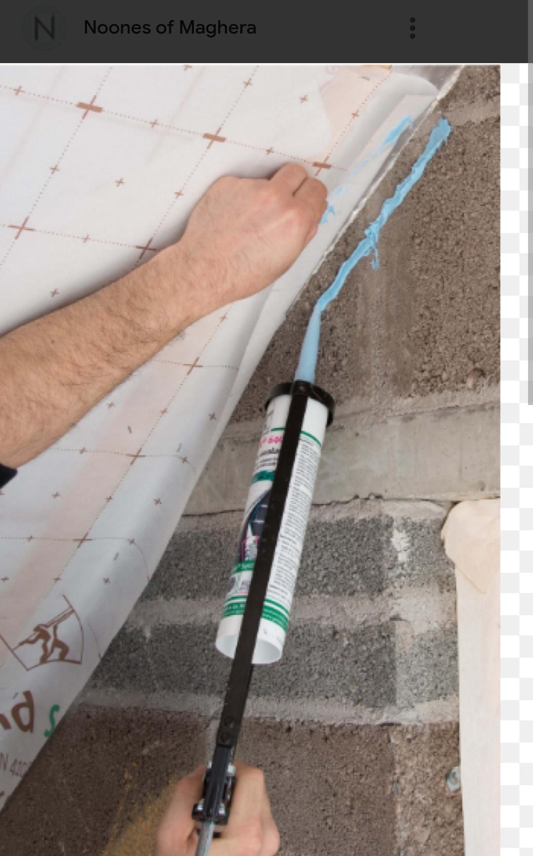

Iceverge Posted April 24, 2023 Share Posted April 24, 2023 No, it won't stick to blockwork. Membranes, OSB, Foil faced boards, metal all ok. If you tried to stick it to block it'd just pull off a thin layer of dust. With boarding you'll be depending on the board adhesive to seal around the edges of the boards and any penetrations like sockets etc for airtightness. I would tape a strip of membrane to the bottom PIR board and stick it to the blocks with some airtight sealant like this. Then make sure the boarders cover the joint between the blocks and membrane with a continuous bead of boarding adhesive, it's as important to prevent any damp air escaping from the house to your roof and rotting it, as it is for energy saving and comfort. It can be easier to leave the membrane too wide, then seal and then trim back to 50-100mm once done. This is the stuff. Wear gloves as it's like permanent chewing gum. Link to comment Share on other sites More sharing options...
