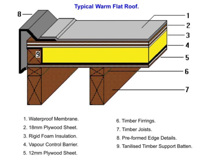

Johnnyt Posted February 18, 2023 Posted February 18, 2023 Our architect advised there had to be a greater amount of insulation above the rafter than in between with a hybrid roof. Something I think is illustrated in the article linked. https://architecturetoday.co.uk/roofing-in-detail-hybrid-roofs-best-practice/
Iceverge Posted February 18, 2023 Posted February 18, 2023 There's mis match of terminology here unfortunately that regularly gets confused. A "warm roof" has the insulation above the rafters. This will naturally result in a "warm loft" where the attic space is inside the conditioned space of the house. This can also be done with a "hybird roof" (insulation above and between rafters ) or insulation between and below the rafters. (sometimes called a "cold roof") A "cold loft" is naturally where the entire cold loft is cold and all the insulation is placed above the ceiling. In your situation I suspect you are better off with a "Warm Loft" You just need to decide on a 1. Warm Roof 2. Hybrid Roof 3. Cold Roof
richo106 Posted February 18, 2023 Author Posted February 18, 2023 Yes I meant warm loft definitely The example you have given is for a flat roof, is this the same method used on a pitched roof with tiles? Many Thanks

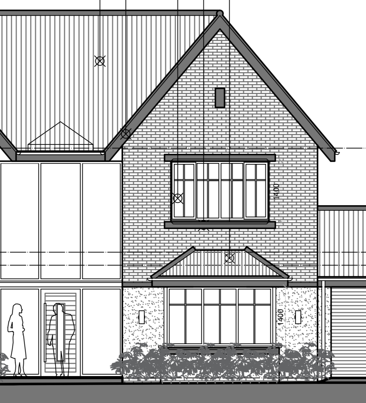

Iceverge Posted February 18, 2023 Posted February 18, 2023 Slightly different as you will need battens to hold the tiles and can do without the top layer or ply/osb. You would need to ventilate behind the tiles also. Do you have a cut roof or a trussed roof? Have you many overhanging eaves/gables etc? In fact do you have any drawings of the roof as planned?
richo106 Posted February 18, 2023 Author Posted February 18, 2023 I have just spoken to my roofer, he said he can do a warm loft but would make the soffit/fascias big and bulky which we don’t want. The roofer was right in saying the architect needs to design in warm roofs to make them work etc So we can’t do a fully warm roof/loft Is there another method we could use to create warm roof? Roofer suggested PIR and foamed in gaps between rafters leaving 25mm and then 50mm PIR overlay. The only issue with this is cost, I can imagine this method will cost a lot more than 400mm of loft insulation originally planned I am guessing the MVHR distribution box and ducts sit under the 400mm insulation and then the MVHR unit sits on top of insulation on some floorboards/legs etc It’s just my air tightness detailing for cabling/ducting that will have to come through the upstairs ceiling

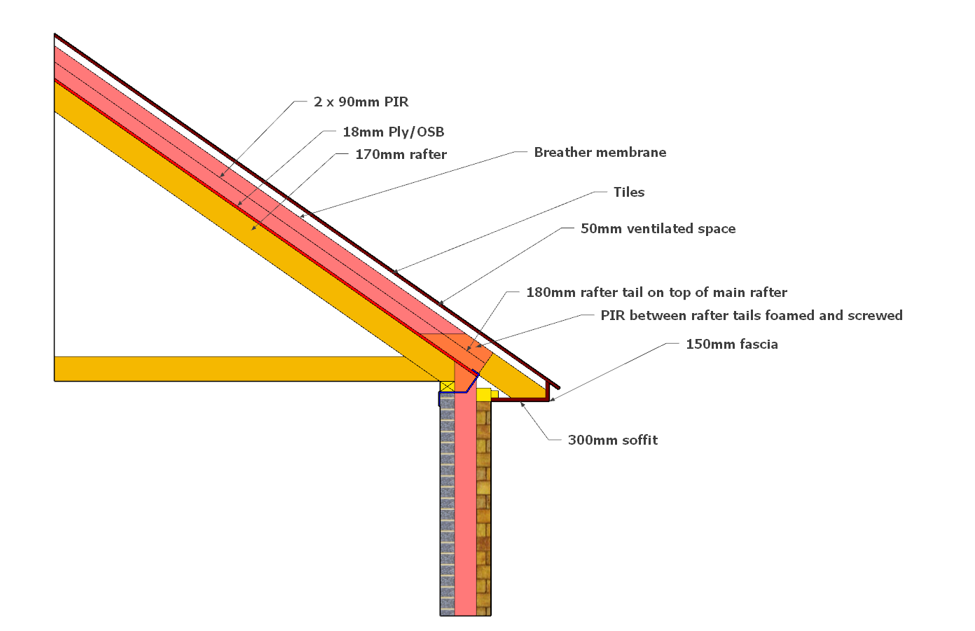

Iceverge Posted February 18, 2023 Posted February 18, 2023 If you can draw it you can build it! Here a quick sketch I did. Just attach some rafter tails on top of the rafters and fit the PIR around them. Your builder is a sadist if they think it's a good idea to put PIR between rafters!! Matt shows how to do it here.

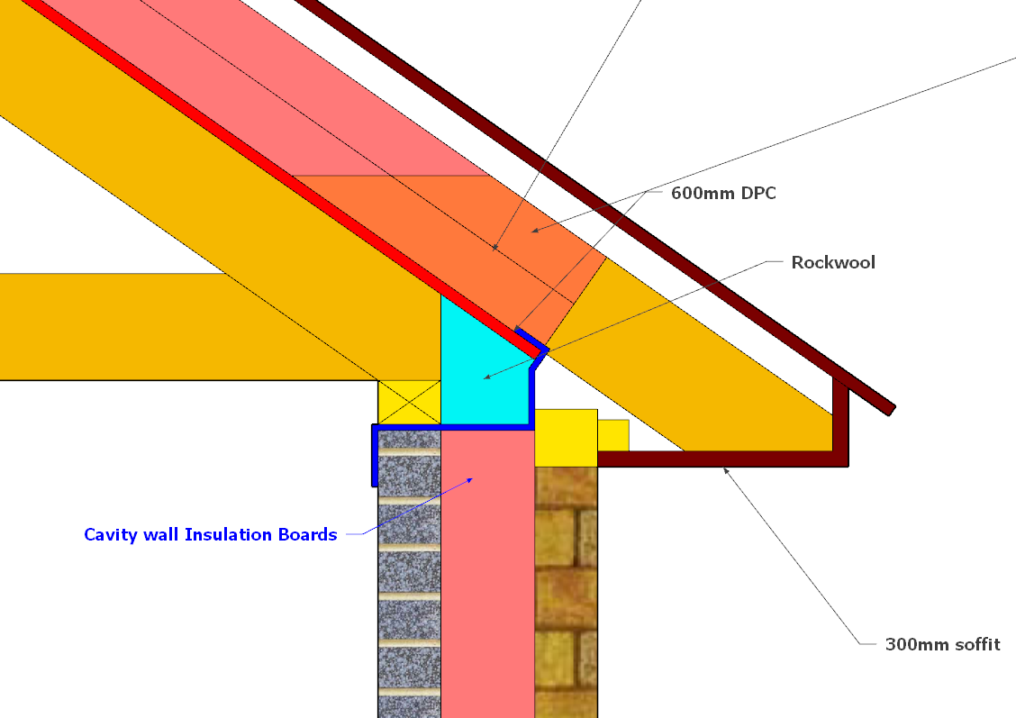

Iceverge Posted February 18, 2023 Posted February 18, 2023 For air tightness use a 600 mm strip of DPC under the wall plate on the inner leaf. Mesh it and plaster into your inner airtightness layer on the blockwork. Then wrap it around the end of your rafters and tape it to the top of the ply. Tape all the ply deck together and you'll have a really robust airtight layer and simple to execute.
richo106 Posted February 18, 2023 Author Posted February 18, 2023 Thank you!! @Iceverge I really like this idea, I will put it to my builder/roofer. I know it will cost a lot more but will save a lot of time and money internally Many Thanks
richo106 Posted February 18, 2023 Author Posted February 18, 2023 How would the front gable fascia look though? Would that look bigger than normal? Many Thanks
Iceverge Posted February 19, 2023 Posted February 19, 2023 @richo106 It can be any width you want. Have a look at the video I sent, it might be clearer than explaining it.
