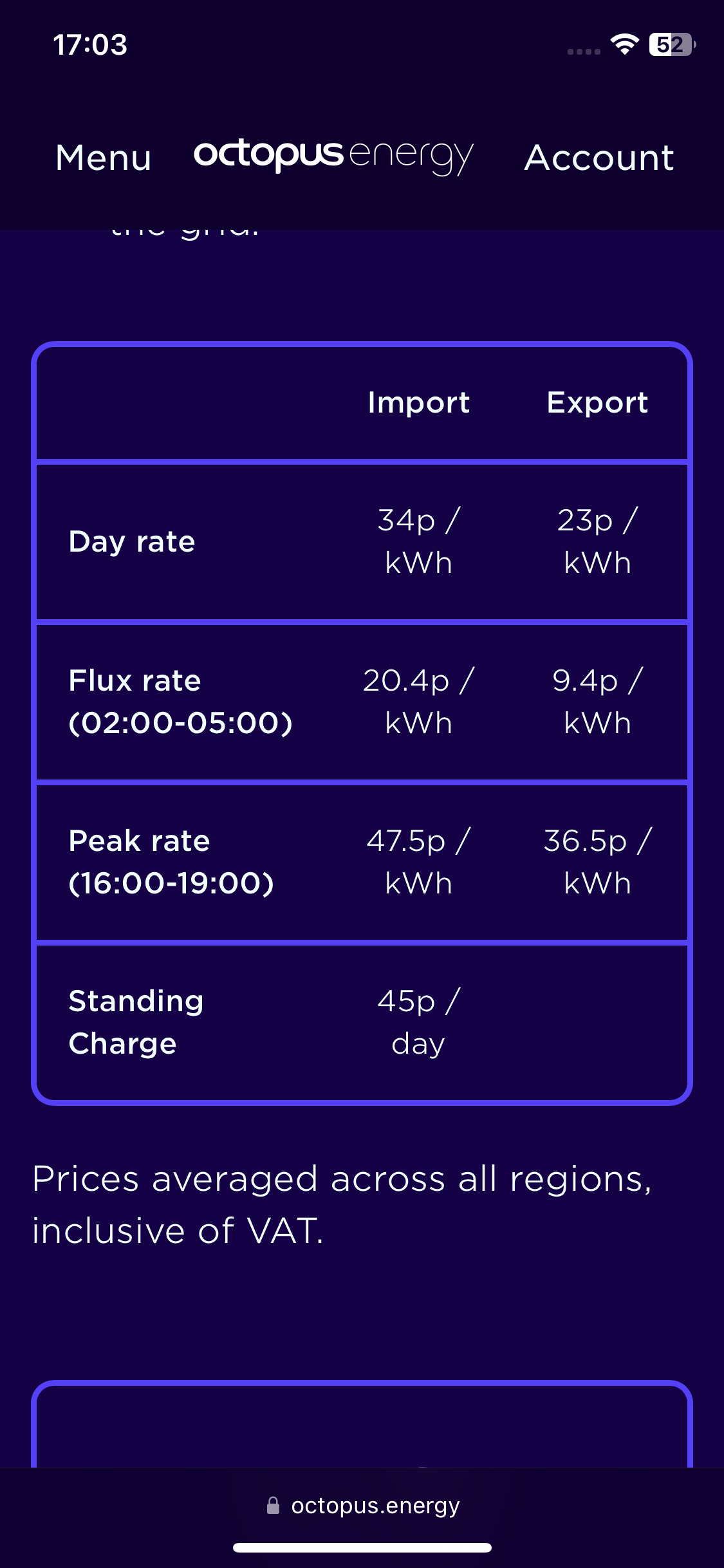

    I guess exporting at 35p/kWh isn't *that* different to importing at 33p 😅   Yesterday was a nice sunny day. As a result, I exported lots and managed to break even (I think for the first time

I've just started the application for Octopus Outgoing, to increase my export from 50% deemed at 6p to actual export (near 50%) at 15p.
This tarriff would increase that to min 23p, and max 36.5p, with the ability to also charge the battery during the cheaper period through the night in the winter months. Will keep an eye on this as another potential to be better off.

A favourite blog of mine has written about this compared with Go, and created a complex spreadsheet to calculate costs between both tarriffs: https://protonsforbreakfast.wordpress.com/2023/02/23/tariff-calculations-octopus-go-versus-octopus-flux/
Initially FLUX looks much worse than GO, but the twist is that FLUX offers much higher rates for exporting electricity: 9.4 p/kWh, 22 p/kWh, 36.5 p/kWh for the cheap medium and high rates respectively. These figures should be compared with the miserly 4.1 p/kWh on the GO tariff.

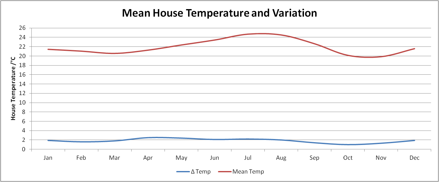

12 hours ago, Nick Thomas said:
I *think* it also makes sense to bring the house to 20°C between 3-4:59am, in the hopes of coasting until the solar shows up

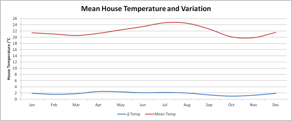

Just had a look at my last 3 years worth of temperature data.
The Δ Temp is just the maximum mean temperature minus the minimum mean temperature, there may well be greater extremes i.e. leaving a window open all night in the winter, or not opening a window in the summer, but these would be relatively short term fluctuations i.e. hours.
As you propose to do exactly what my storage heaters do, I don't think there is any real risk of having a house that is way too hot in the mornings and too cold in the evenings.  We can all cope with ±1.5°C without noticing it.
