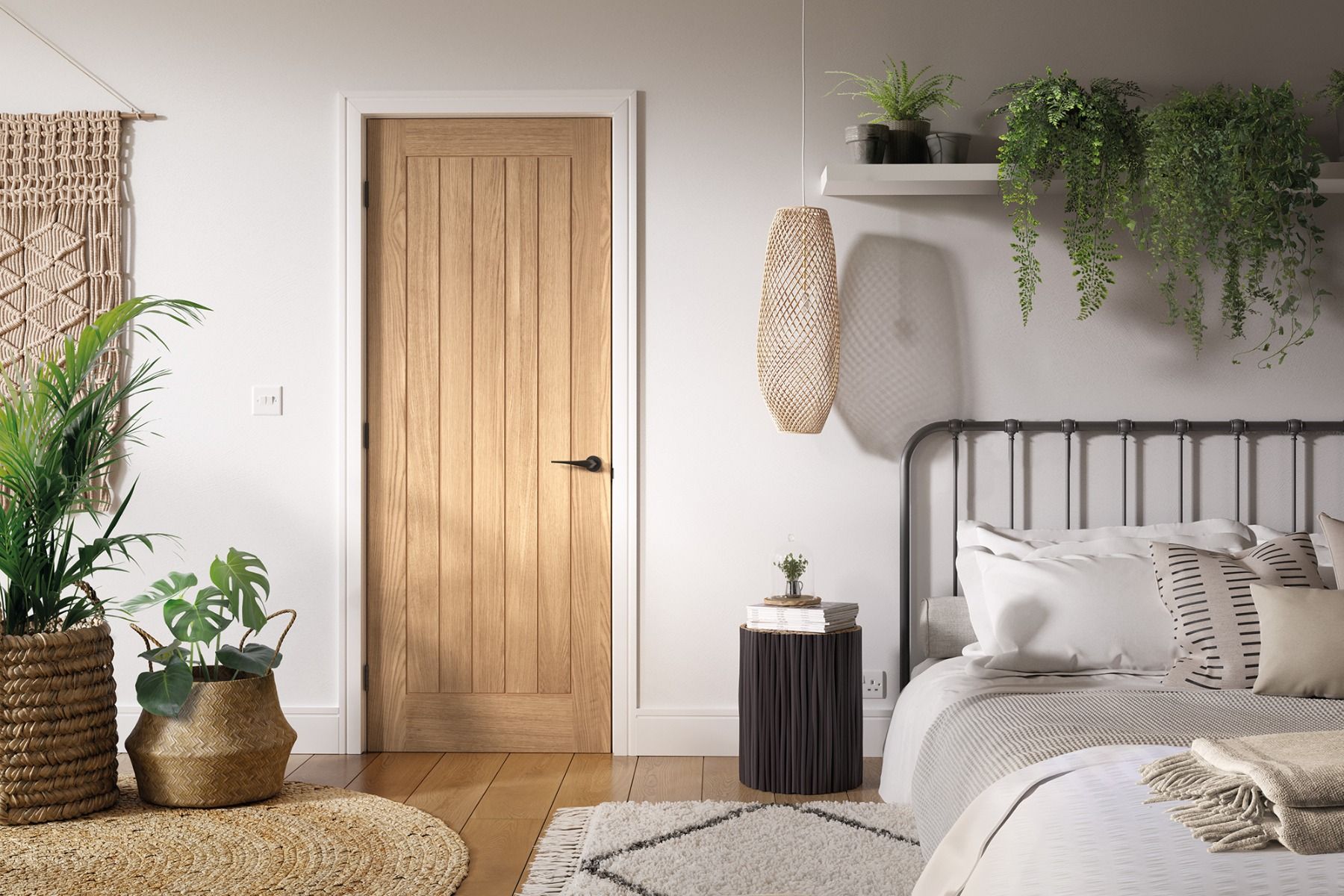

Moonshine Posted February 12, 2023 Posted February 12, 2023 We have decided to go for white architrave and skirting and hope to end up with something like this look There seems to be two options for door linings solid wood or MDF, and consensus of what would be better?

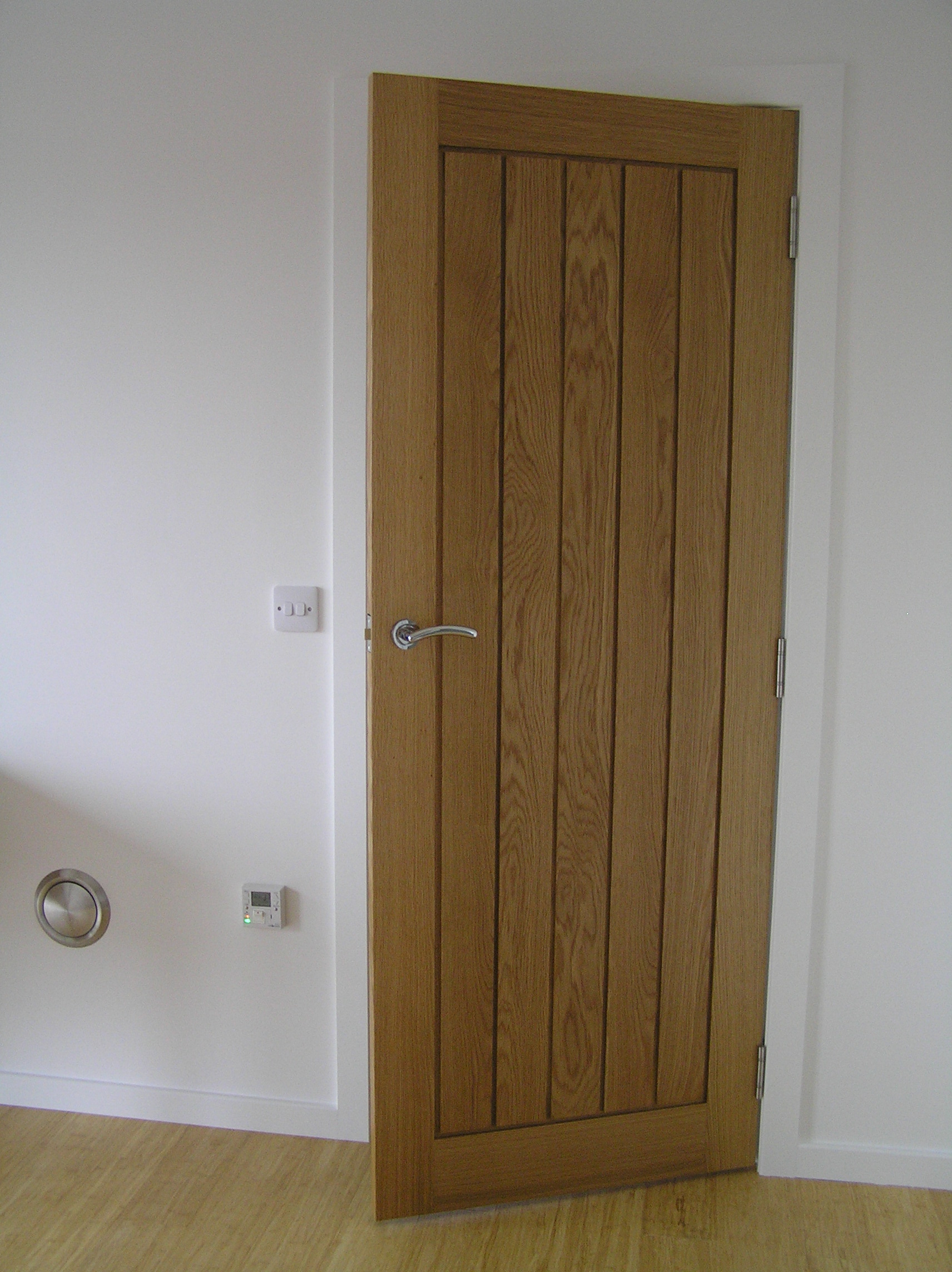

Gone West Posted February 12, 2023 Posted February 12, 2023 55 minutes ago, Moonshine said: There seems to be two options for door linings solid wood or MDF, and consensus of what would be better? We used solid wood door linings and MDF architrave and skirtings. 1
markc Posted February 12, 2023 Posted February 12, 2023 19 minutes ago, Gone West said: We used solid wood door linings and MDF architrave and skirtings. Looks great, I love the uniform skirt and arch’s 1
Moonshine Posted February 12, 2023 Author Posted February 12, 2023 1 hour ago, Gone West said: We used solid wood door linings and MDF architrave and skirtings. Very tidy, is that a standard bullnose profile? 1

Gone West Posted February 12, 2023 Posted February 12, 2023 3 hours ago, Moonshine said: Very tidy, is that a standard bullnose profile? Yup.
