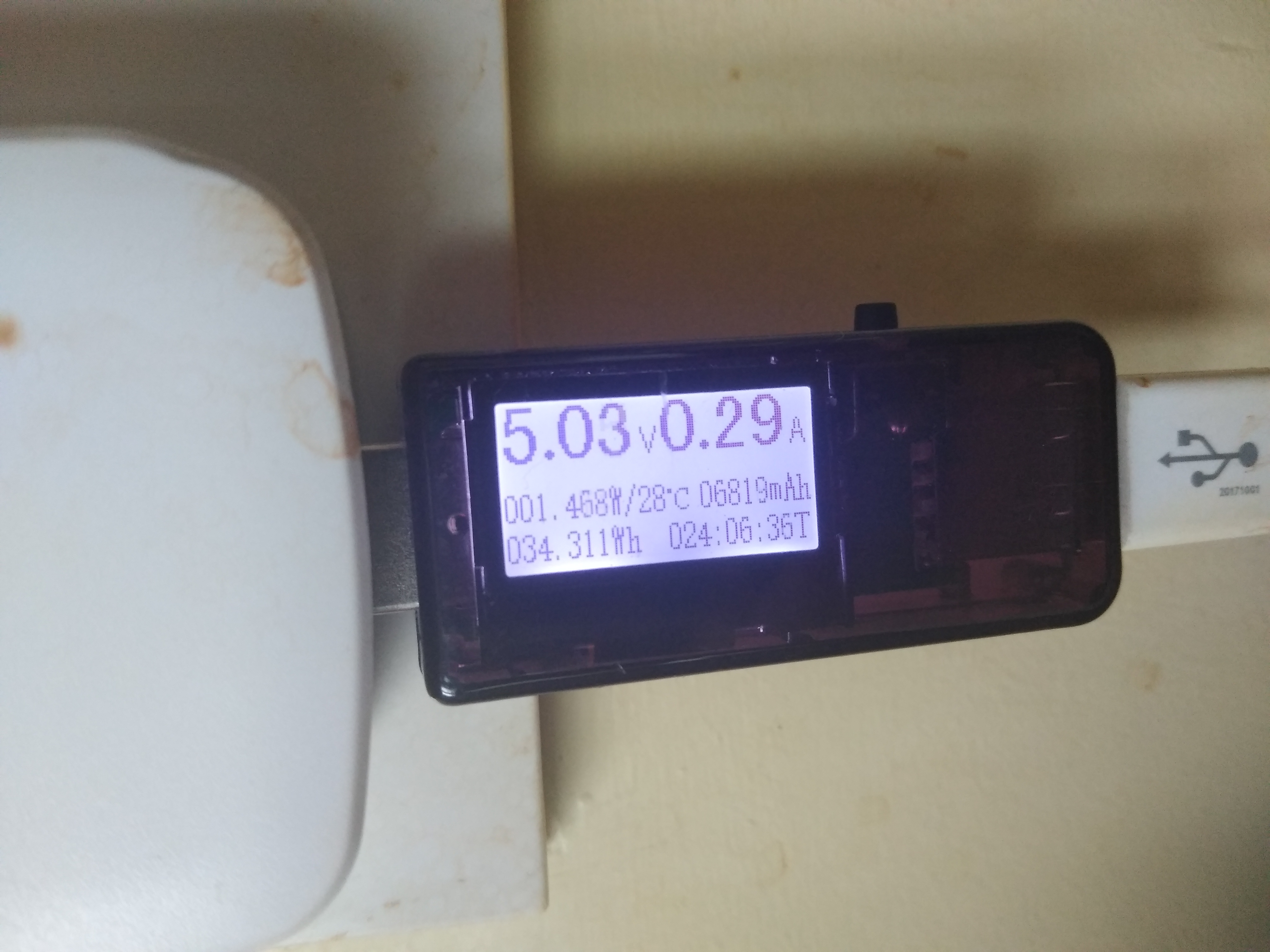

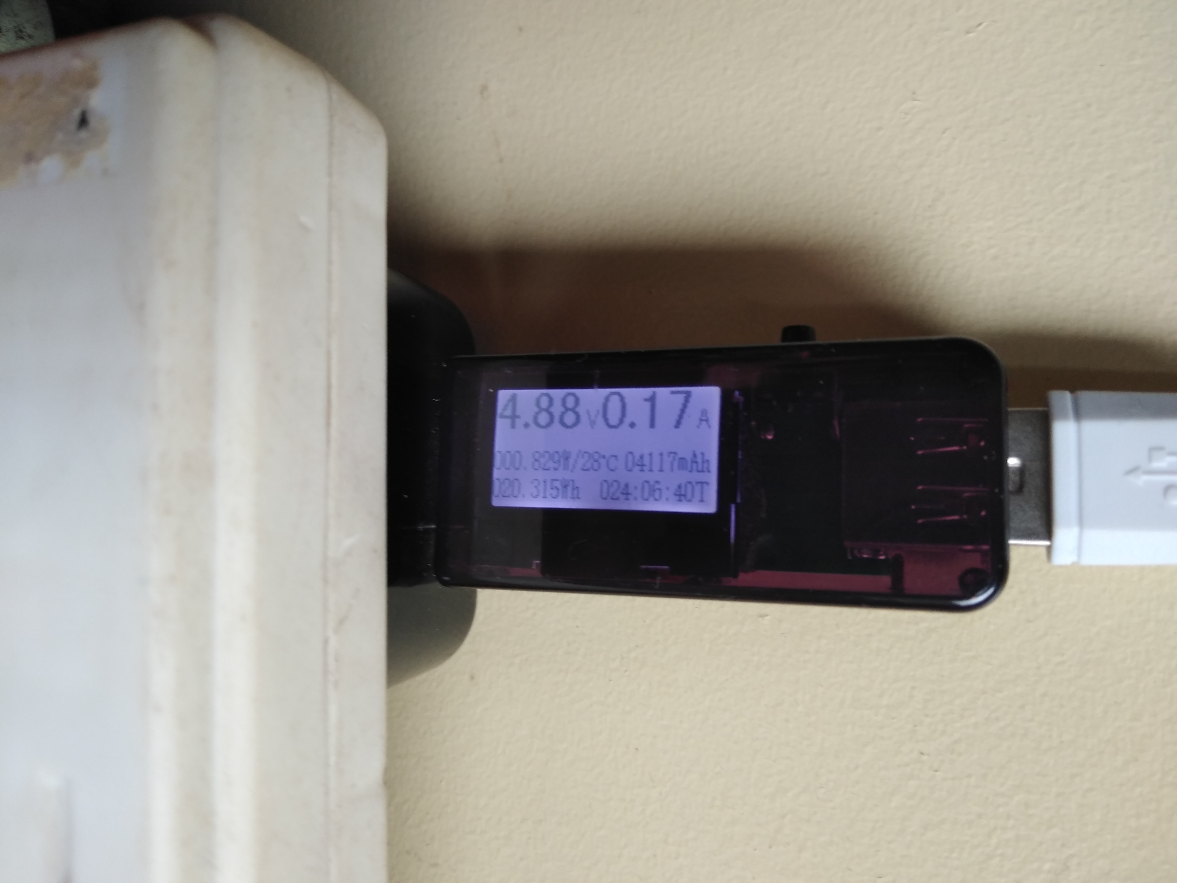

SteamyTea Posted February 10, 2023 Share Posted February 10, 2023 23 hours ago, SteamyTea said: Done. 13:00 09/02/2023 (ish) Part 2 Works out as 1.42W for an early RPi Zero W and the CC energy monitor. Going to pop it on the other RPi that is just logging one temperature and uploading it to the dark web via a small webserver. Link to comment Share on other sites More sharing options...
SteamyTea Posted February 11, 2023 Share Posted February 11, 2023 (edited) Update after another day of my life has vanished. 20.3 Wh in 24.1 hours, so 0.84W Edited February 11, 2023 by SteamyTea 1 Link to comment Share on other sites More sharing options...

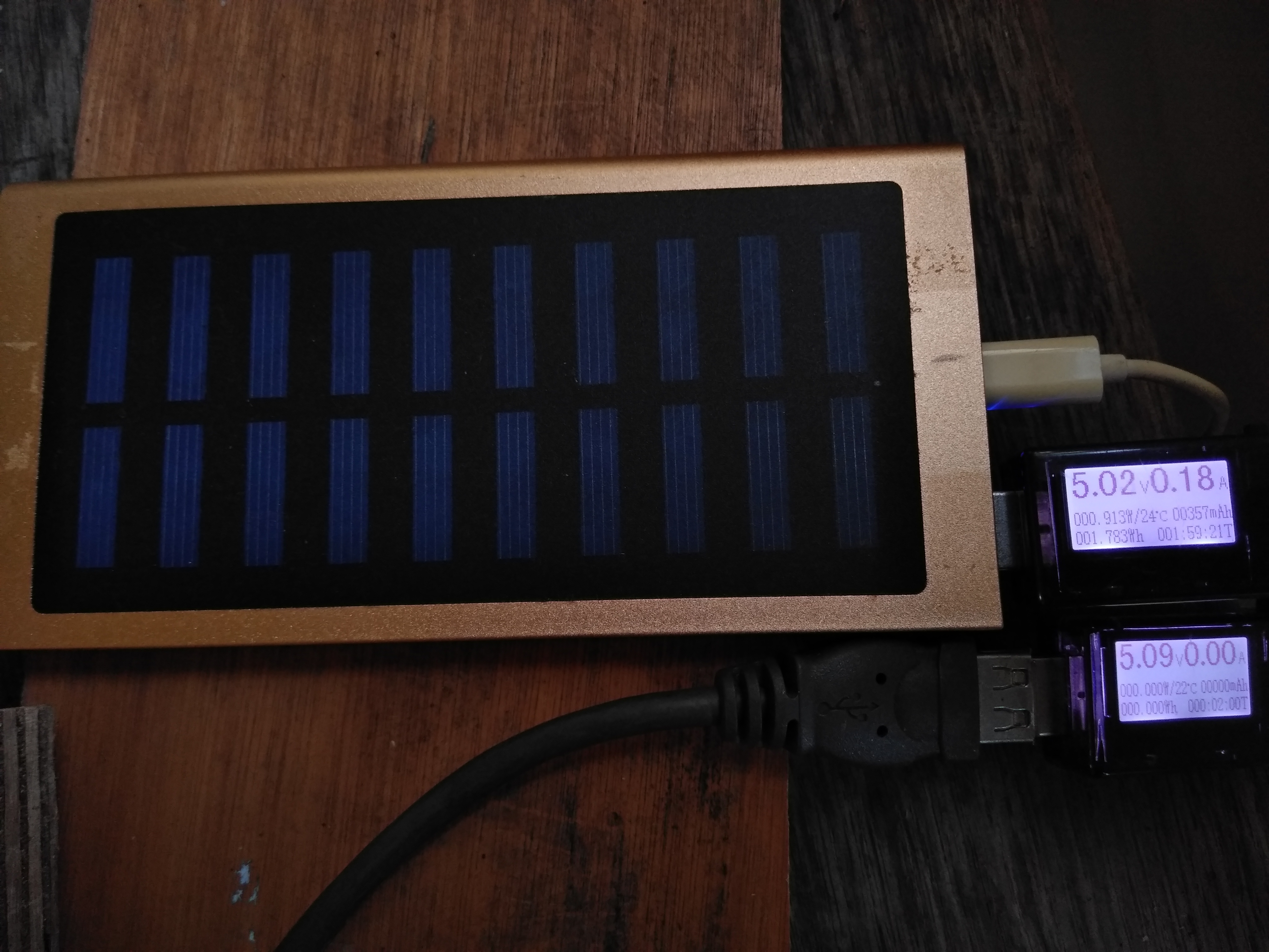

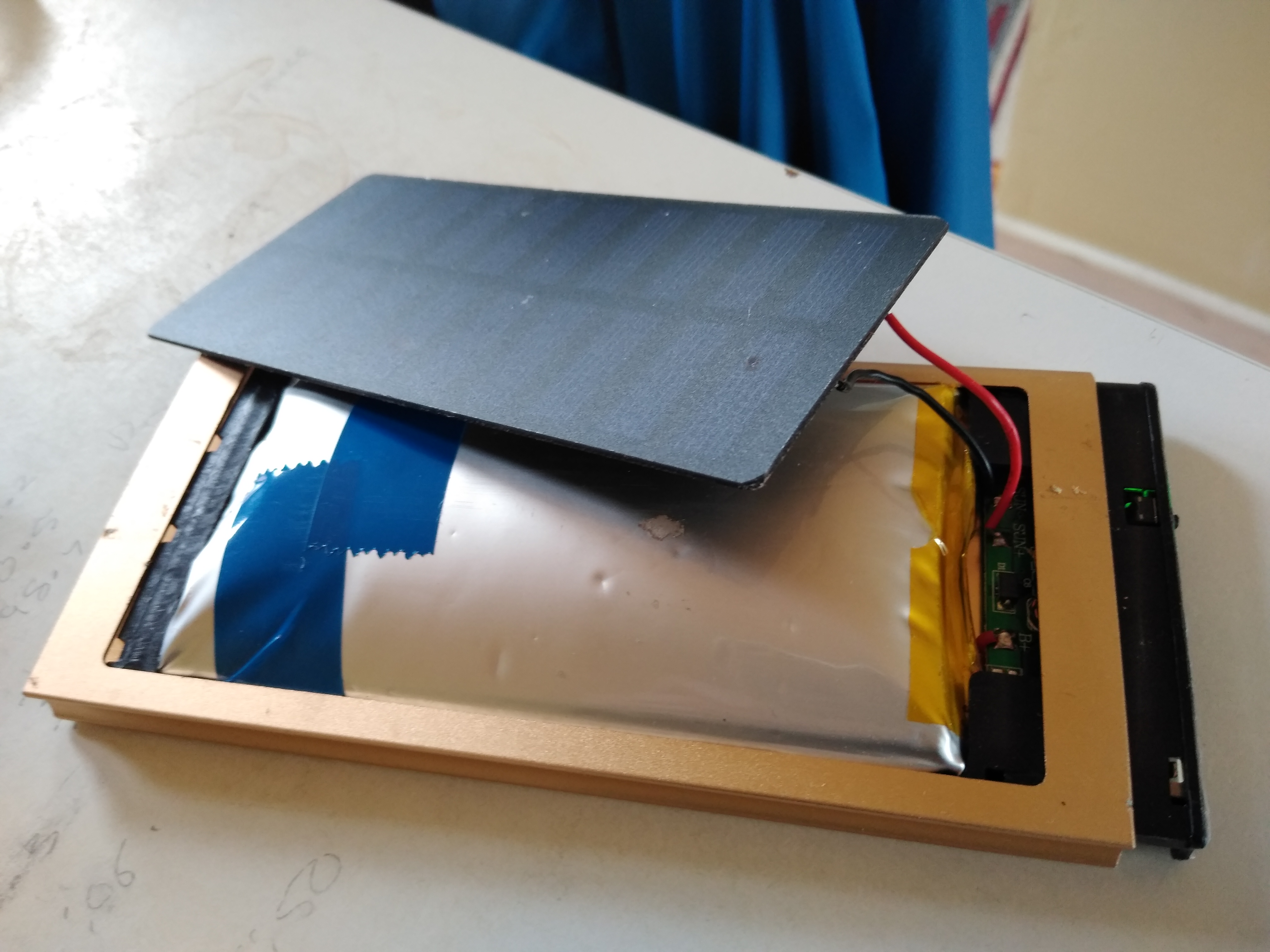

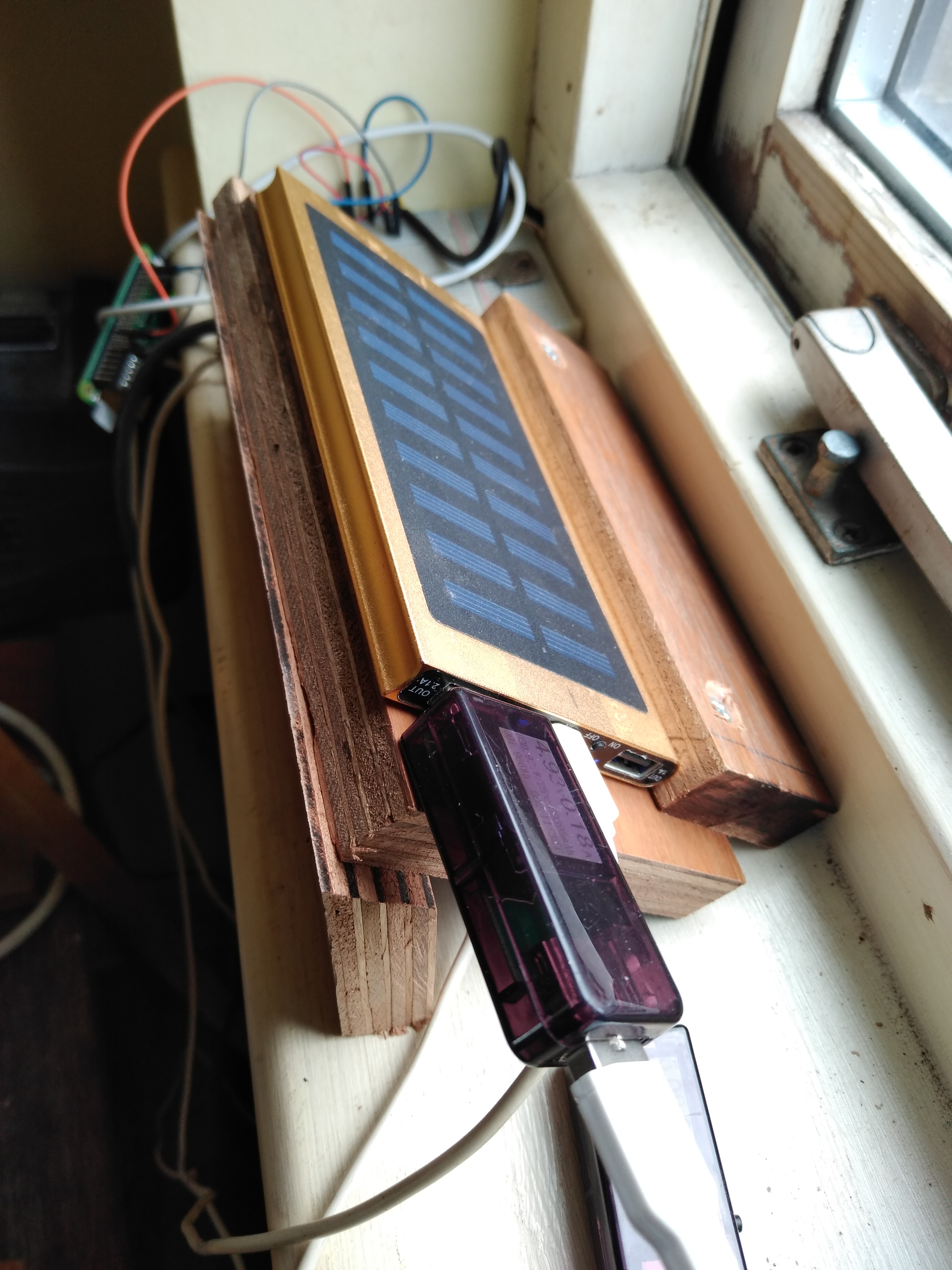

SteamyTea Posted February 15, 2023 Share Posted February 15, 2023 Finally got around to digging out my old solar power battery banks. This one seems shot. Not sure what to do with it. May set fire to it just to see what happens. The other one was ok. So fully charged it last night, it took 26 Wh. Then put it in the power line for my back garden temperature logger, popped a couple of energy loggers on it, and waiting to see how it goes. So far it has drawn nothing from the mains and almost 2 Wh from the battery/solar. Got it set up on a little stand on the back (NE facing) window cill. Shall see what the meters read tomorrow. 1 Link to comment Share on other sites More sharing options...
TerryE Posted February 15, 2023 Author Share Posted February 15, 2023 (edited) 2 hours ago, SteamyTea said: This one seems shot. Not sure what to do with it. May set fire to it just to see what happens. Shot is an understatement! It looks like it is about to pop! It needs junking / replacing. If you do recycle, then stick in an airtight plastic bag so that if it does pop then the lithium won't get exposed to air and spontaneously combust. Edited February 15, 2023 by TerryE 1 Link to comment Share on other sites More sharing options...
SteamyTea Posted February 15, 2023 Share Posted February 15, 2023 7 minutes ago, TerryE said: spontaneously combust. Combust is what I want to see. Shall look for a brick, some kindling, and set the camera up. Link to comment Share on other sites More sharing options...
SteamyTea Posted February 15, 2023 Share Posted February 15, 2023 Which bit will burn the best? Link to comment Share on other sites More sharing options...
SteamyTea Posted February 16, 2023 Share Posted February 16, 2023 (edited) 19 hours ago, SteamyTea said: Shall see what the meters read tomorrow. It died during the night, almost made it to midnight. Hopefully just a dodgy cable/connector. Shall look at it later. Edited February 16, 2023 by SteamyTea Link to comment Share on other sites More sharing options...

SteamyTea Posted February 19, 2023 Share Posted February 19, 2023 14 minutes ago, TerryE said: have now got my laptop-based ProxMox set up working stably. Just for a laugh, put an energy monitor in it and see what it uses. As an aside, I have found out why my cheap 'solar UPS' failed. It was an old, and very cheap, battery bank, so when it was left for a few hours, the voltage dropped too low to run the RPi, even when plugged into a 2A charger. Was still worth a go, and I know not to do it again. Link to comment Share on other sites More sharing options...
