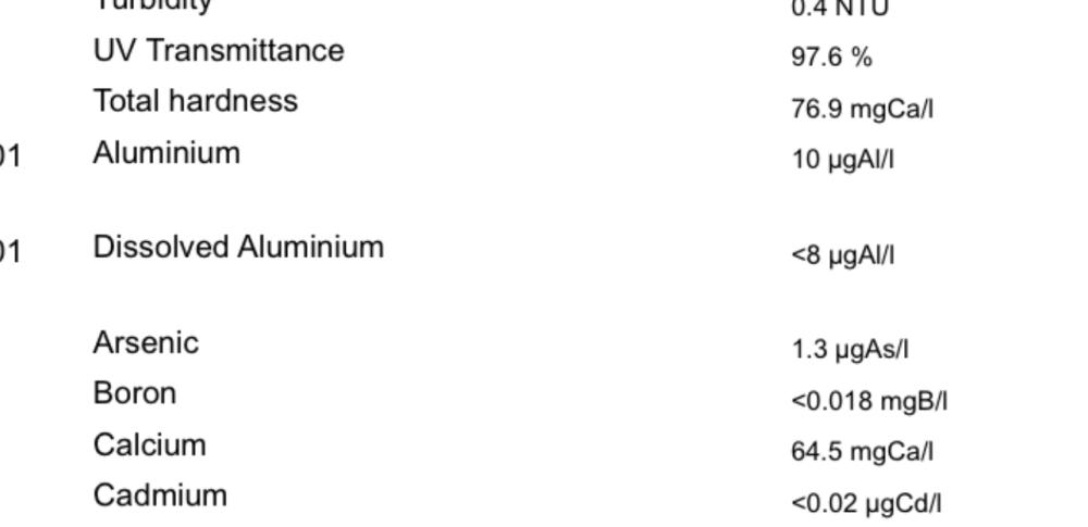

Kelvin Posted February 3, 2023 Posted February 3, 2023 (edited) Our water supply is going to come via a private water supply borehole. The water analysis says the water is moderately hard at 76.9 mgCa/l using a scale the first private water company provided me. I’m currently looking at the treatment plant requirements. I’ve had three companies provide designs and quotes. Two of them have said it definitely needs a water softener. The third has said the hardness level is below the minimum level where they’d recommend a softener. Therefore I need to decide whether to fit one or not. The cost isn’t too bad at £515 for the equipment. The slight complication is that the treatment plant is going to be in the detached garage so my plan would be to have two water supplies to the house one for the softened water that feeds the plumbing and a raw water supply to a single tap in the kitchen for drinking water. Clearly it’d be easier if I didn’t fit the softener. So the question is should I fit the water softener or not? I think I should but value other opinions. As an aside. I got three quotes as I said. The dearest quote was £23,000 ex VAT! from a well known Scottish private water company. They charged the farmer £18,000 to drill the hole (it’s deep at 147m) The other two were under £10,000 as a like for like comparison for the same treatment design and pump. Edited February 3, 2023 by Kelvin

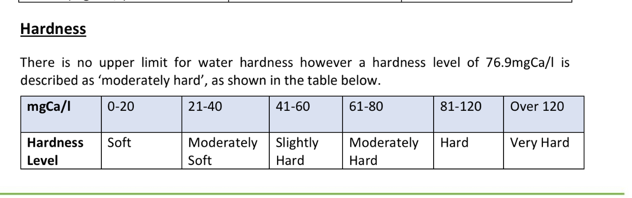

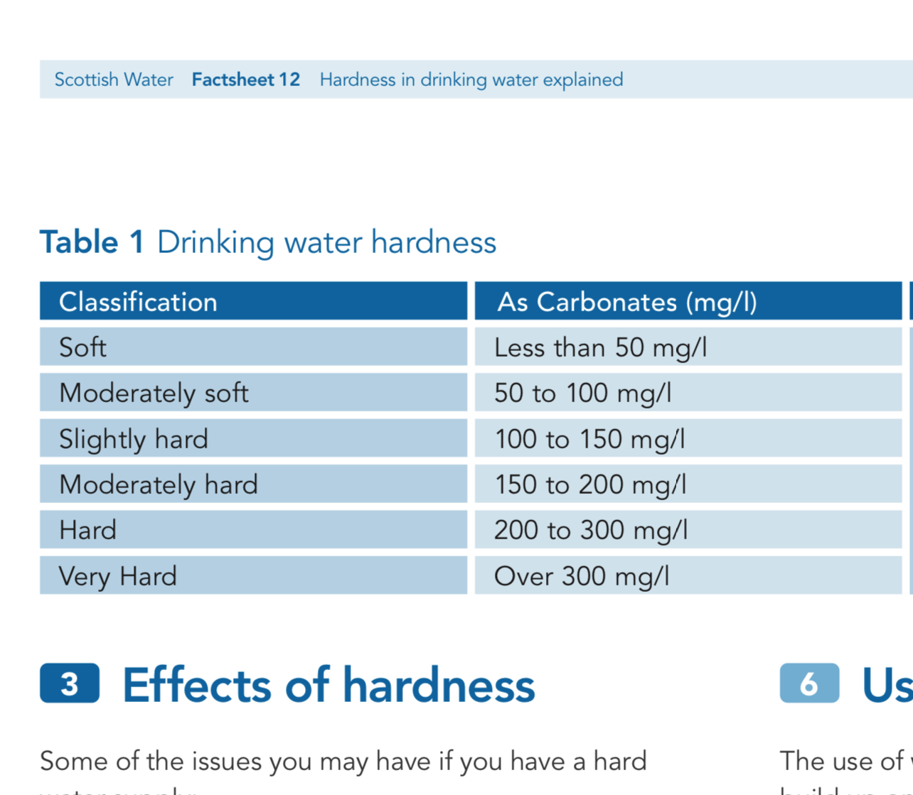

Kelvin Posted February 3, 2023 Author Posted February 3, 2023 What’s confused me is this. Scottish Water consider it moderately soft. It was the first water company that said it was moderately hard. They have a different scale below. https://www.scottishwater.co.uk/-/media/ScottishWater/Document-Hub/Factsheets-and-Leaflets/Factsheets/250221SW_FactSheet_12_2020V8webPages.pdf

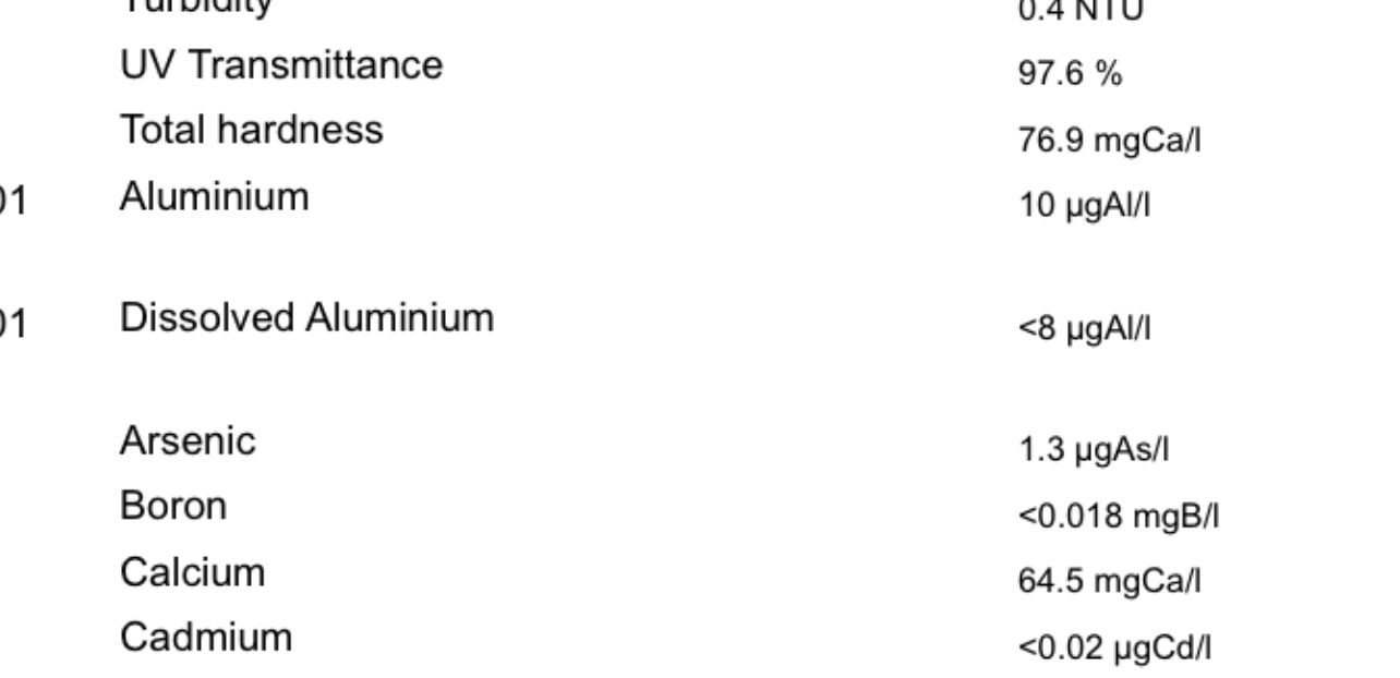

Gone West Posted February 4, 2023 Posted February 4, 2023 15 hours ago, Kelvin said: What’s confused me is this. Scottish Water consider it moderately soft. It was the first water company that said it was moderately hard. They have a different scale below. IIRC when we were in Kent and had a softener we looked at total hardness which was well over 300mg/l. The figure you have been given of 76.9 is for Calcium only. Total hardness consists of Calcium and Magnesium.
Kelvin Posted February 4, 2023 Author Posted February 4, 2023 6 minutes ago, Gone West said: IIRC when we were in Kent and had a softener we looked at total hardness which was well over 300mg/l. The figure you have been given of 76.9 is for Calcium only. Total hardness consists of Calcium and Magnesium. Nope it’s the total hardness number. Calcium number was lower
Gone West Posted February 4, 2023 Posted February 4, 2023 1 minute ago, Kelvin said: Nope it’s the total hardness number. Calcium number was lower I would question why you have two different values for mgCa/l. Total hardness is just mg/l.
Kelvin Posted February 4, 2023 Author Posted February 4, 2023 Was tested by Scottish Water at their Edinburgh lab which is UKAS accredited. Must just be the way they show it.
