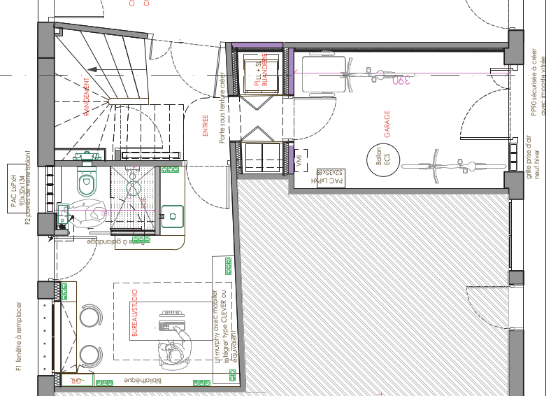

Garald Posted January 31, 2023 Author Posted January 31, 2023 (I'm still trying to figure out what the "thermodynamic" water heater would be feeding off. We will have PIV, so it wouldn't be feeding off the PIV. Ambient temperature in the garage - well, there's no reason to have a warm garage, but wouldn't the garage eventually become so cold that the water heater would become inefficient, unless it is drawing heat from the rest of the house - which it will do, but really slowly (since we are insulating, obviously) so that the garage would become colder until the temperature difference with the house is large enough that it is sucking heat from the house rapidly enough? In the end, the architect's original drawing made more sense, in that there would have been a flow of air from the outside, and so the garage would never have got colder than the outside world. 700W is not so little: it's like a fairly large negative radiator. I wonder why anybody would ever have one of these devices running in a heated room. Also, is the installer's legit about noises in summer legit? You'd think the heat-pump would then be extremely efficient, and, being a contemporary heat pump, would modulate down far enough that it would be very quiet. Or am I too much of an optimist?)

Garald Posted January 31, 2023 Author Posted January 31, 2023 What I am getting is that, if V0 is the outside temperature and V1 is the inside temperature, and V0 + c (V1-V0) is what the temperature of the garage would be without the fancy water heater, then, once you install the water heater, a proportion c of the heat extracted by the fancy water heater from the garage is being sucked from the house. That is: if it would be 10 C in the garage when it's 0 C outside and 20 C indoors, then half of the heat "gained" by the water heater is being stolen from the house; if it would be 15 C in the garage when it's 0 C outside and 20 C indoors, then three-fourths is being stolen from the house; if it would be 5 C in the garage when it's 0 C outside and 20 C, then only one-fourth would be stolen from the house - but then it will certainly be colder than 5 C in the garage once you install the fancy water heater, meaning it will most likely stop working in fancy mode, and it will just become an old-fashioned electric water heater. Yes, I'm using the letter V for temperature because I drew an electric diagram :).

saveasteading Posted January 31, 2023 Posted January 31, 2023 11 hours ago, Garald said: wouldn't the garage eventually become so cold that the water heater would become inefficient, Not "eventually" but very quickly. The air flow is high and the garage would very soon become cold (or hot) from chucking out the waste warm, (or cold), air. It would soon be very inefficient. The installers should know this and i would be concerned if they suggested or agreed to do this.
Garald Posted January 31, 2023 Author Posted January 31, 2023 21 minutes ago, saveasteading said: The installers should know this and i would be concerned if they suggested or agreed to do this. Right, exactly. In defense of the second installer (who suggested this), the current garage door is a conventional metal garage door with holes in it, and he saw that; however, I explained that it would be replaced by a solid wooden door. I wish the first installer could at least agree that we are right, instead of offering "we will do it for 1000 eur more"! 23 minutes ago, saveasteading said: Not "eventually" but very quickly. I meant "eventually" in the sense of "let us assume we have reached a stable state..." (i.e., I was being agnostic as to whether it would take a second or a day).
