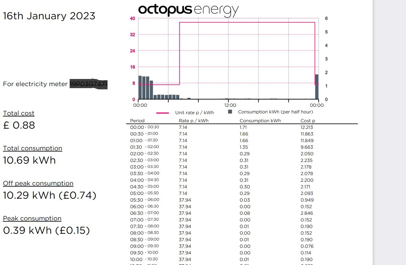

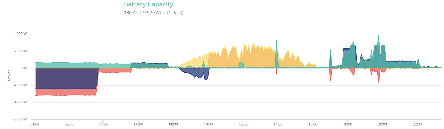

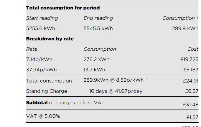

Simon R Posted February 6, 2023 Posted February 6, 2023 Hi, I'm running a GivEnergy system 3.6kW inverter + PV with their 9.5kWh battery storage with Octopus intelligent tariff. Our house is heated/cooled with small 3.5kW Midea a2a unit. Our practical experience is that we use very little peak rate electricity. In winter we run the a2a unit to heat overnight 23:00 to 05:30 and then as we need it depending on solar gain, it's unusual to draw from the grid during the day. In summer we use the a2a to keep the house down to 22c and it's always running on solar, so again no peak rate. I also have an EV which I'm setting up to charge automatically when the battery store reaches 90% (and PVs are inputting) and stop when the battery is depleted to 40%. By doing this I should be able to reduce my export to a minimum.

Simon R Posted February 6, 2023 Posted February 6, 2023 23 minutes ago, DragonQ said: Is that the Gen2 3.6kW hybrid inverter? It's a gen 1 hybrid and our daily average is in the 12kWh region, which includes our EV charging. Our MVHR and other odds and ends result in around 400w background usage. With a 4kW PV array we are exporting even at this time of year, so if the suns shining the washing machine and dish washer get used during the day. Our battery was full by 10am today, so a lot of your peak usage 11.5kWh will come directly from PV. Dark blue is battery charging, green is load, yellow solar and red grid.
Simon R Posted February 6, 2023 Posted February 6, 2023 I should have mentioned that Octopus are offering a home package with inverter +PV + battery. I don't know the price, but from my dealings with them I expect it will be good.
Simon R Posted February 6, 2023 Posted February 6, 2023 56 minutes ago, Simon R said: our daily average is in the 12kWh region That's out grid consumption, actual is 19-21kWh, the balance coming from solar.
SteamyTea Posted February 6, 2023 Posted February 6, 2023 1 hour ago, Simon R said: It's a gen 1 hybrid and our daily average is in the 12kWh region, which includes our EV charging Do you know the sampling rate? From the charts it looks reasonably fine.
